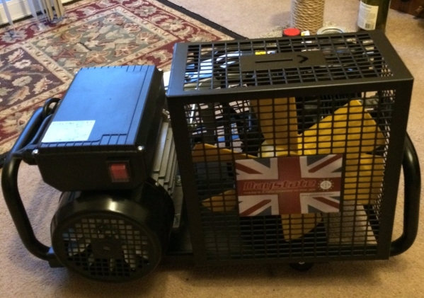

Wow Wow WOW ... I did it now! Just got a new Daystate LC110 compressor.
Simple set-up, easy to move around, 110-volt, 3 stage, topped off my 88cu ft, Luxfer tank in 20 mins (3000 to 4600psi). Came with a 330 bar blow-off adaptor, installed.
Very well built. The fit & finish is awesome!
I'm stoked! ​

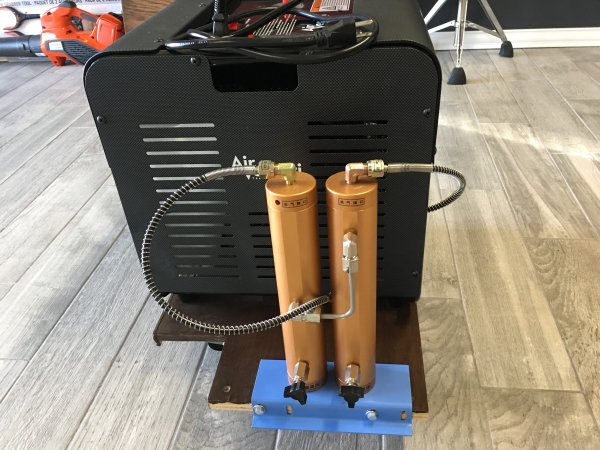

You should add a high pressure filter. The least expensive way is to order one from Aliexpress.com. Here is a link:
https://www.aliexpress.com/item/water-oil-separator-absord-moisture-absord-water-for-dry-and-clean-high-pressure-air/32827947479.html?spm=a2g0s.8937460.0.0.FaZVwFYou can cut the tampon that comes with the filter into 1” sections and use them as end caps. Fill the space with zeolite 13x desiccant. You can buy it on ebay.
Here’s the link:https://www.ebay.com/itm/3-lbs-Molecular-Zeolite-Beads-Type-13X/312090493908?epid=862892059&hash=item48aa0b03d4:g:w4gAAOSwo6lWFpeYThis zeolite can be recharged in a flat pan in an oven at 400 degrees for an hour and reused many times. This will last you a lifetime. The filter only needs to be
recharged about every 10 hours of compressor run time. The gold filter from Aliexpress takes about 2 weeks from ordering to arrival. For an investment of $85, you can save a bunch. The gold filter is identical to the Diablo filter that AofA sells for $189. It has less bells and whistles but does the same filtration as the $400 alpha filter.Your compressor water tower bleeds off most of the moisture but a final filter catches the last 1%. Don’t worry about filling your tank once or twice before you add the filter. The water separator does most of the work but this is the last bit of insurance. That is a great compressor for the money.

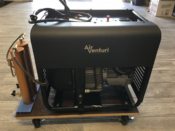

"anqgiap"I bought this for the AV off eBay, it was 200 bucks now it went up a bit more - double filtration, advertised for breathable air, not sure about all that but sure enough for airguns. Work great so far. I made a little platform with casters to have them all in one place and ease to move around.
https://www.ebay.com/itm/30Mpa-Air-Filter-2-Water-Oil-Separator-Double-Bucket-Filtration-for-Scuba-Diving-/263396760404?hash=item3d53ab9b54
Thanks for sharing. I snagged the filter and desiccant that Humdinger suggested.
I'd like to see the set-up that you came up with... sounds cool!
