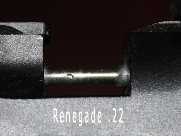

The old style magazine indexing lever strikes the pellet probe. The problem is worse on some guns than on others, but it isn't restricted to just HP models. The picture below is of my Renegade .22 pellet probe (non HP model). I also own a Pulsar HP and on that gun the damage is less extreme, but the probe still has a groove cut in it. On both guns it definitely affected accuracy and caused frequent breech seal failures and broken indexing pins. The new magazines do not strike the probe but you also lose the non-double load feature.
