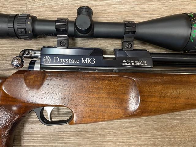

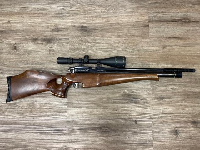

Never fooled with a CDT, but W/O the LCD display it becomes a switch on with trigger squeezed, count BEEP tones to select the level wanted in the programming & again trigger pulls in selecting specifics. Turn off and settings get saved.Just saw this thread. I was searching the net about this gun as I just found and purchased this relic today! I have owned most of the Daystate electronic guns but never seen a MK3. Can't wait to test it out this weekend. Scott does this work like the Air Wold CDT system? Looks like a fairly early model # 256
View attachment 409169View attachment 409170
