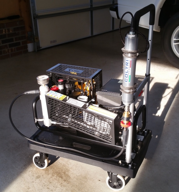

After growing weary of bending over and manhandling my compressor around to a different spot when using it, I was looking for a solution. I was planning to buy supplies and build a caster platform but then I remembered the foldable cart my wife uses when we move huge, heavy boxes that we load and ship to the PI. So I confiscated it for permanent duty.
Magna Cart Folding Platform Truck
Clever design, folds out and 300lb capacity, 16"x26" platform. The handle slides up, locks into position and doubles as a holder for second filter.
That second filter is listed by AoA as an Omega Cleanair inline filter but I think it's actually a Coltri filter that's been modified with foster fittings. It's branded as Coltri and comes with a Coltri cartridge filter (#SC000340), the same filter the Daystate T2 (220v) uses in the last filter cylinder. You can also use this cartridge from Lawrence factor:

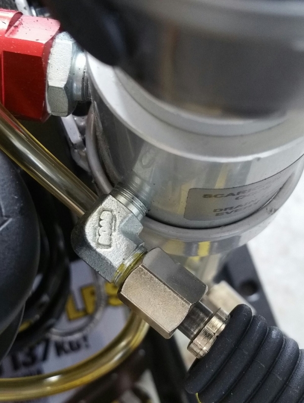

Now if I could just figure out what type fitting this outlet uses, I could rotate the compressor 180, ditch the long hose with the din300 and run a shorter hose with a female QC directly to that second filter.
So for the daystate or similar size compressor, not a bad solution. I just roll it near an outlet, scotch the wheel while in use, then move it back to a convenient spot for storage when finished. And for those wondering, yes I did buy the wife a new magna cart as a replacement.

Gadballs, the daystate comes setup like that, din300 on the tank end of the hose. My plan is to add a short hose from compressor to filter but I'm not sure what type fitting that outlet connector to the hose is. All I really need is maybe a 1 ft line from compressor outlet to a female QC for the second filter.

Below is what you are looking for if you want to use the hose with DIN connector that came with the Daystate Compressor. It will give you a male Foster QD on the end instead of the male DIN. Or you could do a female foster QD is that's what you prefer.
https://www.bestfittings.co.uk/shop/fill-probes-adaptors/300-bar-din-female-18-bsp-male/
https://www.bestfittings.co.uk/shop/quick-coupler-kits-and-parts/best-fittings-qc03-quick-coupler-plug/
