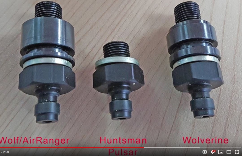

JFYI, the 2 piece fill assembly uses a couple of 1/8" BSP bonded seal washers, also called dowdy seals.

what is excat size of this o-ring for Pulsar hp?
thanks
