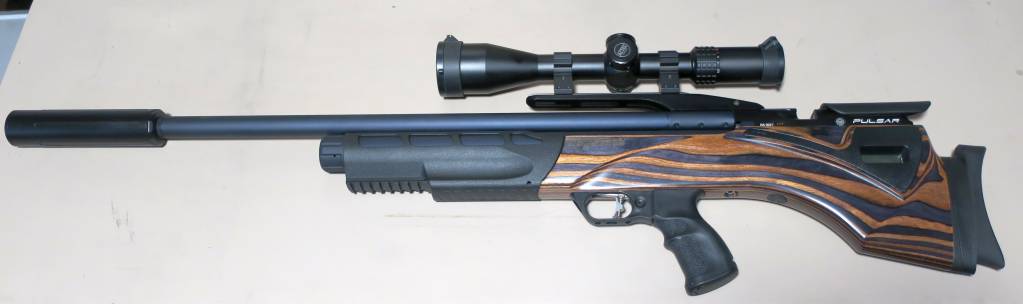

Just received my Daystate Pulsar HP .177 today.
I have been fascinated by the Redwolf but prefer a bullpup. Electronic controls seem to me to be the next step in PCP evolution and I really wanted to try one of Daystate’s electronically controlled airguns. Finally bit the bullet and bought the Pulsar. My initial concerns with the Pulsar was it’s looks and it’s advertised weight. The looks kind of grew on me (still not the best looking bullpup). The weight hasn’t been an issue in the various posts/reviews that I could find and most folks said the balance in hand was great.
Initial impressions are that it looks a lot better in person (still not the best looking bullpup). Balance of weight is good. Best butt stock adjustability of any airgun that I have experienced. Love the light cocking action. Best trigger out of the box that I have experienced. Like the ability to charge reservoir without a probe. Not fond of the electronics time out.

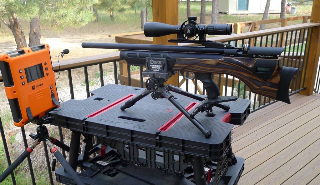

Been following Steve’s Instagram posts on his Redwolf HP .177 review and decided to break out my Labradar and test my, out of the box, Pulsar with the pellet and slugs I have on hand. I have attached the Word document that summarizes the Labradar data. Interesting note is the slugs don’t lose as much velocity as pellets over 25 yards. I knew slugs were better at retaining velocity (better BC) but the numbers still surprised me.
The next step is to fit the stock to me, sight in the scope and test pellets to determine the best pellets for the various power settings.

Thank you or for all the comments! As I play with the Pulsar more I have to admit there is a functional beauty to this bullpup. I am getting to like the blend of black and wood.

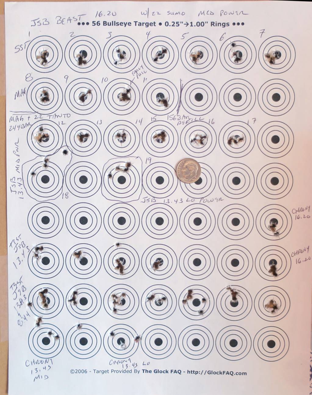

Well, don't even bother with any light or medium weight pellets. I finally got to spend some quality time with my new Pulsar HP and was really disappointed at the beginning - until I got to know the gun a little better and switched to JSB Beast 16.20 Diabolos.
After shooting groups I did some basic chrono work with my FX chronny:
16.20's: 10 shots, AVG 821, Hi 830, Lo 807, Spread 23, SD 7.5 (Pulsar on Mid power)
And now I know why I couldn't group with the lighter pellets:
13.43's: 5 shots, AVG 1108, Hi 1111, Lo 1104, Spread 7, SD 3.0 (Pulsar on Mid power)
13.43's: 5 shots, AVG 999, Hi 1002, Lo 997, Spread 5, SD 2.3 (Pulsar on Lo power)
I have also found the Pulsar HP to be less forgiving to a new shooter with little/no/poor technique. I found that I really, really had to do my part to get a good group, and still had too many 5th shots which messed up a pretty good one. There was only 1 shot which went awry which I couldn't attribute to my own error. I found that you really needed to use isometrics and pull the butt tight into my shoulder to get decent follow-through and adequate groups.
At first, when shooting the lighter pellets, I thought that I had another 'problem' Daystate magazine (my CARM mags are still in the mail). But after switching to the 16.20 pellets and getting more familiar with the gun using the SST, I switched over to the mag and it was just as accurate for me.

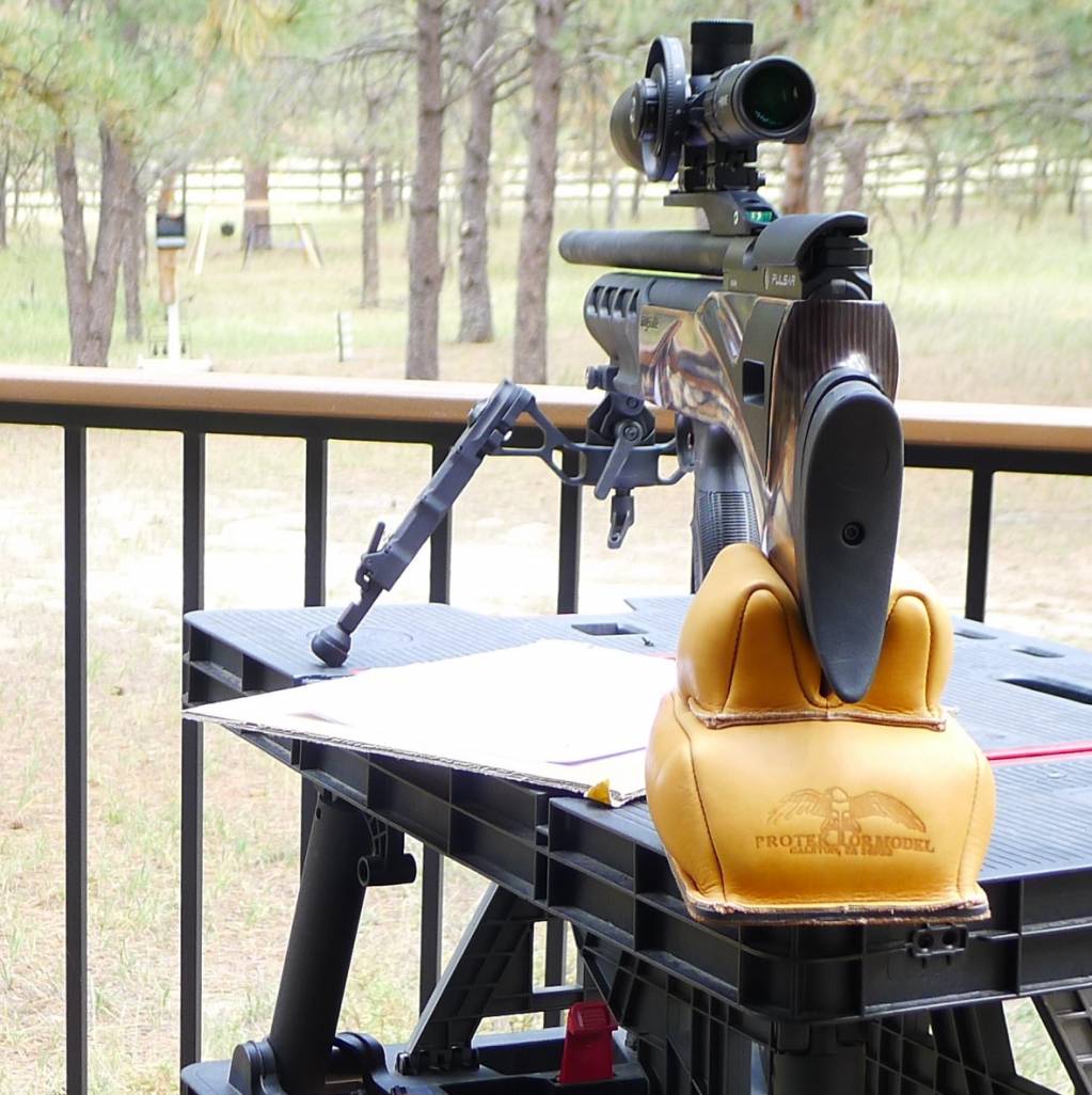

All I could test today was the JSB Monster 13.43gr pellets today after getting the scope set up. The target was at 30 yards with 5 pellets per group. Light to no wind. I tested a string of 5 pellets with the FX chrony. Power at Med - Average 891fps, High 893fps, Low 886fps, ES 7, SD 2.7. After chrony test I removed chrony from barrel so that it didn't affect barrel/shroud harmonics for accuracy test. The circled 3 targets are the best of the day. The target squares are 1" by 1". It took a long time, a lot of pellets and more targets for me to get a feel on how to hold the Pulsar on the bench. As mentioned by other folks, I can attest that the Pulsar is hold sensitive. I found that on the bench with a bipod and rear bag I had to have a strong grip on the pistol grip and medium to heavy pressure against my shoulder. Full disclosure, I'm generally a 2 MOA shooter and you can see that in the other groups. The circled 5 shot groups are the best I have ever shot. This Pulsar is definitely more accurate than I am. Not going to bother with High power for this pellet. Will try JSB Monster 16.2 gr pellets and NSA slugs tomorrow.

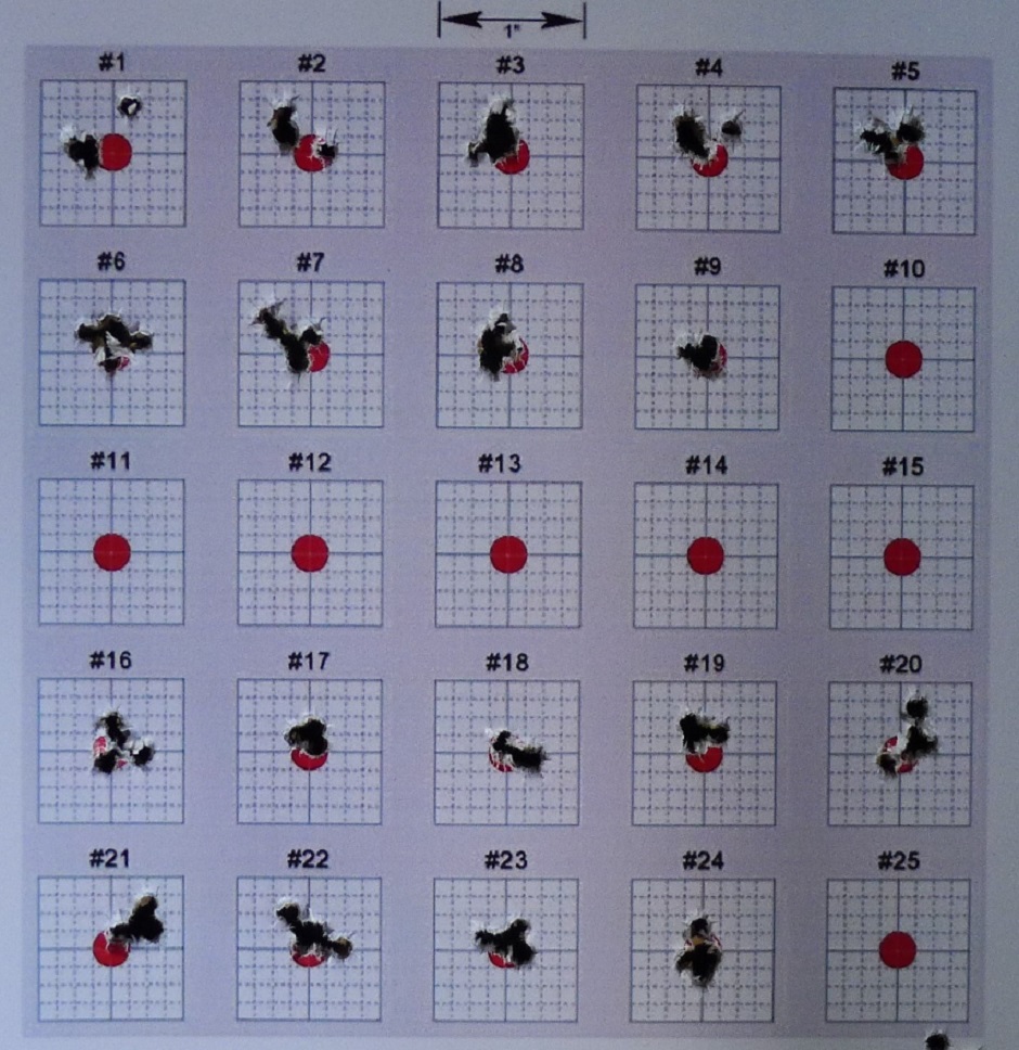

Tested JSB Monster 16.2 gr pellets today. At Med power FX chrony indicated an average of 837 fps, high of 840 fps, low of 830 fps, ES of 10 fps and SD of 2.6. At High power an average of 917 fps, high of 923 fps, low of 902 fps, ES of 21 fps and SD of 5.6. Shot 10 pellet groups at each power to get this data then removed chrony for accuracy testing. I am happy with velocity at both Med and High with this pellet. Picture of target and setup below. Target at 30 yards.
Targets #1 - #9 are at Med power setting and #16 - #24 are at High power setting. Will test NSA 12.5 gr and 15.5 gr slugs in the next few days.
I did notice that the grip on pistol grip is more critical than pressure into shoulder. I varied shoulder pressure while maintaining a firm grip on pistol grip and didn't notice a change in POI. Not sure shoulder pressure matters from bench but I did see that it matters from a free standing position.
