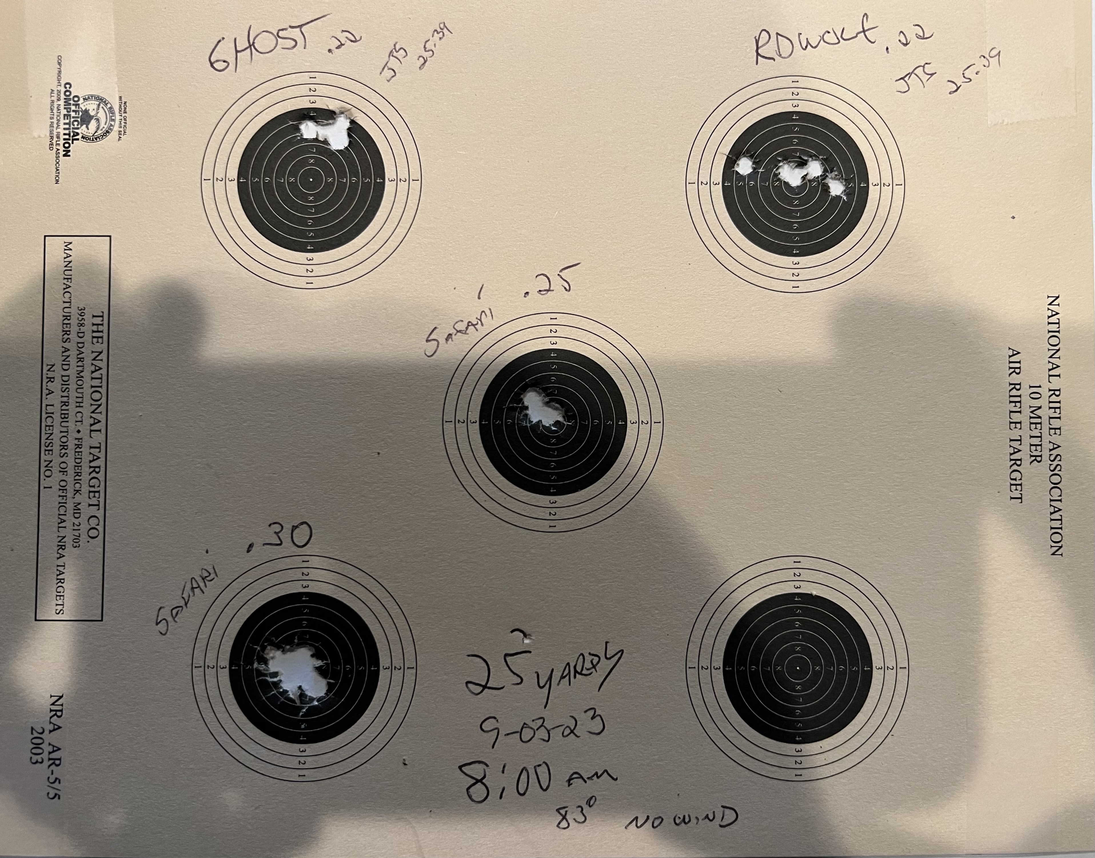

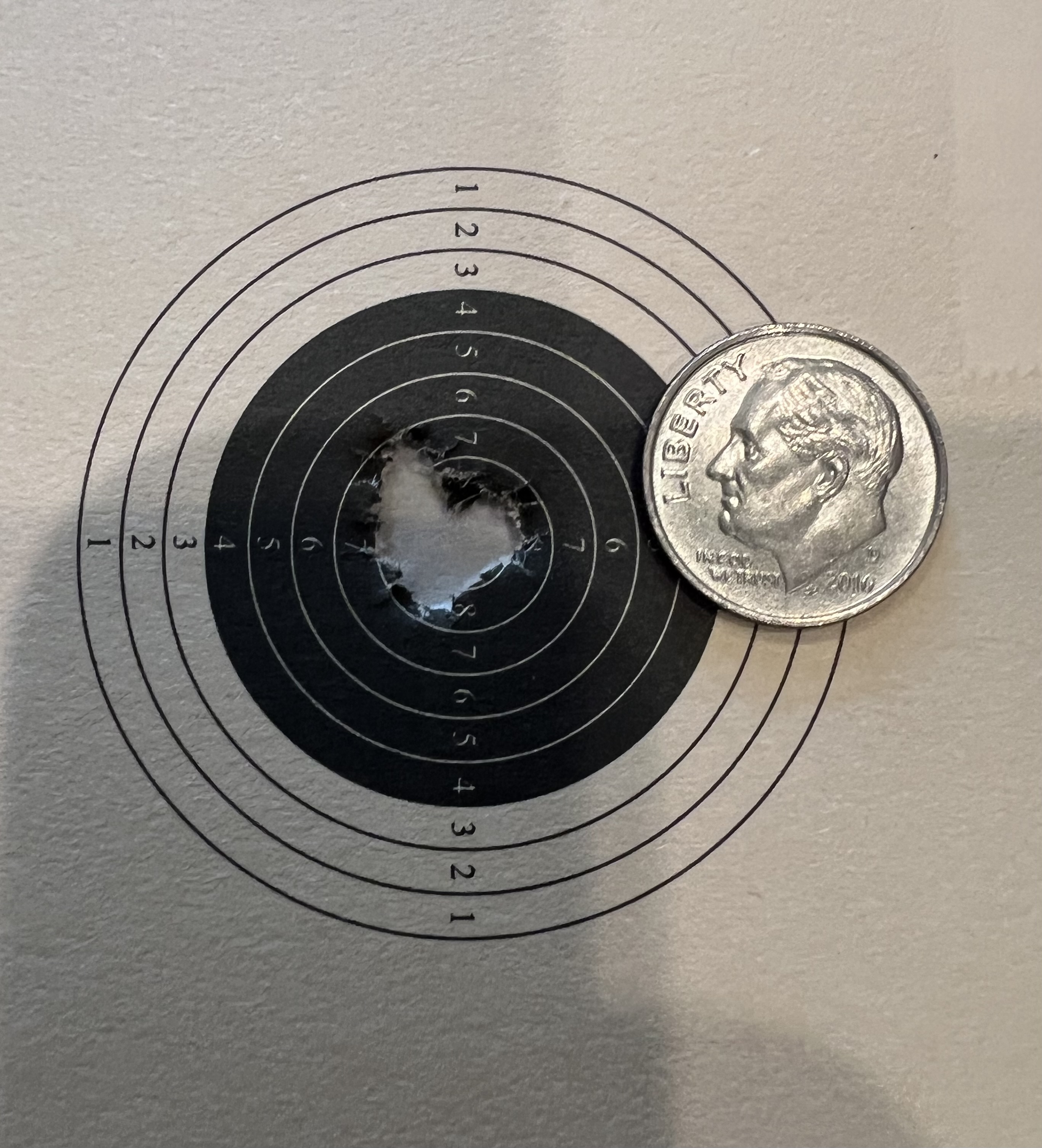

Has Shane at AoA looked at it? I had similar accuracy issues with my Red Wolf .22 HP. Dropped it off early Dec got it back 10 days ago. He said the barrel needed polishing. He had it shooting JSB 25.39 1/2" groups at 50 yds. I have several targets. My Red Wolf likes to be cleaned often, likes JTS Pellets as well, I think it is because they are a little bigger. Right now it likes 18.1 on low, 21.53 still determining low or medium same with 22.07. I have 3 new JTS pellets coming to try out as well. So far it’s back to shooting like it should.
