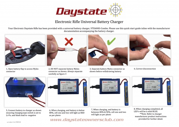

my battery charger that came with gun has a port on the side with 4 pins. My battery has 3 pins. you can slide all way to left and hook it up or all the way to right to hook it up. What is correct? Use the first 3 pins or last 3 pins?

I have the same doubt about wich was the correct setup for charging, searching on internet found that saids that the black cable on your battery connector must match the negative pin on the universal charger. That's the correct way. Hope it helps
The image credit is for Simon Cockayne who posted on daystateownersclub forum web page.
I don't think left gets you both cells charged. Both lights are on when you plug it to the right side. I have charged mine 3 times now and always from the right with both cells showing being charged. My first charge I used the gun till the display said low battery. That went away after charging to the right. There is a you tube video of some Brits complaining about the charger and how you can only charge one cell if you plug the battery into the wrong side. I wish there was more instruction on the charger, even a simple letter drafted up by Daystate telling you some simple steps would have been better than nothing.
"Left" with the charger supplied with my rifle, definitely charges both cells. I have put over 7,000 pellets through the rifle since receiving it in May. If the battery was not charging both cells, certainly one cell would be discharged by now. Next time I charge the battery, I will check both cell voltages with a volt meter.
