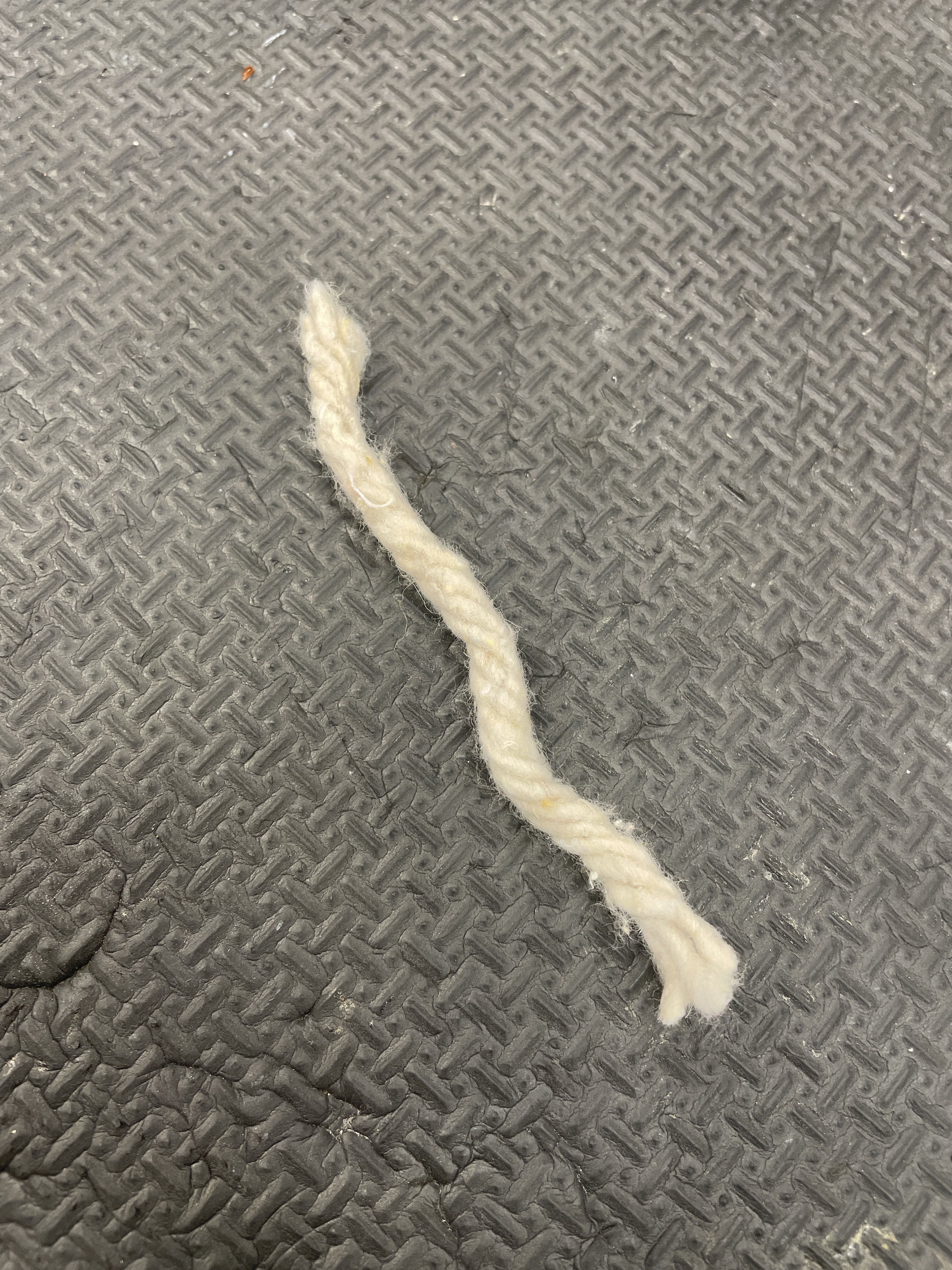

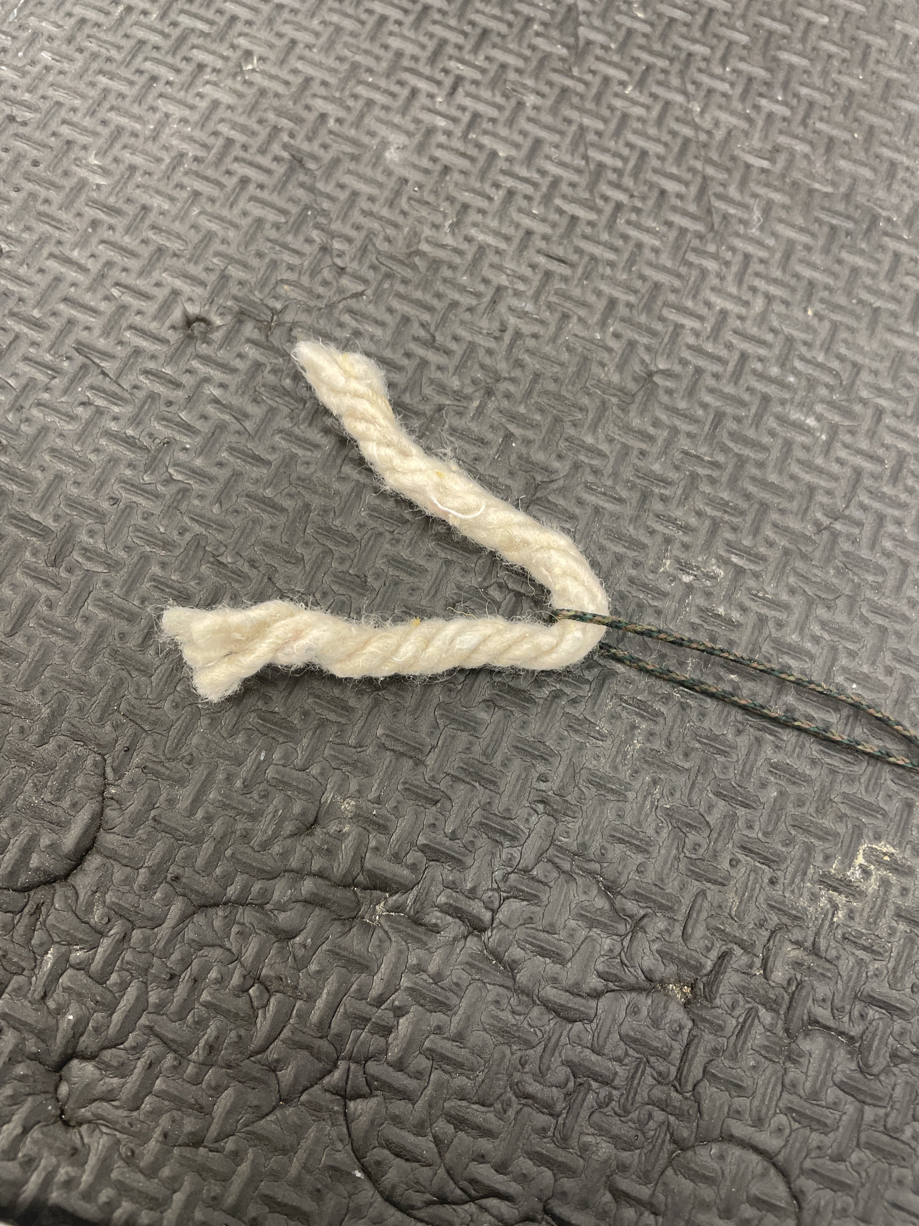

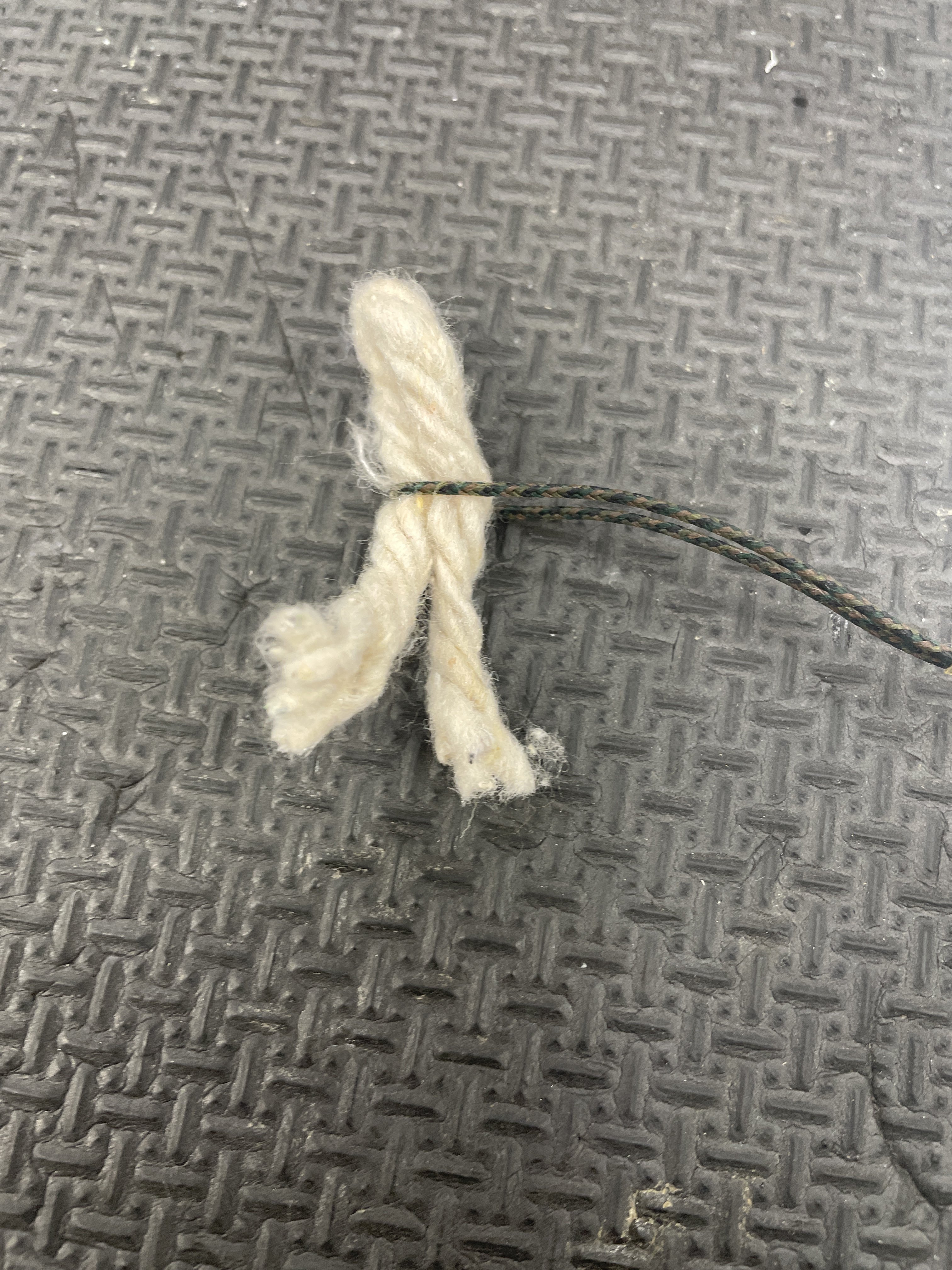

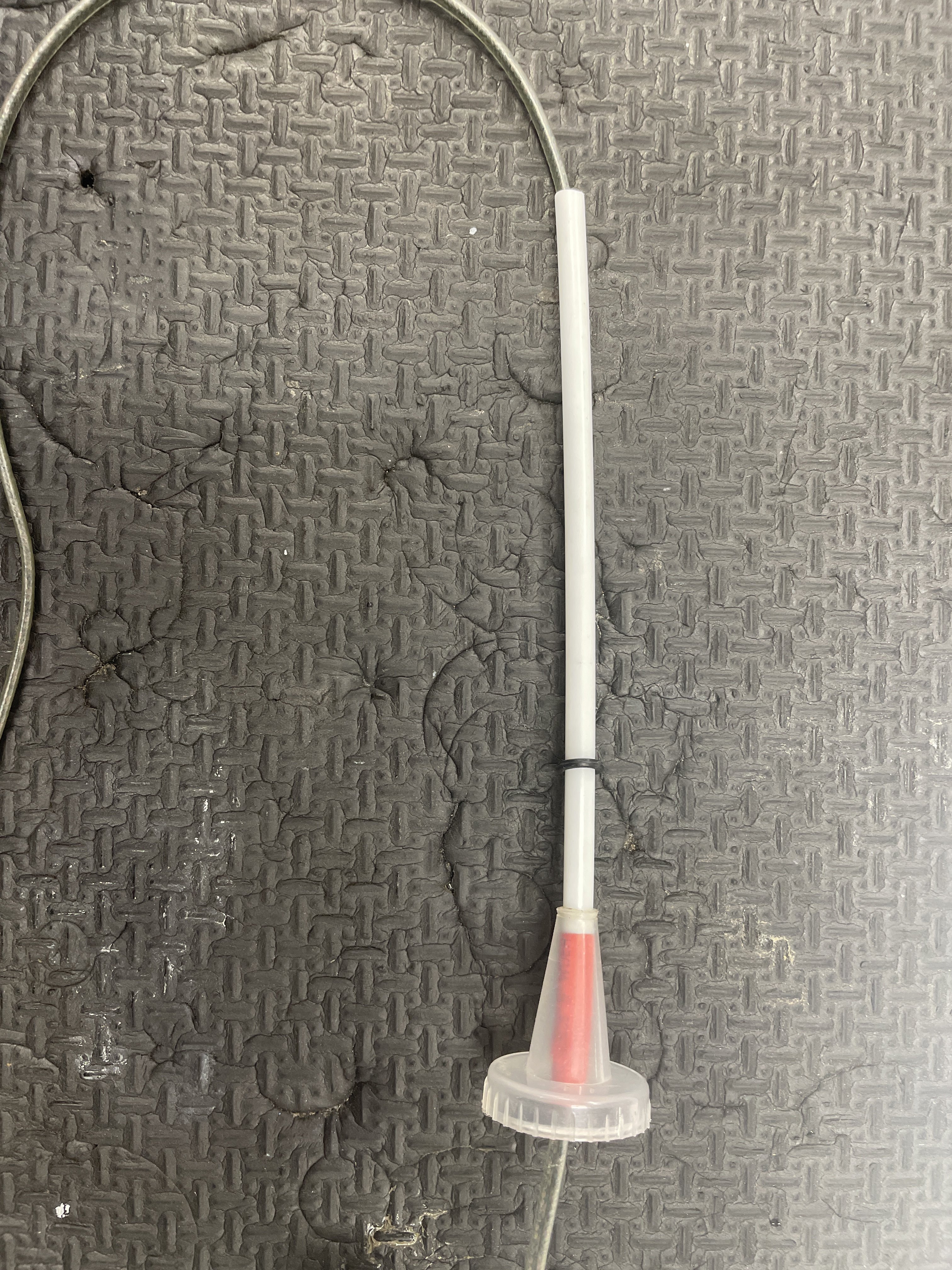

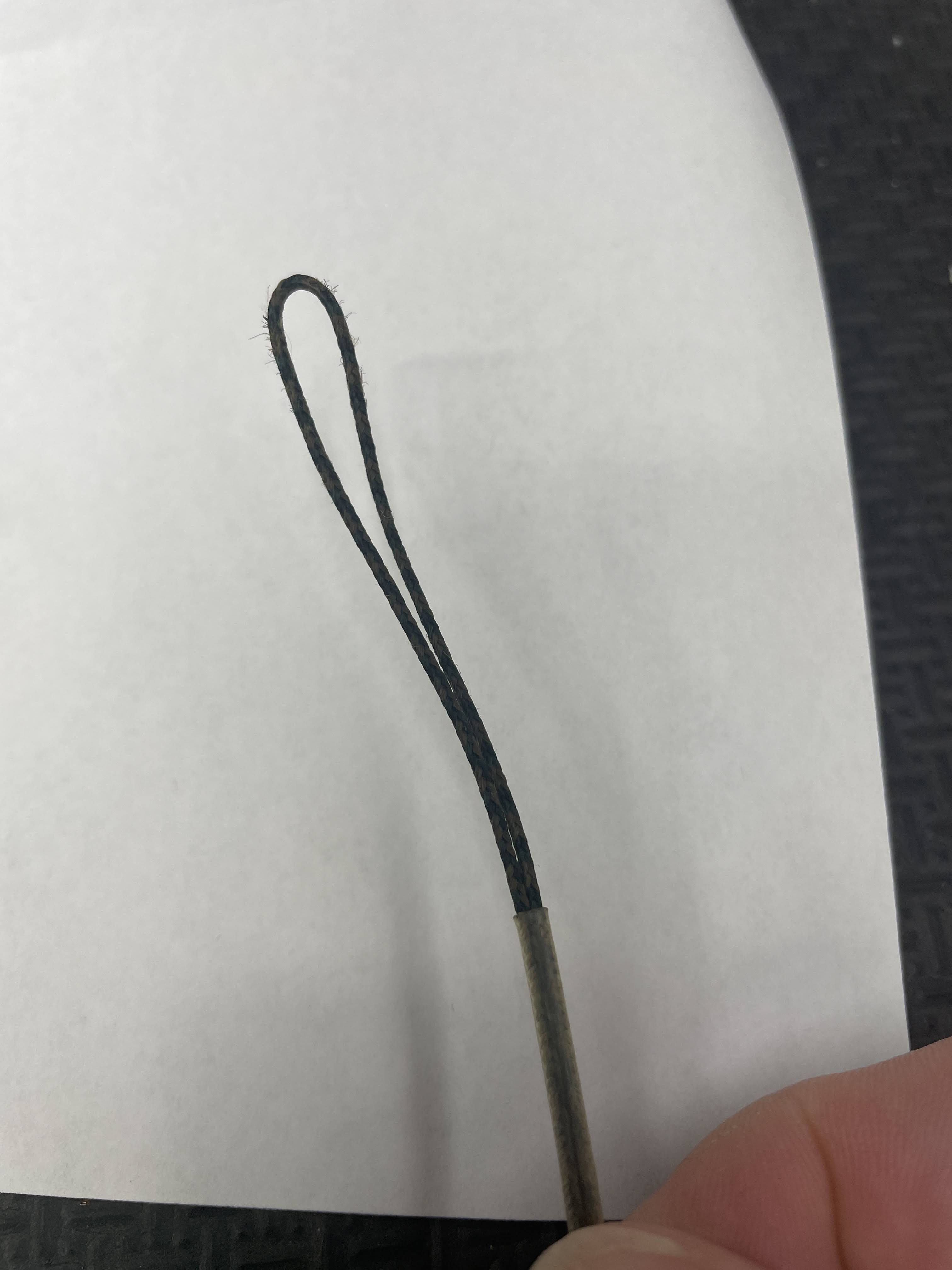

Cleaning and lubing the pellets lightly may stretch the time between cleanings. Less thorough cleaning at a higher frequency will result in more consistent accuracy. I will sometimes run just a single pull-through every 100 shots to stay at peak accuracy longer.
I make short strings by cutting off the head of a cheap mop. A couple of bucks gets you hundreds of these "patches". The pull-through is just very fine paracord and heat shrink tubing. works for any caliber, just more wraps or doubling of the thread. I can't take credit for it. I learned it from a wise powder burner benchrest shooter.

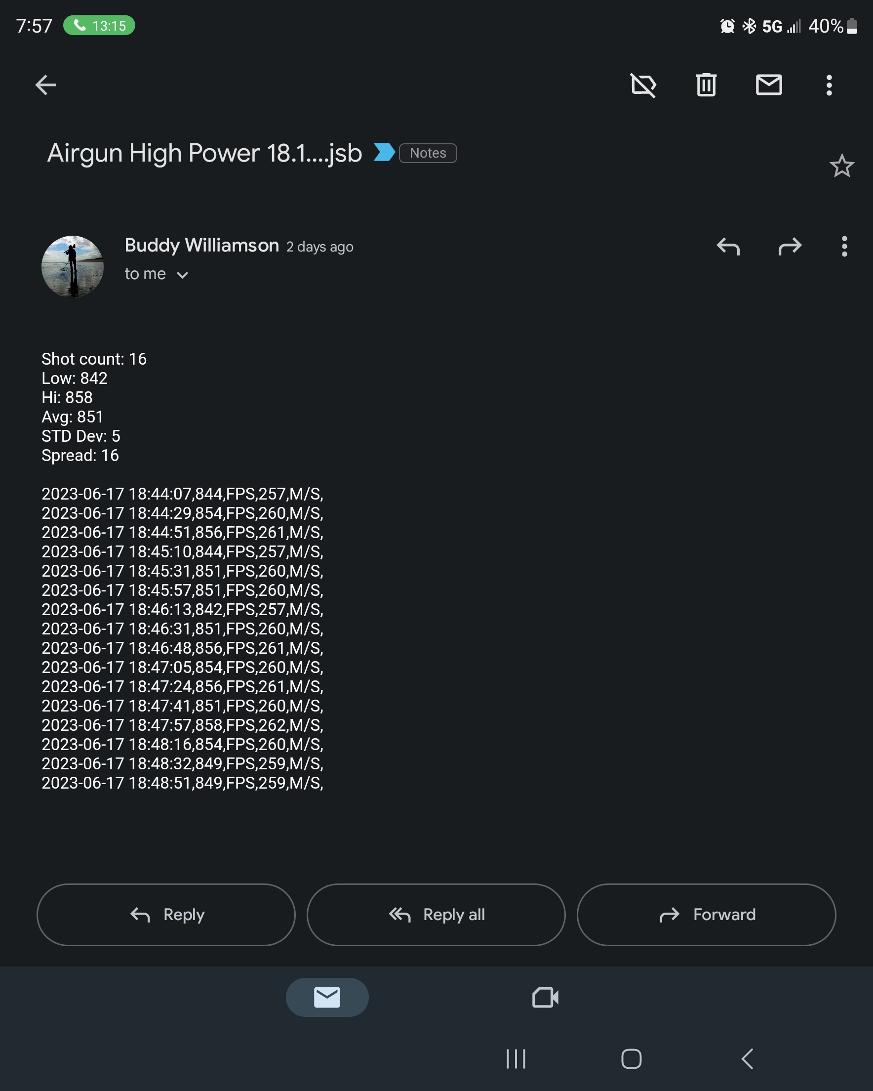

This is on low power 18.1 this is gen1 board.....

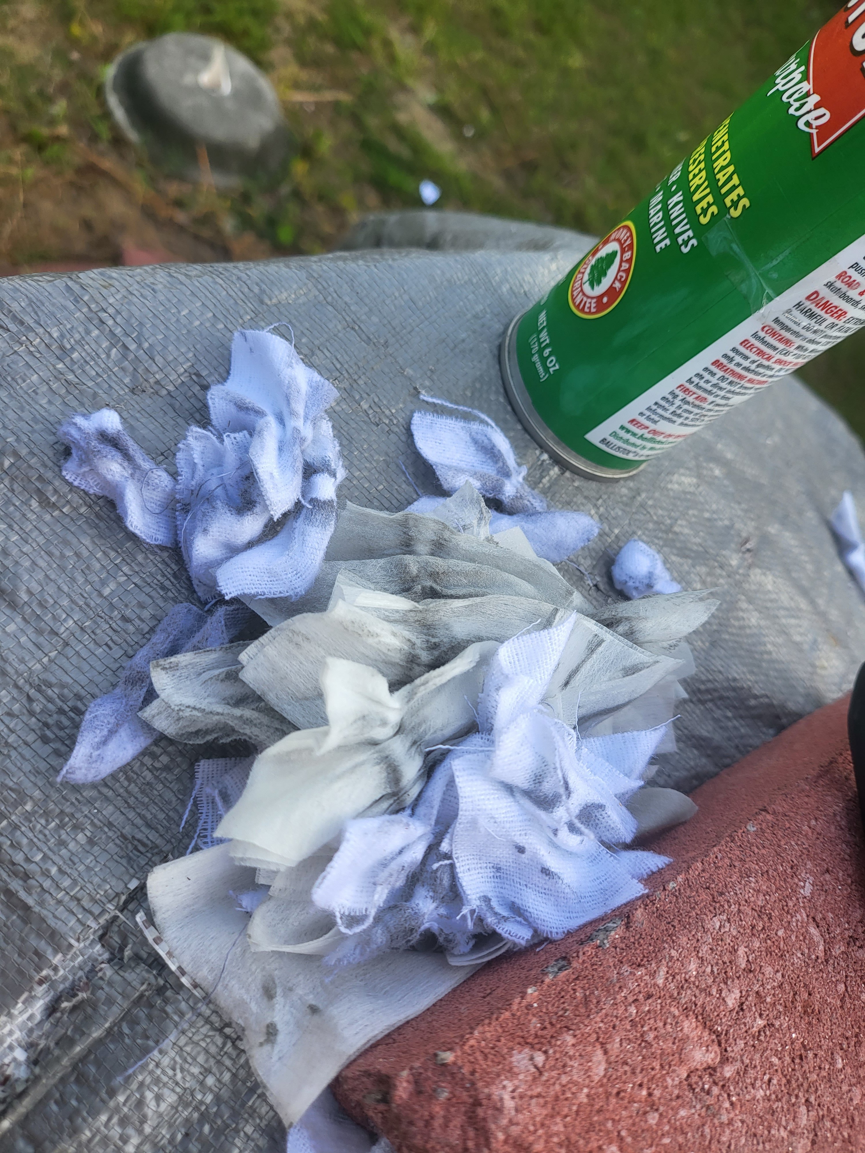

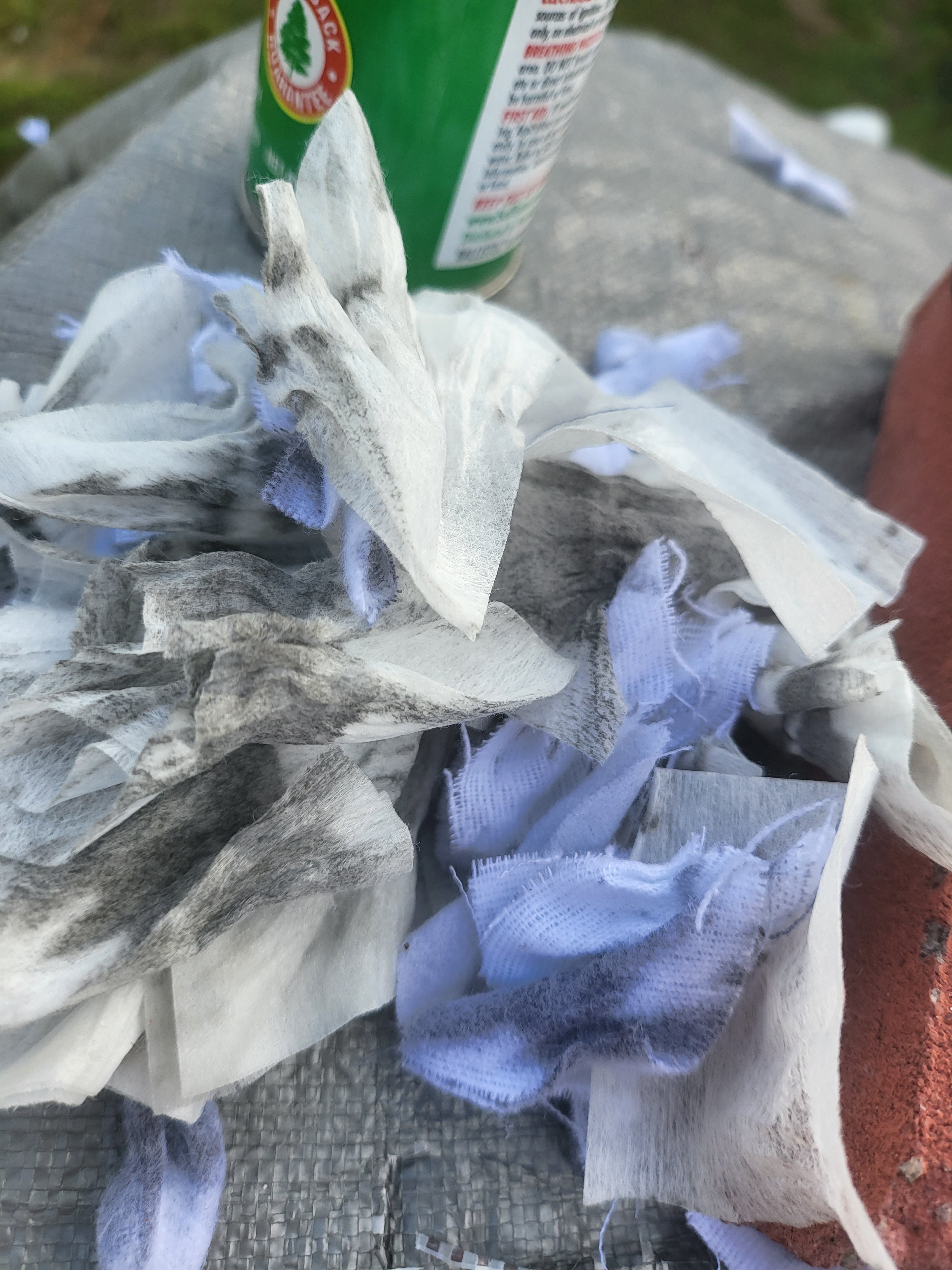

Have you cleaned the barrel traditionally, with a rod and brush from the breech? It might not make a difference, but I've had a few barrels that needed it. The black stuff on the patches is not unusual, nor likely affecting accuracy. Lead will show up on patches as lighter colored pieces of residue, if it comes out. Of course you might have a bad barrel. My RW came with a bad one.
Took the barrel off. Rod and brush. Yeah it's a possibility I probably have a bad barrel which I called AOA they want be getting any in no time soon by the way it sounds.
