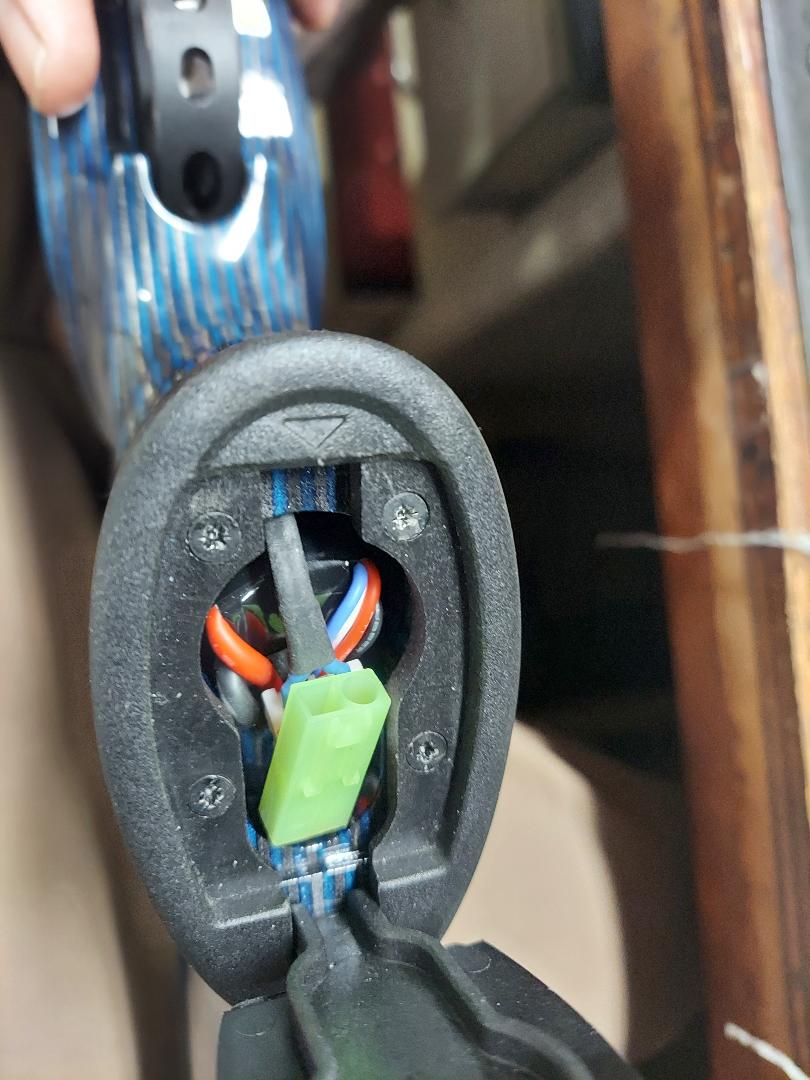

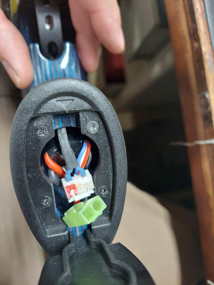

OK totally dumb on Lipos. Looking at these balance chargers it looks like they use one jack to charge and one to charge? So how would you balance charge/discharge a DW battery since it only has the one lead?
And, seems I need to disconnect that tiny hard to reach connector to balance charge or discharge? I don’t shoot my DW a lot so would be doing this exercise a bunch?

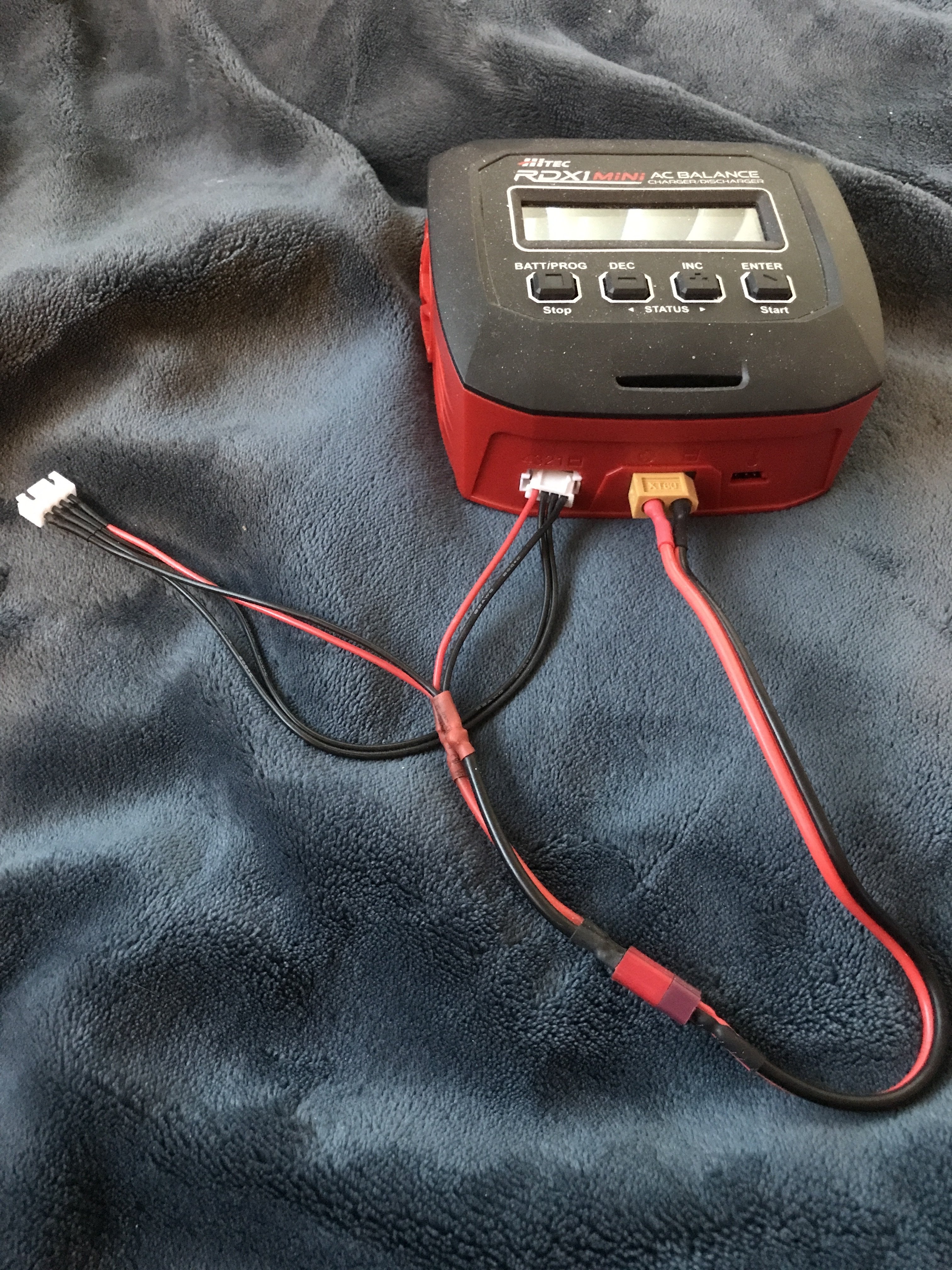

If you want to charge/discharge your DW batt that has only the balance connector, you will need to solder up a jumper, or buy one.
You will still connect the balance connector to the balance port, but the outer two leads of the balance will need to be jumped over to the +\- of the main output of the charger, being mindful of the polarities. That simple.
This is my hack
