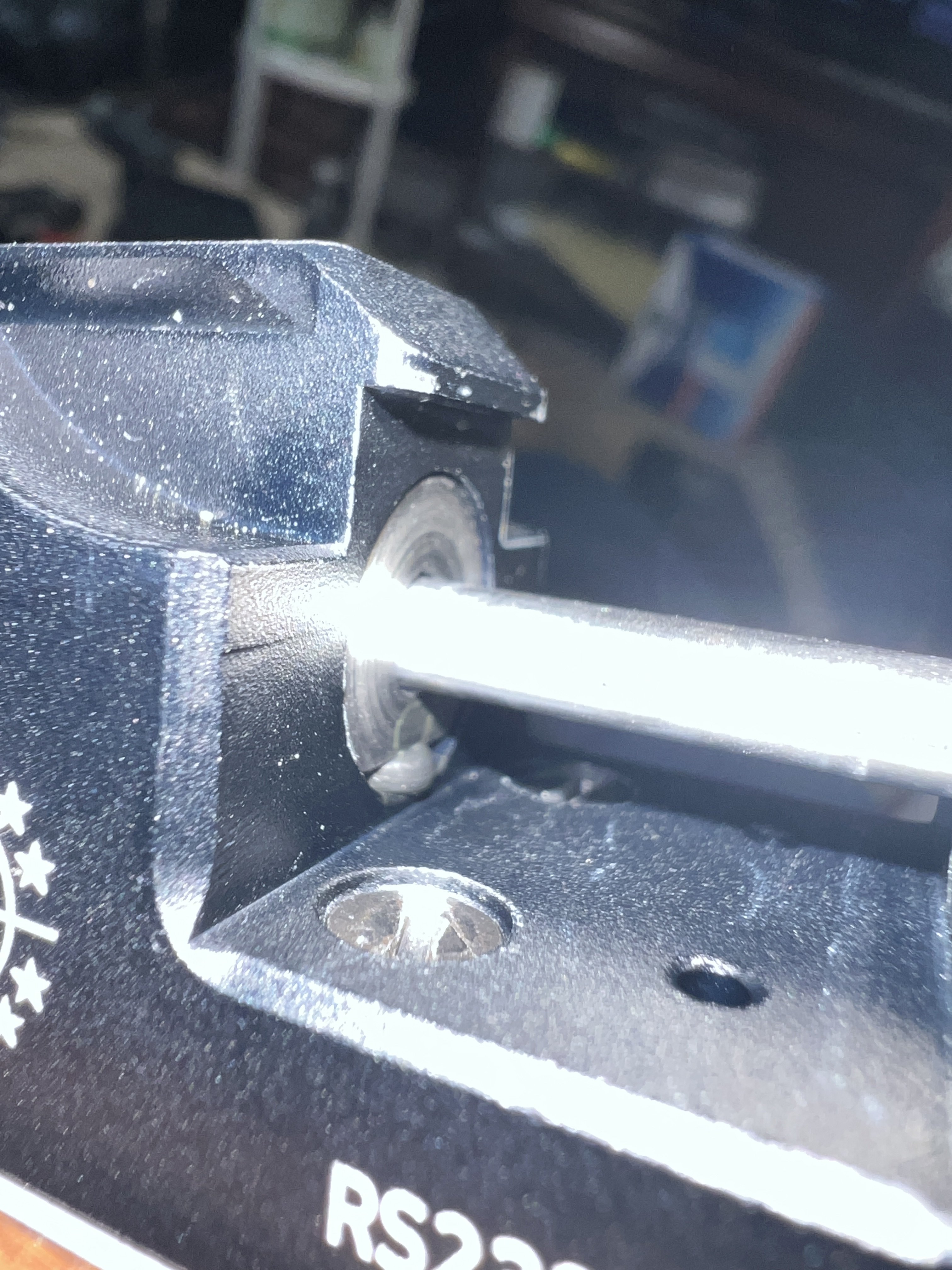

I just bought a new revere .177 from aoa,
And after first tank I realized the sound of the rifle changed,
Upon inspection a portion of o-ring that holds the transfer port in place was sticking out just under the barrel breach port!!!
Called Aoa and they said it happens after every 600 or shots!!!
They are sending me some spare o-rings and if that won’t work,
I can send the rifle back to Aoa,
Now my question to all u guys who use these pcp’s
Since this is my first ever pcp,
Why manufacturer has this portion shaved off at the entrance bottom part of the barrel port which is letting the o-ring slip out under pressure???

The flat breech bottom should have nothing to do with it. The TP O rings are captured by the TP itself. Unless it's torn apart, I don't know how it could reach that location.

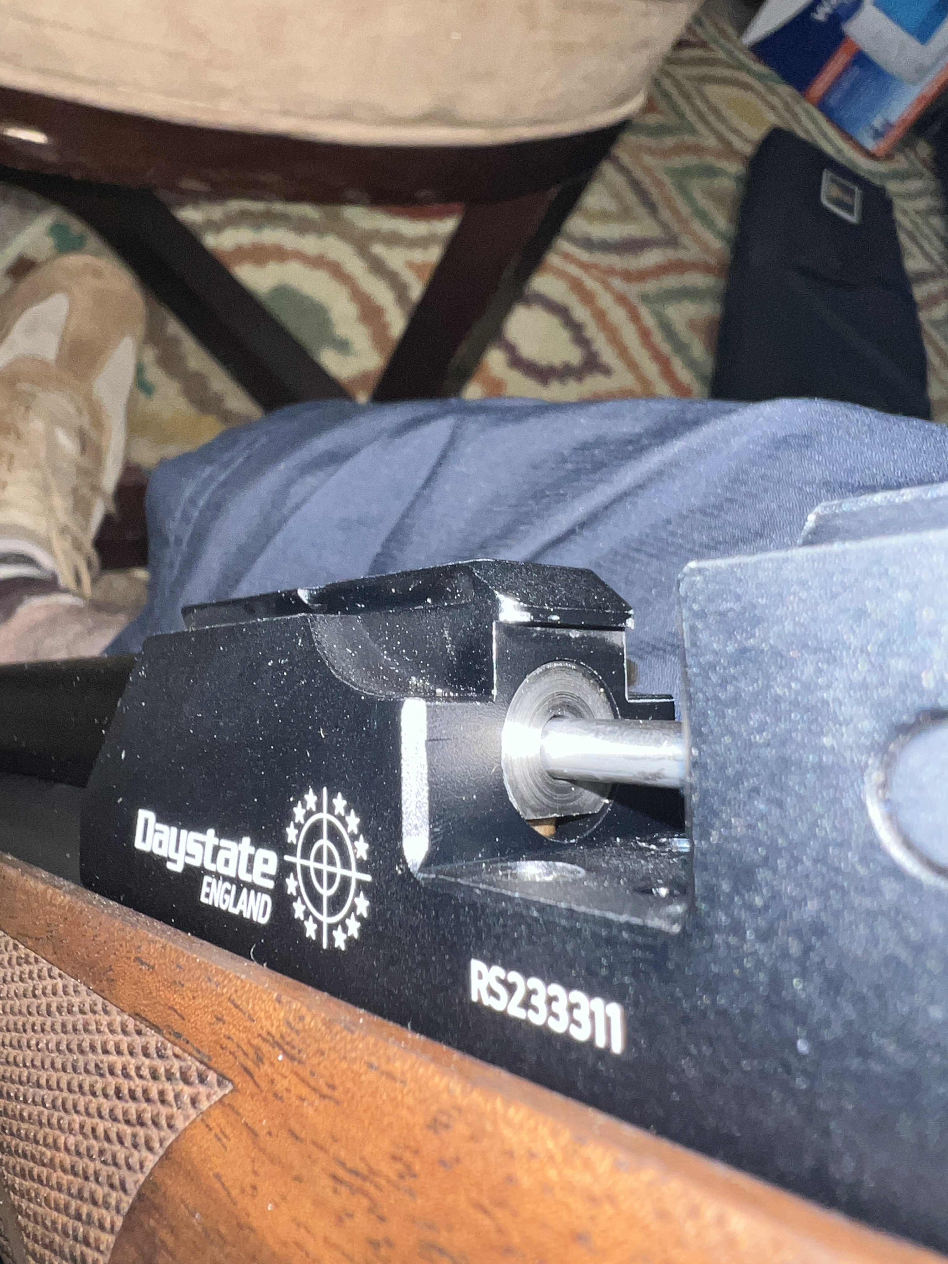

Here is a picture of o-ring after I reseated it!my question is why leave that room for error???
What is the purpose of that shaved area ??

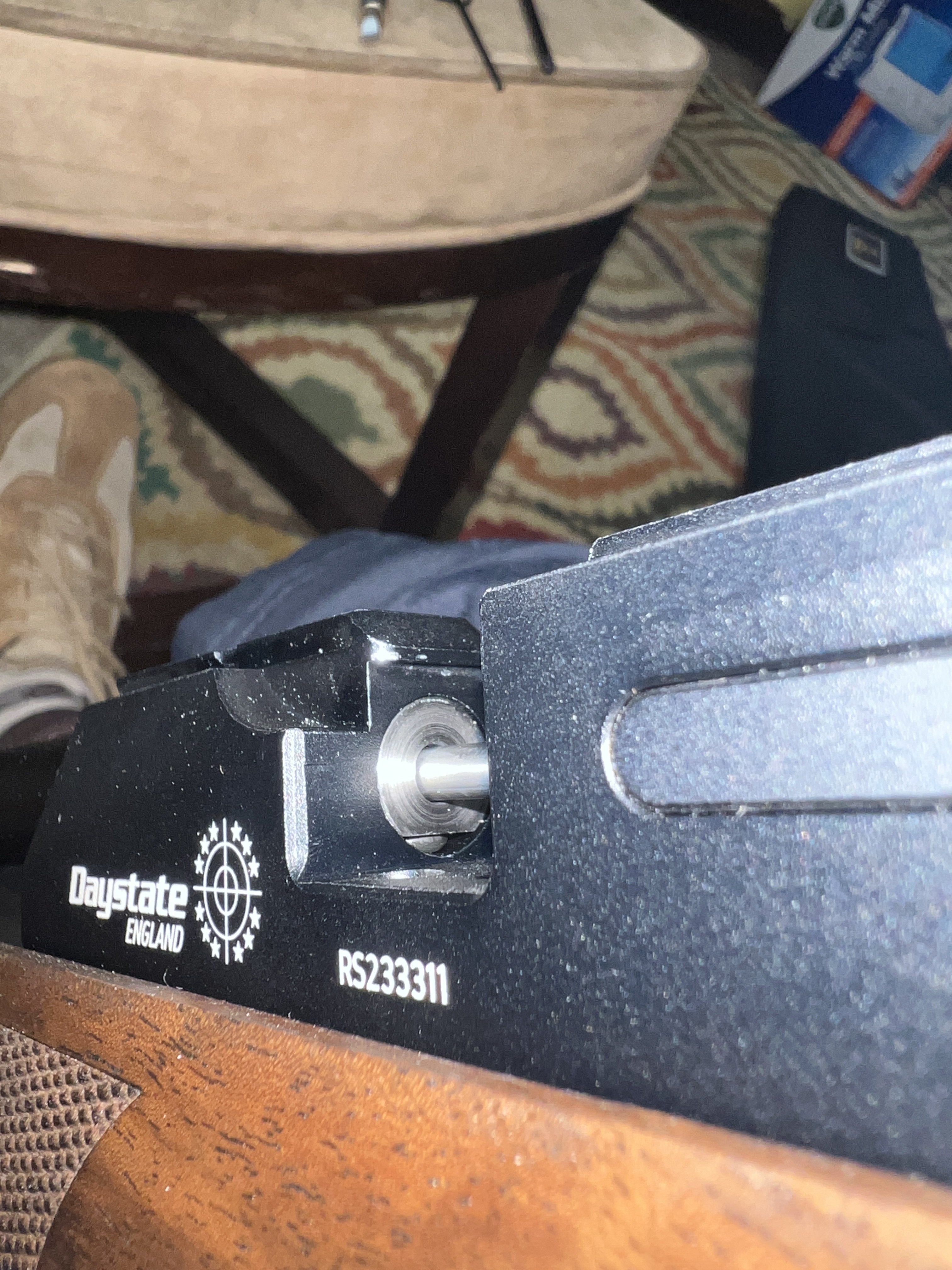

I did try to replace the barrel end o-ring with the tank end o-ring since it’s the same size o-ring,
But the result was same after few dry fire shots the rings slipped right out of that breach area???
After 4 consecutive times of trying to reseat the o-ring in vain
I have come to the conclusion
That barrel is defected or u can call the barrel is shaved off more than it needed to be???

I'm trying to understand how this happens. When you "reseat" the O ring, then obviously you disassemble the action, and with the top and bottom modules separated, you place an O ring into the transfer port recess. Then, when reassembled, the O ring encircles the top of the brass transfer port, which fits into the barrel breech. At that point, I don't see how the O ring can end up in the position shown, since it is captured between the transfer port and the breech cutout. Very interesting.

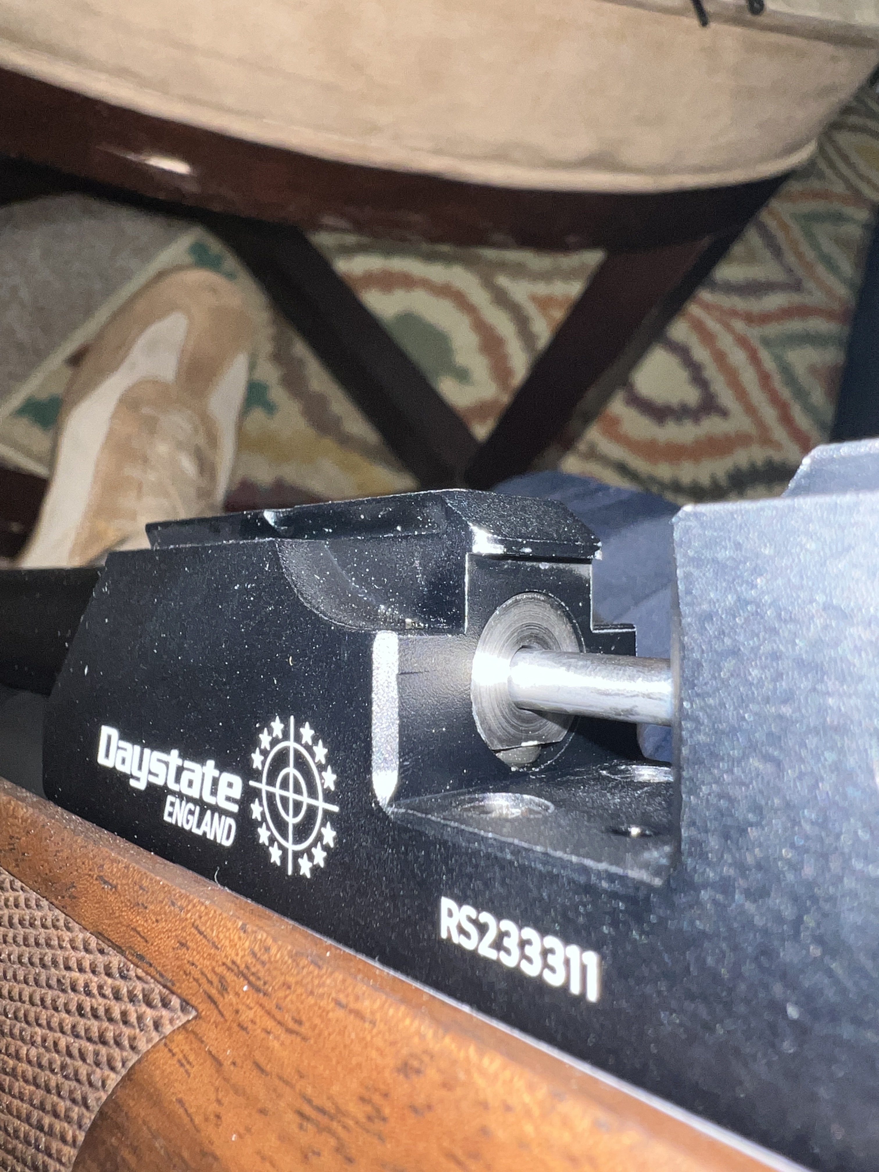

Ok guys a little update on my revere .177,
just got it back after 2 weeks from Aoa,
apparently the repair guy at Aoa said that the brass bushing that sits on the tp was undersized from factory and they just replaced it with bigger size and tested about 50 shots using 16grain pellets to stress test the rifle,the rifle held its seals with no problem.
i just shot like 4 13 shot mags through it using 10.3 grain and it is functioning fine…
