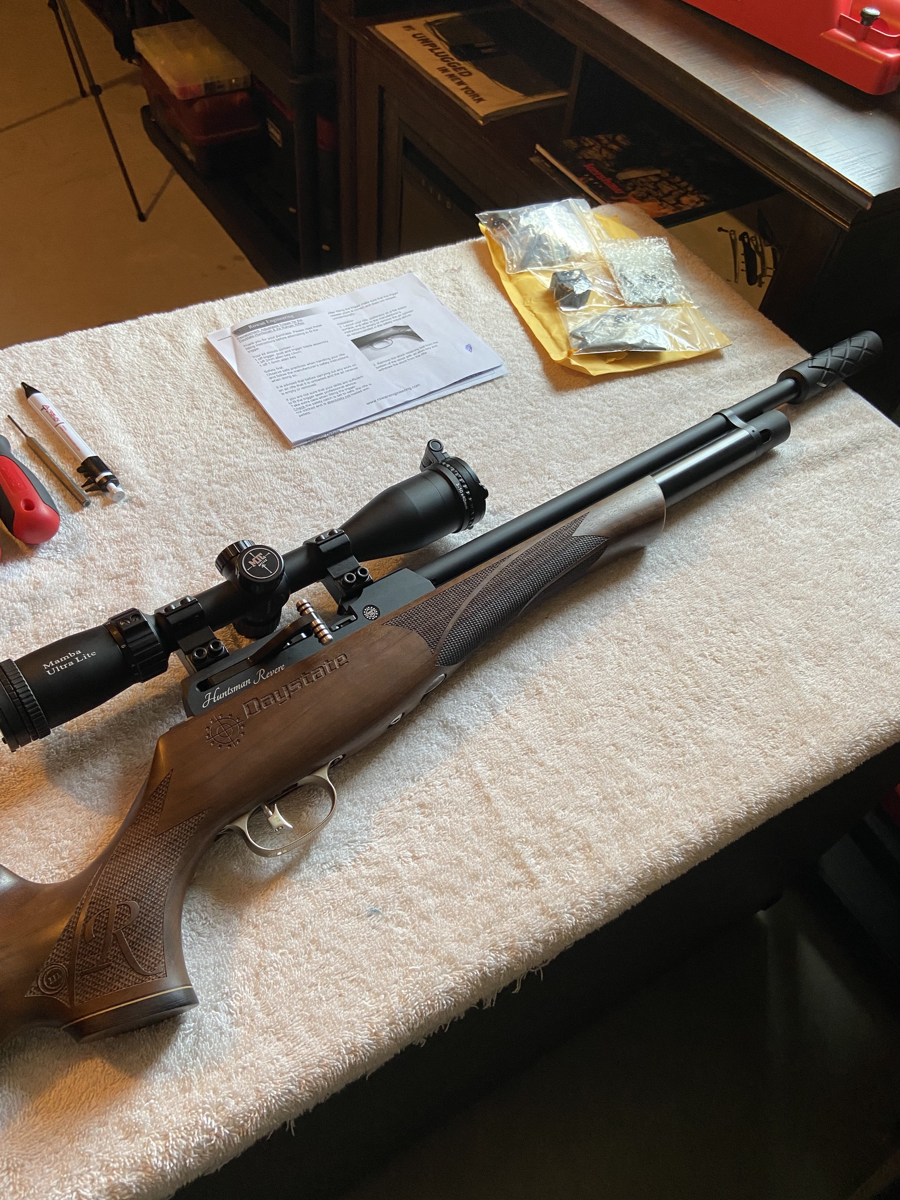

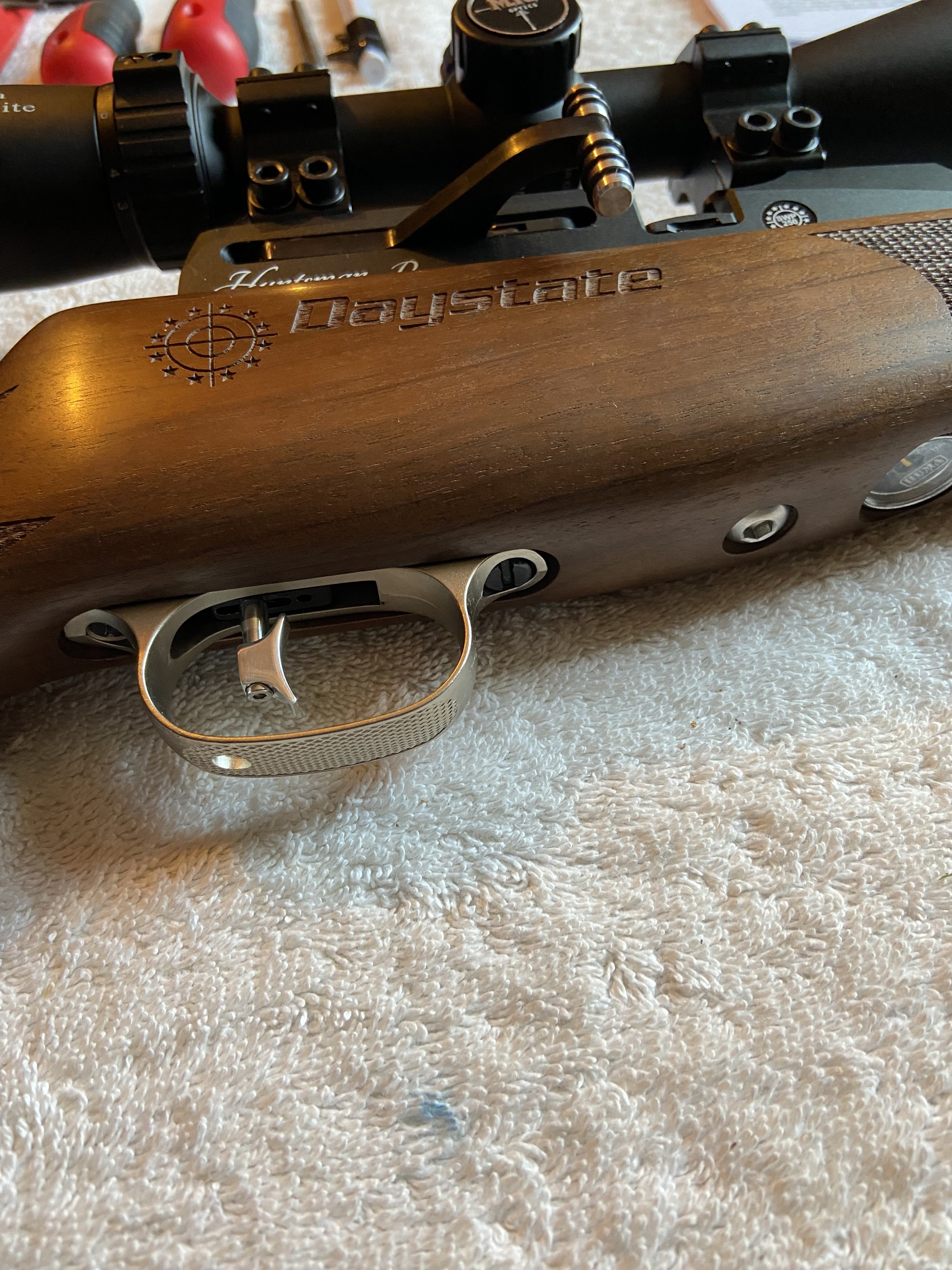

Love my regulated .22cal Revere!!! I tuned my .22 for 50 solid regulated shots, but I lowered the reg pressure and hammer tension.
