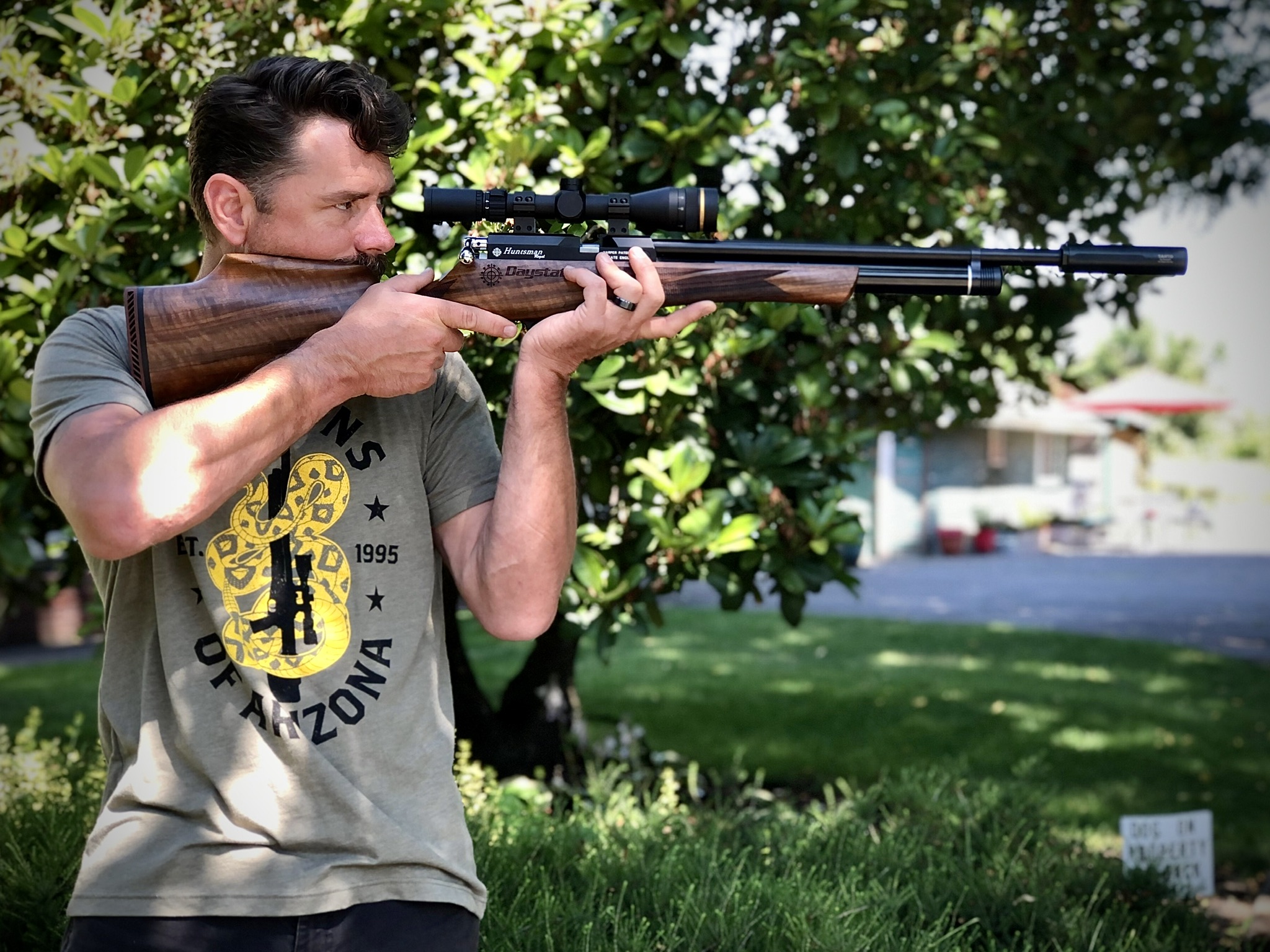

The Design flaw: My "We the Plinkers" edition came from AOA with rings and a 3-10 MTC "Mamba" scope. My first impression of this set up was "why the tall rings on this small scope? there's enough clearance for this scope to drop much lower?"
In fact, the scope is mounted so high, that I am unable to achieve a decent cheek weld, I have to "cheat" up and use more of the side of my jaw. Not a terrible or uncommon issue when using a rifle not set up for ones own needs, but it reflects on the speed with which I can get a good view through the scope.
The height is of course due to the needs of the magazine clearance required to fit under the scope. Ok, that's a thing with air rifles, and the solution is to adjust the comb/cheek-piece height to accommodate. This lovely sporter stock looks right, but it simply isn't right for the required height of the scope. To have this wonderful Daystate with it's superior fit and finish in essence, handicapped by the fact that the comb is too low, (or the magazine and thus the scope its too high) ...well that's just bad planning.
If I don't use the amazing magazine and use the single shot, i can mount the scope to a height that offers perfect cheek weld. But I am not going to do that, nor should I be in a place to have to solve this problem either way (cheek pad, adjust my shooting etc..) all are solutions to a problem that should not exist. It simply needs a higher (or adjustable) comb straight from Daystate.
Obviously many overcome this hurdle, and it's such a nice shooter, that I will do the same. But if these ergonomics are important to you, and they should be, you really need to consider this defect before before buying. Even the Marauder has this problem covered (albeit in plastic) the Kratos and Cayden use the same gorgeous walnut for their adjustable combs, and the Pro 500 has a proper comb height out of the box.

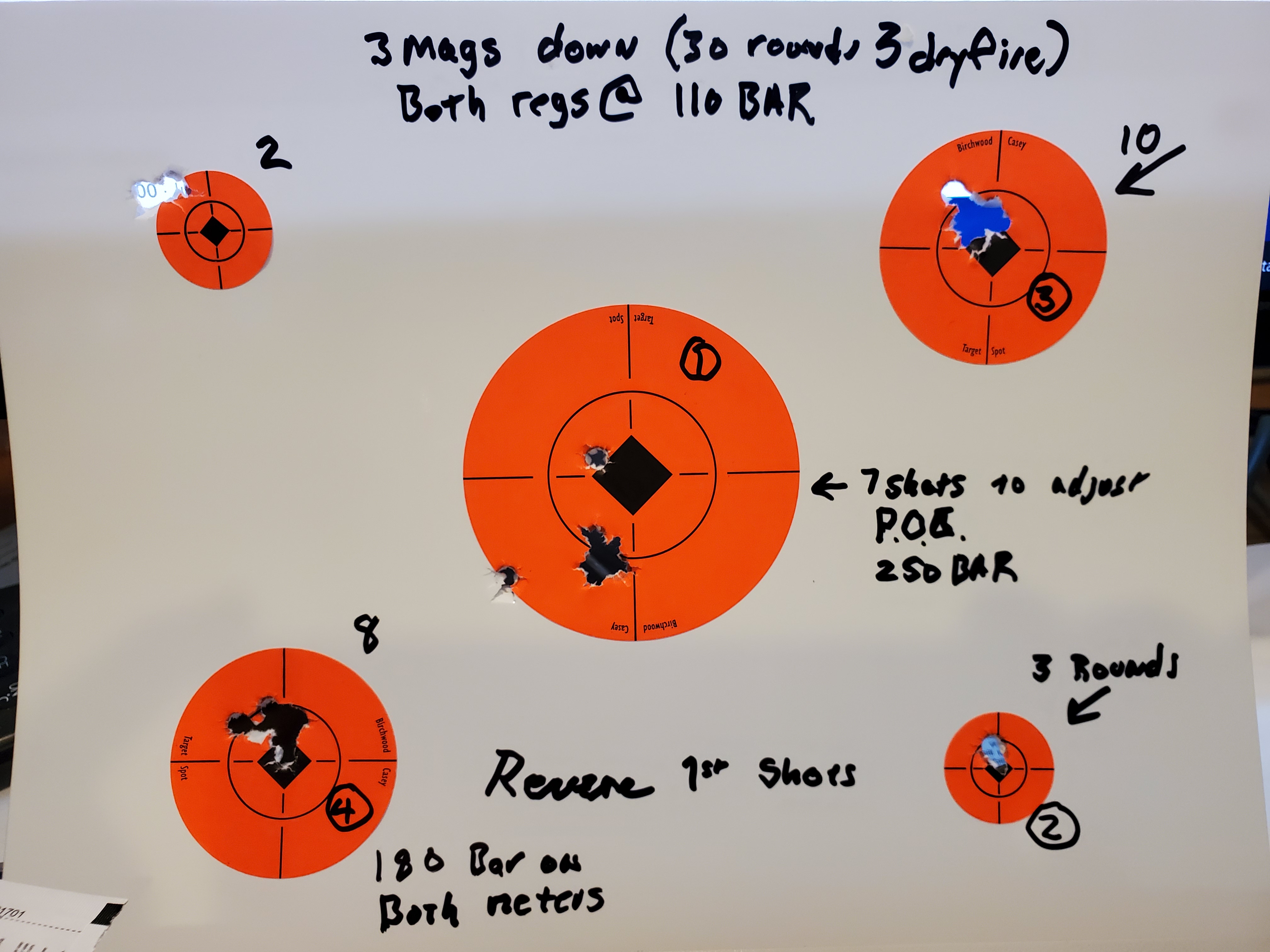

I only put three magazines through it before deciding it was time to pack it in. At that point both reg gauges were reading at 110/115 BAR. Unfortunately I don't recall what the regulator meter was reading at the beginning, but after two magazines and at least 3 dry-fires, (approx 33 shots) it was down to reading the same 180 BAR as the main bottle gauge. I'll edit this when I get around to a refill to see where the reg gauge lands when full at 250BAR.
I shot JSB Exact King .25 25.39 gr, the same as AOA used for testing with the scope they dialed in (close but not quite on)
Daystate had dialed in the reg for the Heavies. I'll try those next time.
I don't use a chrono, but AOA's data on the 5 shot test group with Kings are 814-816 FPS for 37.37-37.55 FPE.
Daystate's results using the King Heavies was 726.6-737.4 fps 39.8-41 fpe.
I was shooting at 35 yards (the max for my at home "range" ie: backyard) and this rifle with it's excellent trigger is a one hole wonder (lower right) at that range to be sure. I'd be better off with a superior scope, my eyesite is too old for 10x even at 35 yards.
I was surprised to see that even as the reg pressure began to drop with the bottle gauge reading, the poi never began to poop down. My last two shots (upper left) were as high as anything else. This leads me to believe I could get more shots, but I had reason to pack it in, and I was not looking to drop bottle pressure too far under 100 BAR.

Excellent write up & great shooting. So much to like about the Huntsman!
You did touch on the one thing that a lot of us wish were different - the need for high rings that can cause poor cheekweld, at least if you're going to use the magazine.
Saw there is now a Safari version that addresses this with an adjustable comb. More expensive of course, & doesn't appear to be available in the US just yet.
FWIW, I did get used to it enough to shoot it quite well standing offhand. Never felt completely natural though.
Reactions: CyberDyneSystems
Congratulations on your new rifle! Great write up. The comb height has never been right on any gun that I have owned. Some better than others and some totally off. I have a narrow jaw and high cheekbones so pretty much everything I shoot will have eye alignment issues to one degree or another. For a production gun of this quality I would say it certainly is useable. I recently purchased a used Huntsman Regal XL (177, unregulated,bolt) and I love it. So happy with my purchase. I look forward to hearing about your pesting adventures with your new Revere! 💥🎯👊🏼
Scope and rings pictured (Leupold 3-9x33 EFR) don't allow enough front/back placement of the scope for magazine clearance (turret housing). I have since changed the scope out to a Hawke Compact and get just a hair enough space to use the magazine now.
