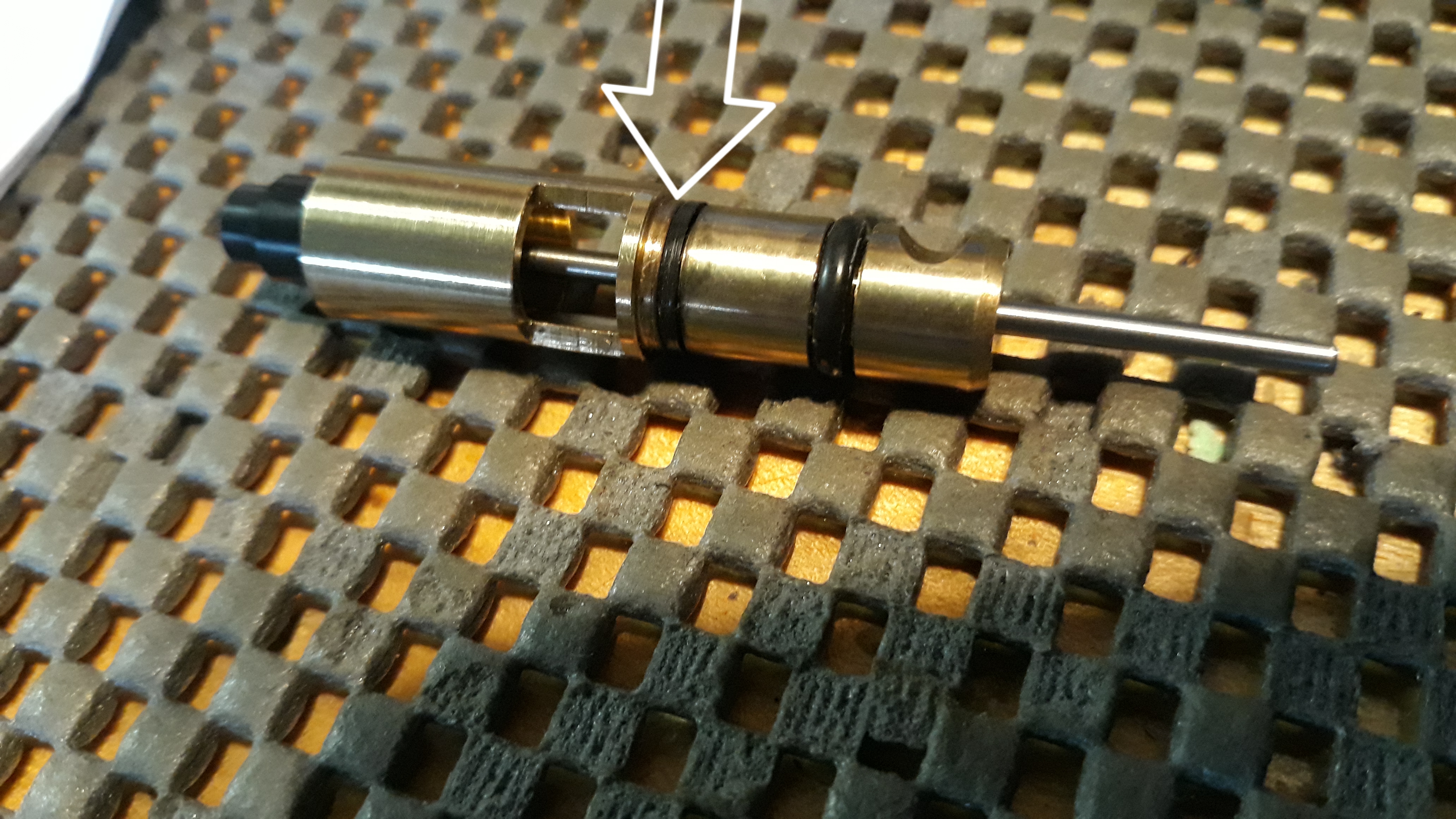

I bought a used Daystate TSAR off this forum about two years ago. It is actually a Daystate/Attaman . Gun has been really good but recently developed a good leak. Goes from 250 BAR to 90 BAR overnight.
I never received a manual for this rifle so I don't know how many or where all the o-rings are or sizes.
Does anyone have a manual or know where I could send this to get it taken care of? I prefer to send it out.

@AirSmithCA - may be able to assist. I used to have a Tsar and AirsmithCA still shoots them.
It's usually the wispy 1mm x 7mm Oring on the valve ..mits the Achilles heel of these rifles. I just changed one out on my Ataman earlier this week.
