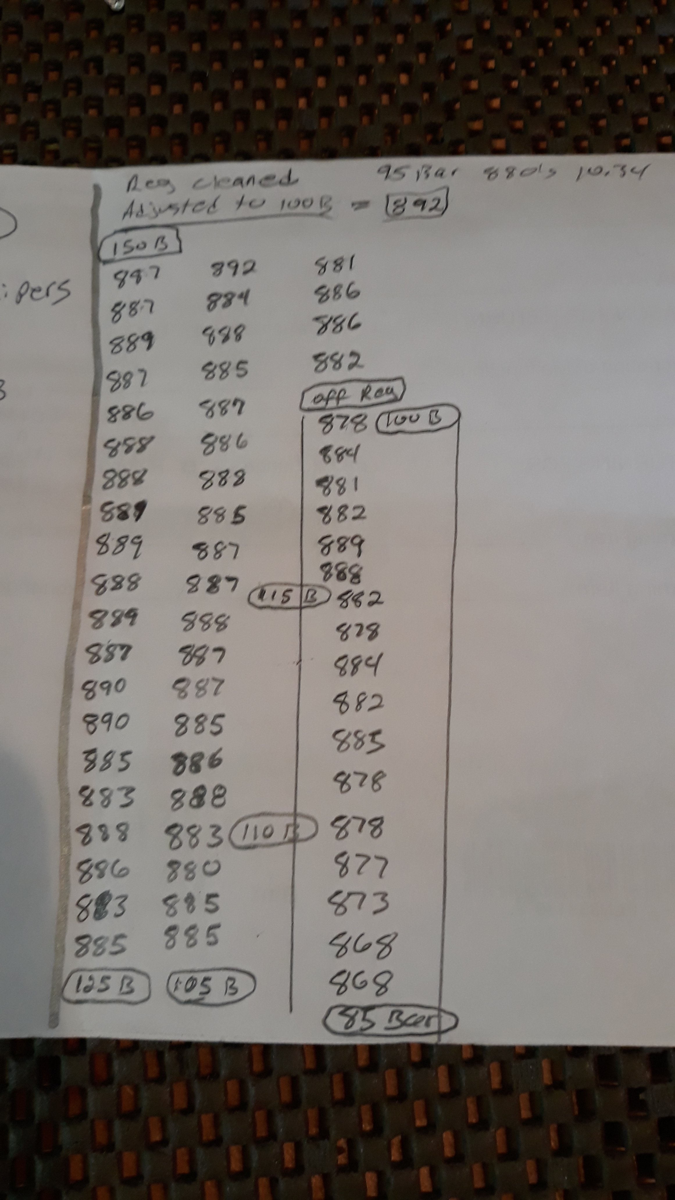

Not sure if you are still tinkering with the Tsar, but I remembered your comments about the shot count and air usage... thought I'd make a mention in case you are.
I just recently did a 20fpe tune (10.34's at 880's) on a Tsar with some issues, after some work on the hammer glide system, a better fitting poppet spring, a 3mm transfer port reducer, I found 45 shots from 150-100B fill with 12fpe ES out of the tin, and then approx 10 more off the reg in that same range. (Reg pressure set at 100B for this tune) There is some mild jetting, possibly could be improved but it seems appropriate for 20fpe so maybe not much.
This is the third rifle of this type I've worked on. In my experience, they shoot more erratic with a high pressure fill. So far the sweet spot on the chrony strings has been 160B down to reg pressure.

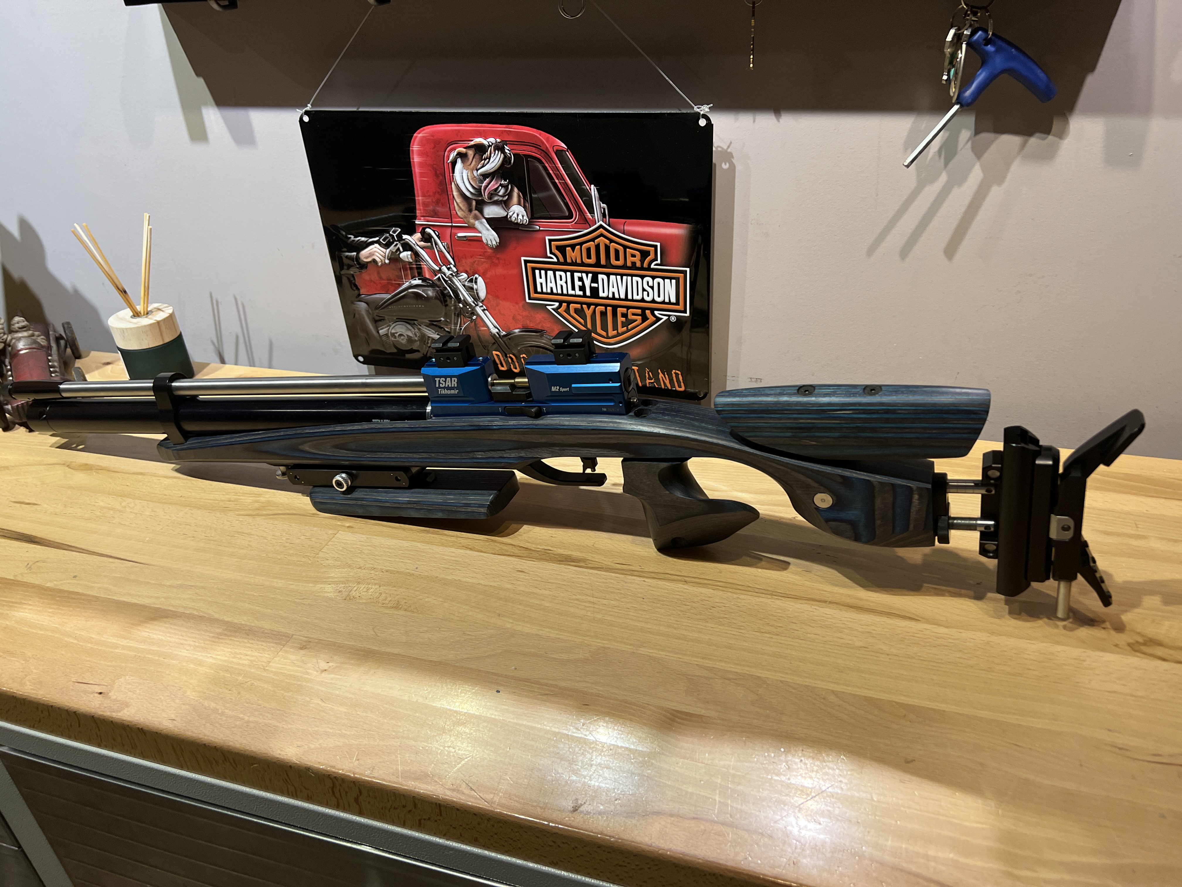

6/12/23 - My baby Daystate FT Tsar just got home from a fancy TSAR Airgun SPA.
I was so excited i was up at 4 a.m. scoping it for a moments chance to shoot it a bit end of day this week - i love my work but it sure interferes with my airgun FT hobby. @AirSmithCA .
Do you think one of these "twin brothers from different mothers" will get jealous and do the Cain V Able thing?
Reactions: stann and bf1956

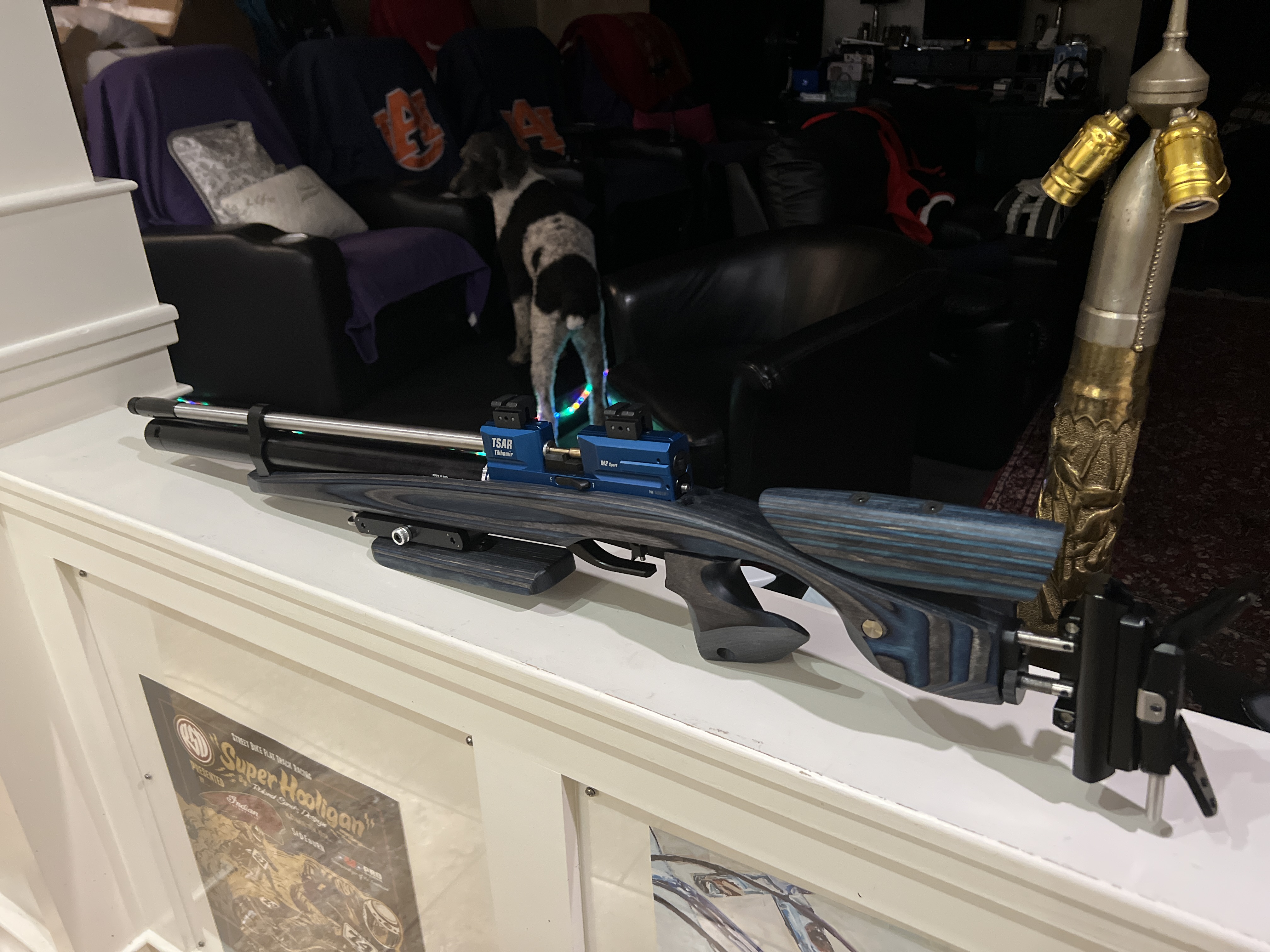

6/12/23 - My baby Daystate FT Tsar just got home from a fancy California Airgun SPA.
View attachment 364201View attachment 364202

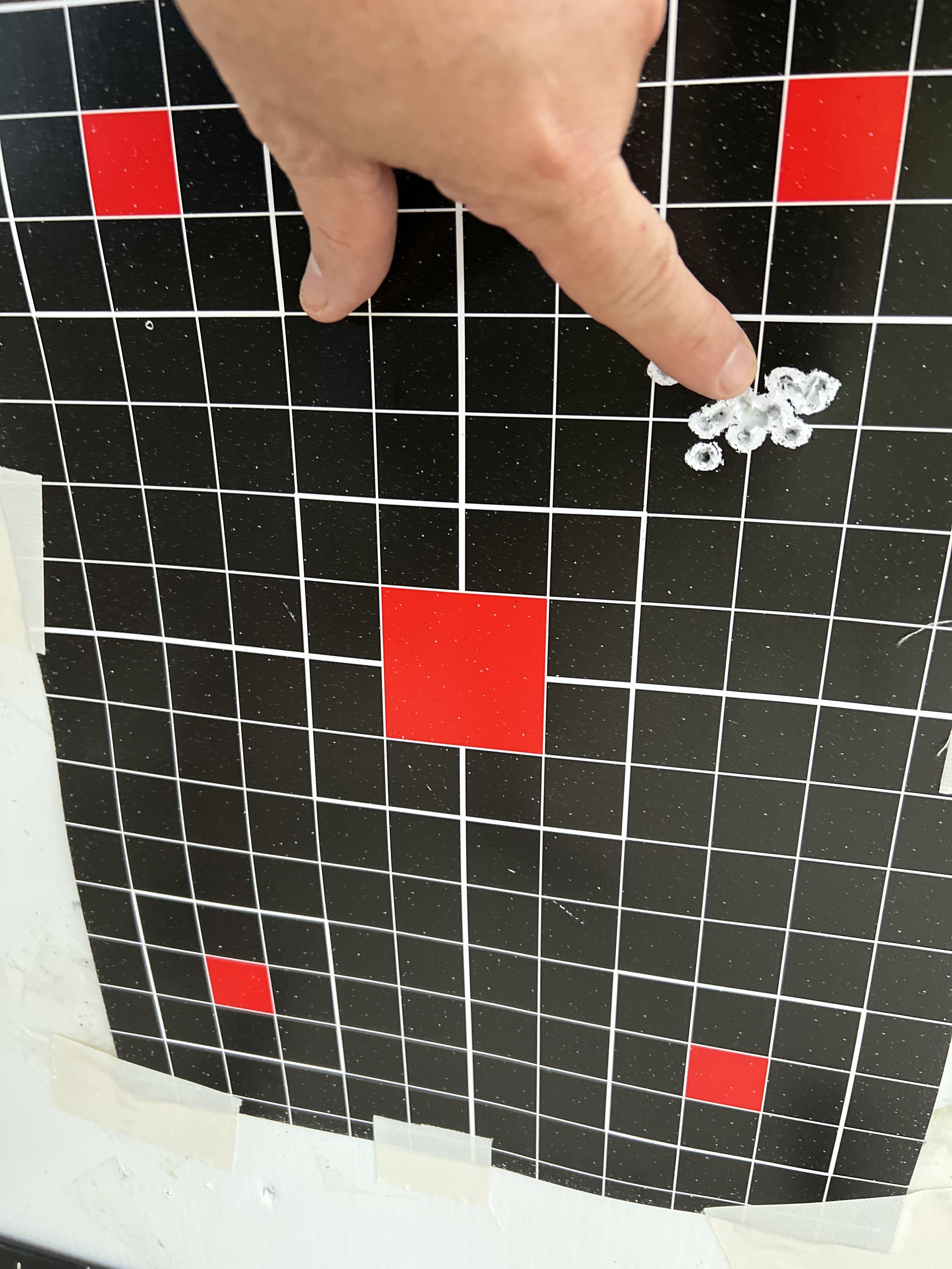

Same day, same rifle, different mission = zero the scope at 25 yards and shoot 25 pellets quickly from my indoor bench off bags to my outdoor range with a target set at at 55 yards plus a foot or two. 17 shots at my finger with 8 close to it.
I’m curious why a higher pressure fill creates issues? Is it because the regulator has to work too hard?
I'm not completely certain, but suspect it's a combination of harmonics and air pressure moving through the valve. The Tsar's valve has a thin 1mm oring at the neck and a 2mm thick oring at the base. My theory is that allows for some vibration/harmonic change at higher pressure. I installed a 1.5mm thick oring on both of ours, that barely fits and snuggly. My Tsar noticeably shoots best at a 150/160Bar fill.
Its completely possibly yours could do well with higher pressure fill.
Are you noticing any change with 200 bar fill?
