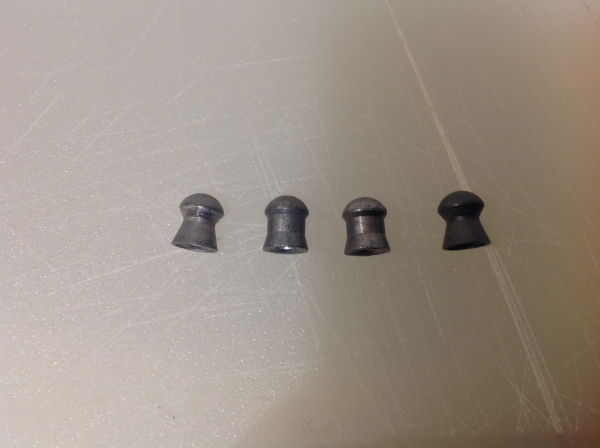

I still have a couple tins of Daystate Emperor and they are the same shape and size as the JSB 50 grain which are different in shape and size than the JSB 44s.
The Emperors and the JSB 50s both shoot accurately and the performance data over the chrony and drop in trajectory are not statistically different out of my bobcat .30. Both shoot at 83 fpe
never got a chance to really try out the 50 gr in my new .30 Impact. Impact wasn't feeling very well after shooting the 44s and had to go back for warranty service.
photos left to right: JSB 44.75, JSB 50.15, Emperor 50.15 , FX boss 46.30. The most visible difference is the FX Boss which is darker in color and likely different alloy and Lube. The heads and skirts on the two 50s look identical and are different than the 44 and fx.
Regarding 7.62 vs .303 the Emperor label lists both.
