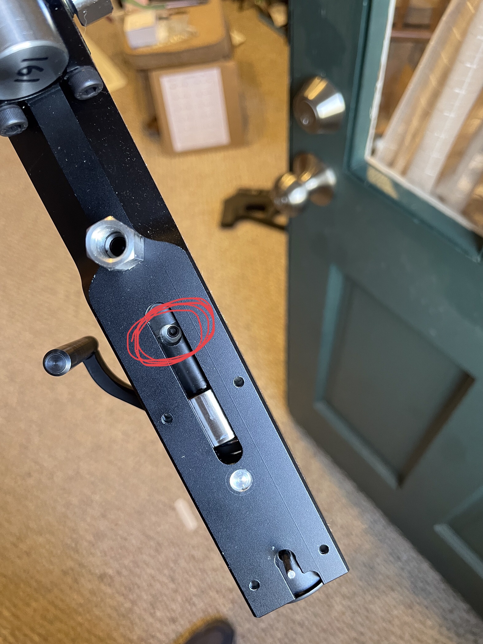

I believe that you are referring to adjusting the “length of hammer throw” in Daystate’s slingshot hammer.
Length of throw (distance the inner part of the hammer travels) via loosening the lockdown grub screw on the SS hammer (circled in red in picture) and then inserting a 3mm allen into the hole in the back of the action and turning clockwise to increase length of throw (increase power) or turning CCW to decrease length of throw (reduce velocity).
