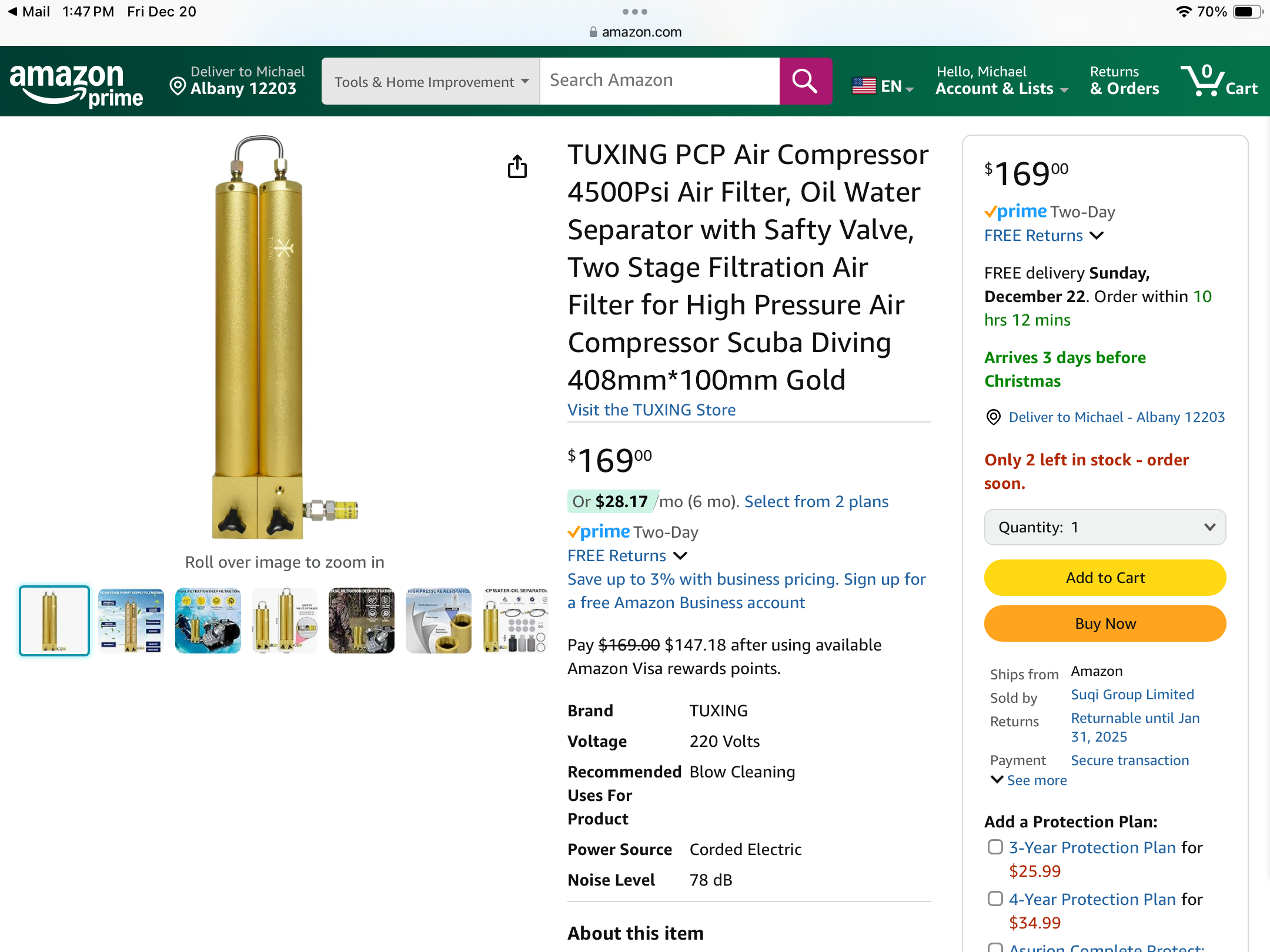

I use one of these, comes with an extra filled filter and you can purchase just the filled filters.
I looked that one up. It seems to be very well regarded. I think I might need a separate stand-alone water separator to compliment the filter - more research needed.
Thanks
JackHughs.

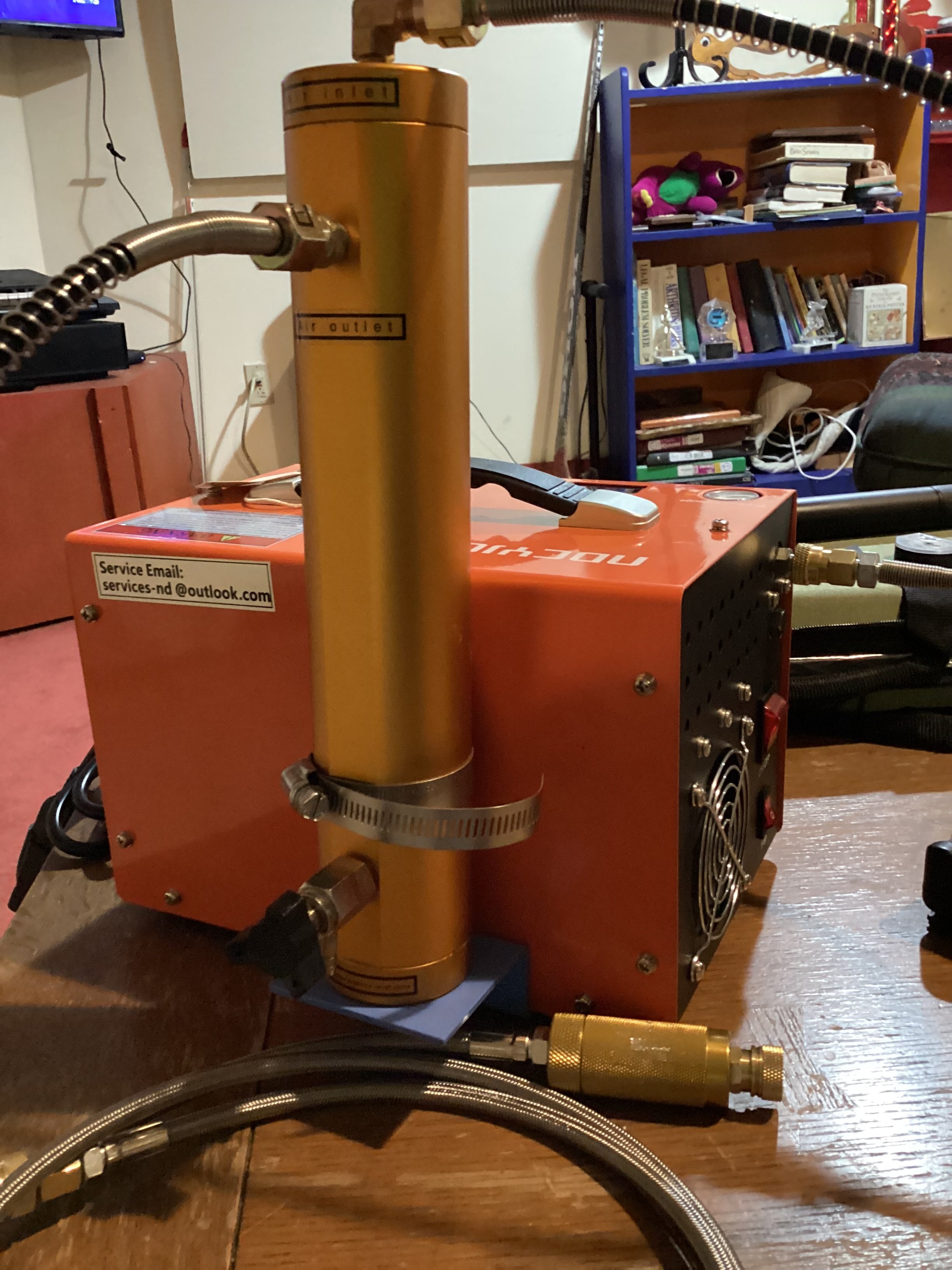

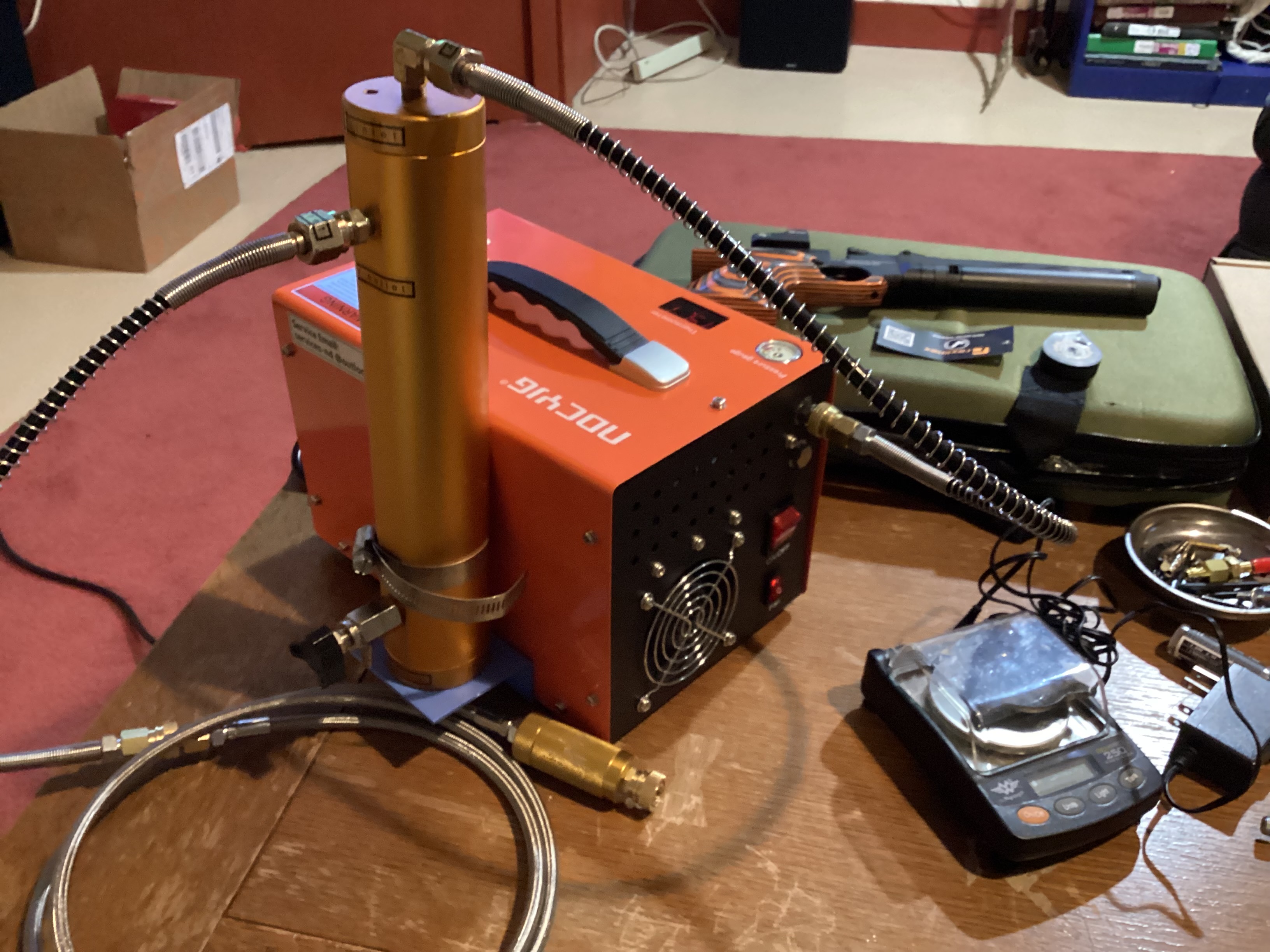

new gx cs4i coming, gonna swap the gold thing
The new CS4-i compressor and the external "Gold" filter arrived yesterday afternoon. I got the system up and running this morning and filled a 9L tank from 260 BAR to 300 BAR in approximately 30 minutes
Installed a small handpump filter between the compressor and the Gold filter to act as a water separator (condenser). Everything worked as it should and I was surprised to discover how much water and grease the handpump filter captured and how little air was lost in bleeding the two filters.
I like it! I hope it lasts.
