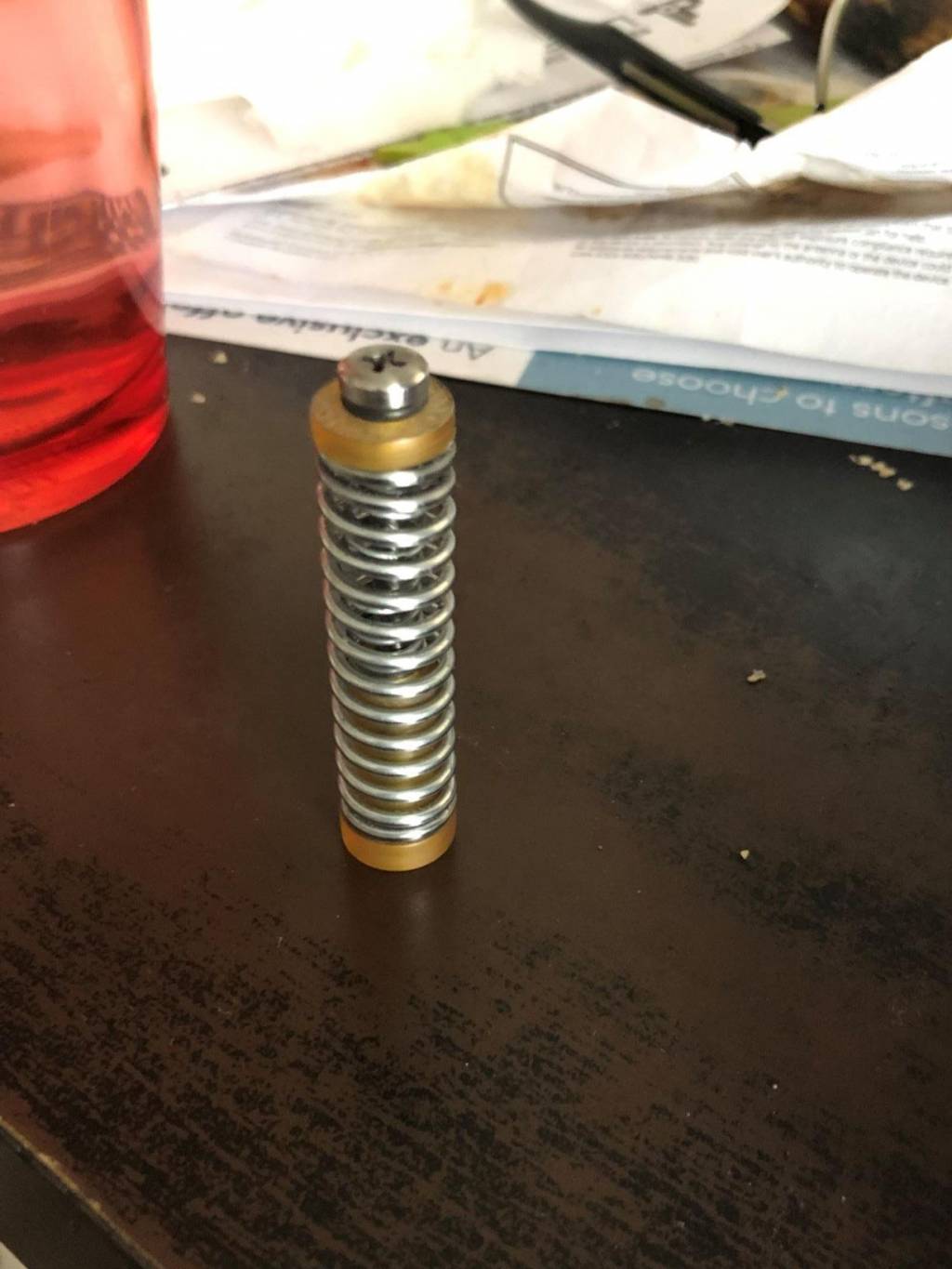

Investigate how you could make or have someone make a SSG for your gun. Spring Stop Guides (SSG) are 100% effective in eliminating hammer bounce .... which is wasting air, lowering shot count and increasing your gun's report.
Here is a pic of a SSG for one of my RAW HM1000xLRT's :
So the spring can be compressed but only expands to the limit set by the screw? That’s a nice looking device. I think I understand the principal I wonder if I could put something like that together if I make a trip to Ace Hardware…

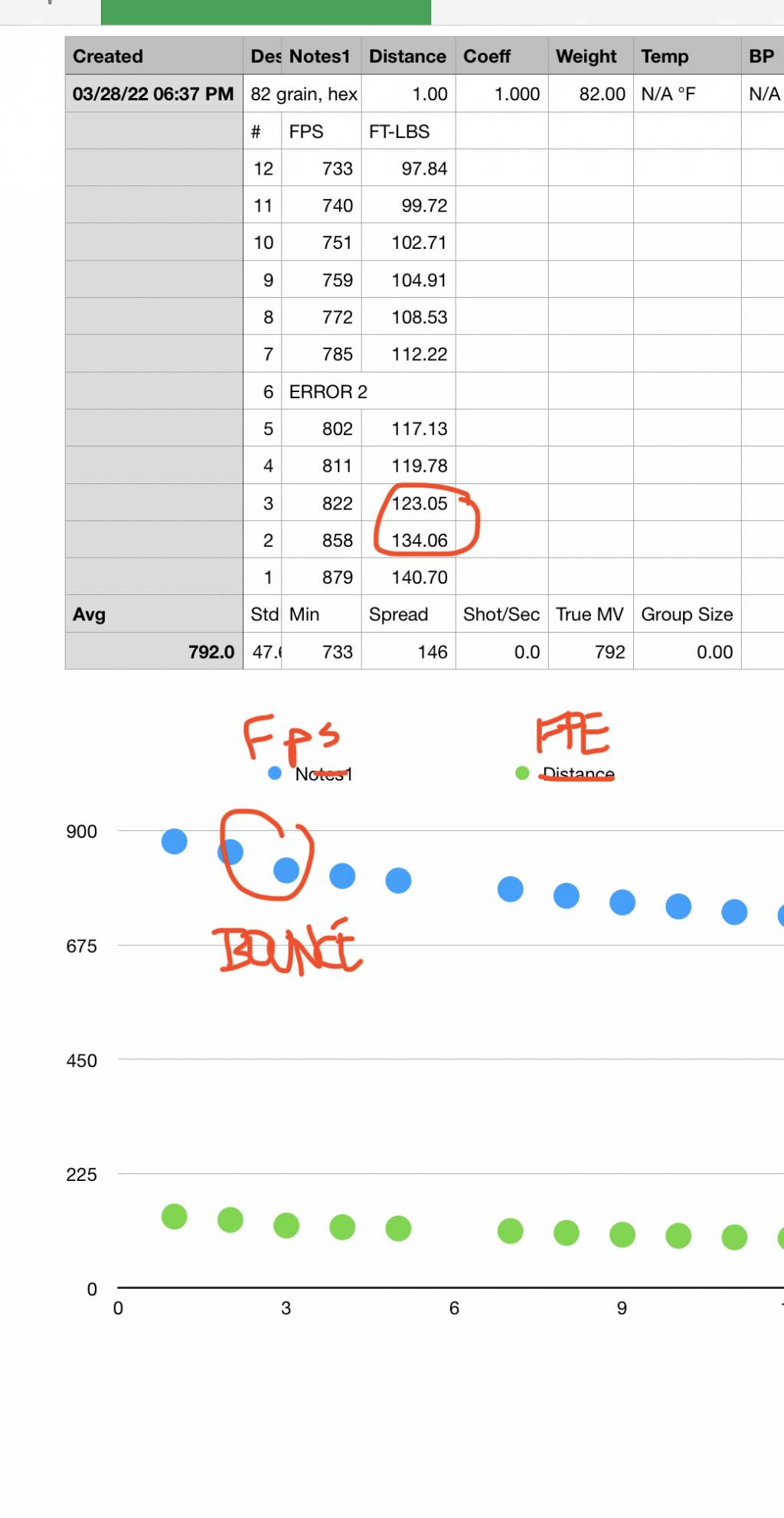

I just got a better shot string with a nice tight “snap” for a report (with ldc on end). There was a bit of hammer bounce at shot number two - highlighted on the pic attached - but nothing like what it was doing before. The other shots had no audible sign of bounce
I left the original spring and dropped a single hex nut over the spring guide (between the spring and the hammer). I then backed the retainer nut/stock out just a bit less than the thickness of the nut so spring preload is just about the same. I was hoping that the extra weight that is free to move independently of the hammer itself would maybe dampen the hammer oscillation more quickly.
