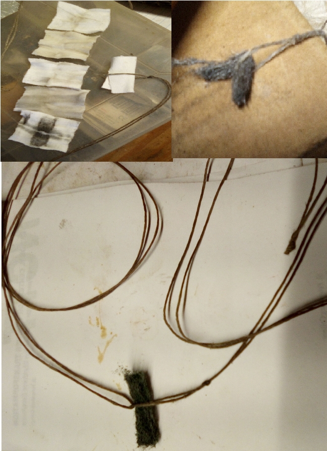

You use like brass ,copper ,bronze wool or what i use most now is Scotch brite pads cut to fit .. also my string thing i can pull it one way or add a tag line and go back and forth to do a good scrubbing..
Hint....
On the wool be sure its not a coated steel wool types. I have used regular steel wool in a pinch heavily oiled , never dry .
Cleans nice and shiny 🤤

I just put that loop in like above and dont got to fight a slip knot chincing down on the patch qnd that harness thread above no telling how many 100's of pulls it's done and got plenty more in it to got out of it ..
.22 its easy to fing cleaning stuff but that .17/177 not so and it ends up a homemade diy item . I tried weed eater line as well and all but it just comes back to my harness thread pretty quick.. it's just been tried and true for my needs. I qlso like one thing to to everything over this for this and that for that then others for others ..lol. One little mess over several messes.

Well like my thread above use scotch Brite pads cut to size or the btass types wool.
Blowpipesam at gta suggested the scotch Brite to me and i now prefer it over the hard to get copper, brass, bronze wools by far.. cheap and available near everywhere local. I feel it does a good job . Im glad he suggested it.

See I WANT it to be abrasive to "scrub" then run patches.
I always go in from breech end. Probably gunna use the loop n pull method from @Hateful McNasty
Thought I had some scouring pads....🤦‍♂️
Just dont pull them dry . Have a bit of oil or solvent on it.. they used to even say dont dry patch a barrel. Maybe be still do🤔. ( I dry patch a air gun to get any oil/ solvent residue out to finish ).
