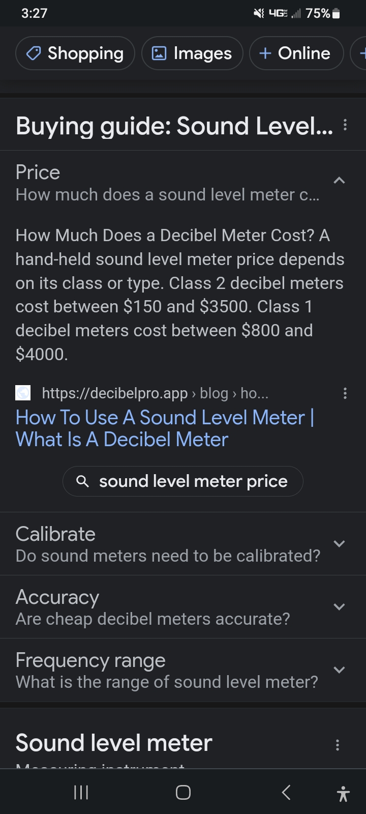

I've been on the hunt too!
A snippet of my research🤙
