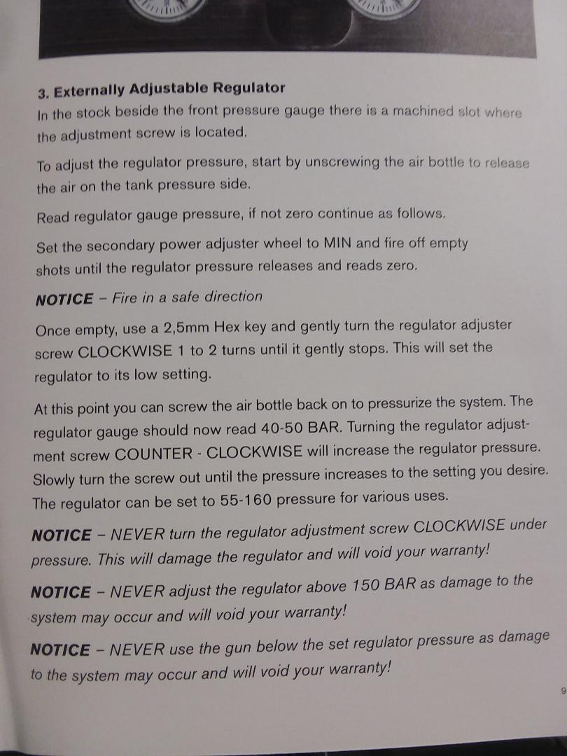

just got my mk2 continuum yesterday, reading the owners manual.....
FX is infamous for their owners manuals. This latest version seems to be one generation behind- much superior to earlier manuals I've recieved with other FX guns I've purchased.
They used to be comical in their references, oft times referring to a different rifle or pistol than the one the manual shipped with. When doubt, call the FX customer service line and get the latest insights. The newish USA team is a big improvement over previous support.
