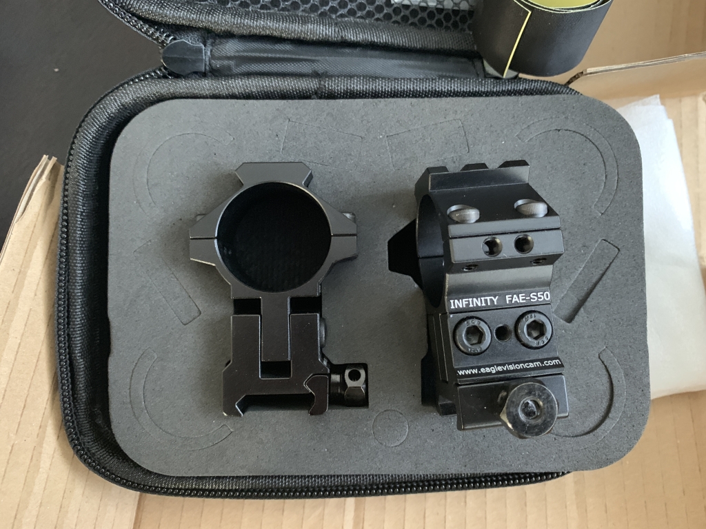

I got a surprise in the mail today. I thought these were stuck in US customs, but they just magically appeared this afternoon!
1565053774_10813017795d48d34e7a3692.55986103_201279FA-AD34-4BD4-A48A-97C774E8E516.jpeg
Quality appears to be excellent I'm going to have to make some time to install these this evening.
