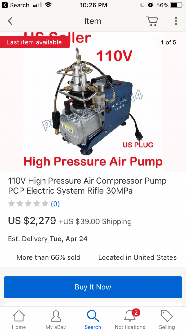

Yong Heng Style from ebay
Found Online:
ebay – search for High Pressure Compressor
Price: $ ~300
Pros:
CHEAP – 300$ is getting close to the “who cares if it works, it’s cheap range”
Auto pressure shutoff
Digital temp guage
Cons:
Cheap? Support?
Have to hook up external water circ with 5 gal bucket – not really indoor friendly
Many reports of issues after arrival (electrical, etc)

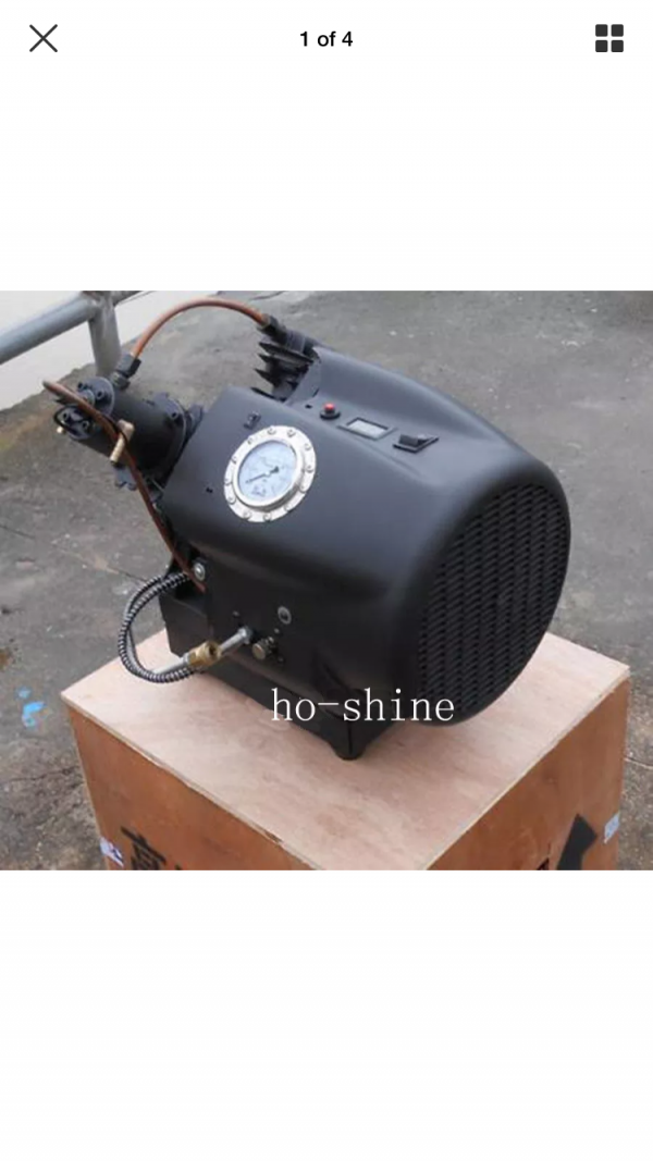

Ebay Scuba Diving high pressure air compressor
Found Online:
ebay
Price: $ 800
Pros:
Comes with dryer
One of the units has photos water-marked “ho-shine” so that’s sweet... in fact it's really the only reason I included it - interest factor
Cons:
Still have to use bucket for cooling
Pricey for what it is

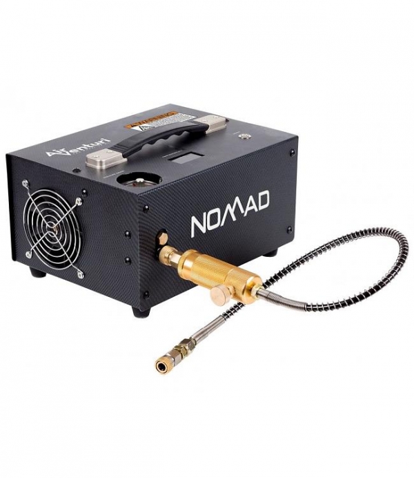

Air Venturi Nomad 4500 PSI Portable Compressor
Found Online:
https://www.pyramydair.com/s/a/Air_Venturi_Nomad_4500_PSI_Portable_Compressor/8460
Price: $ 500
Pros:
Really small
Self contained compressor the size of a shoe box
Can also run off car battery
Auto shutoff
Temp guage
Cons:
CANNOT be used to fill SCBA tanks
Manual bleed valve – but if using for only guns, shouldn’t run for more than 15 min anyway)
Can only be used to fill guns directly

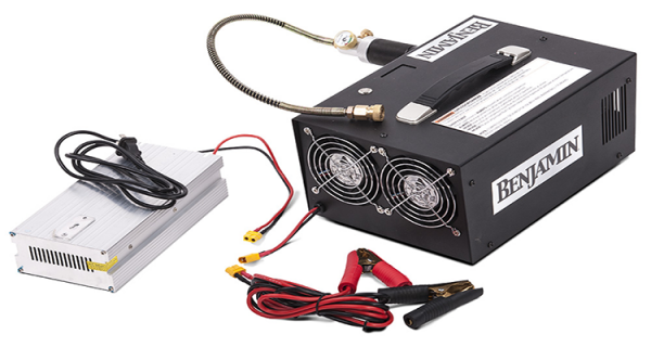

Crosman Corporation Introduces the Benjamin® Traveler™ Portable PCP Compressor
Found Online:
Crosman Corporation Introduces the Benjamin® Traveler™ Portable PCP Compressor[/QUOTE]https://www.crosman.com/connect/cro...able-pcp-compressor/embed/#?secret=wA7CGZ86y0
Price: $ 649 MSRP – not yet available
Pros:
Really small
Can also run off car battery – kit contains battery hookups
Temp guage
Cons:
Can only be used to fill guns directly (bottles less than .6L)
No Auto shutoff pressure switch
