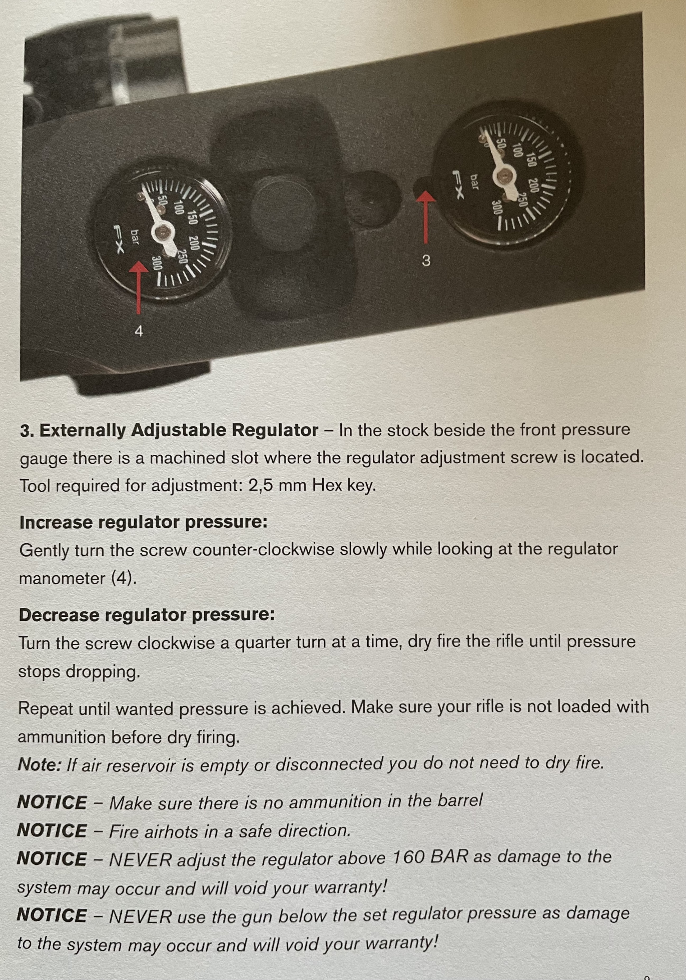

Here’s the page from the FX manual for adjusting the stock FX reg. However, if you have a Huma reg you must degas the gun before making ANY adjustments.

Should be fine to dry fire, just make sure to turn the hammer wheel to it's lowest setting.

1 is the lowest but I don't recommend dry firing. I tried it and my pressure gauge went down to 50 so dry fired again. Now I know my gauge only goes down to 50 needless to say the gun was empty not 50 bar so a trip to FX USA
FX told me not to dry fire but to open the reg screw 1/4 turn to let the air out
Thanks @18.13
Do you mean open the regulator adjustment screw>
Or a different reg screw?
Edward

I just follow FX's instruction and turn the reg adjustment clock wise 1/8 of a turn and dry fire couple of times and repeat the process till desired reg pressure. Lowest hammer spring setting for dry fire isn't necessary so won't worry if it is the lowest or it's 1 or 2, I do that just so I waste less air.
Again this is what I do with my(7x) and my friend's FX guns so YMMV.
Do exactly what 18.1 said. Also there is no reason whatsoever to degass when increasing the reg or any pcp reg. I will say when making small adjustments down on the newer amp regs I have done it as the fx manual says. Only turn it a small amount at a time and then take a few shots. I have had no problems but the safest way is to degass when going down.
