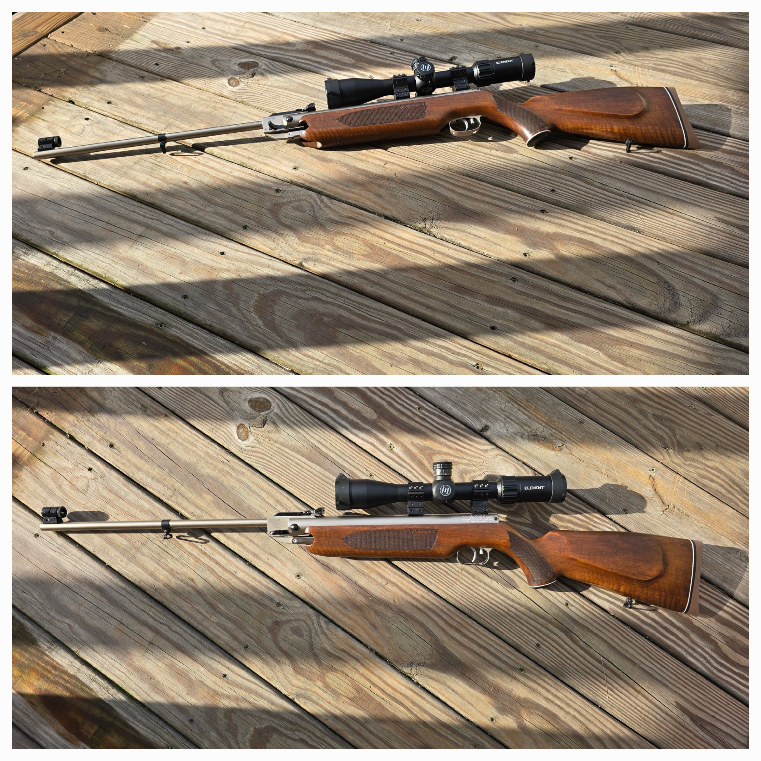

Then AoA, as if sensing a moment of weakness, swoops in with a stainless, walnut, version.
It even has a sling set up like I used to put on mine back in the Robert Beeman era.

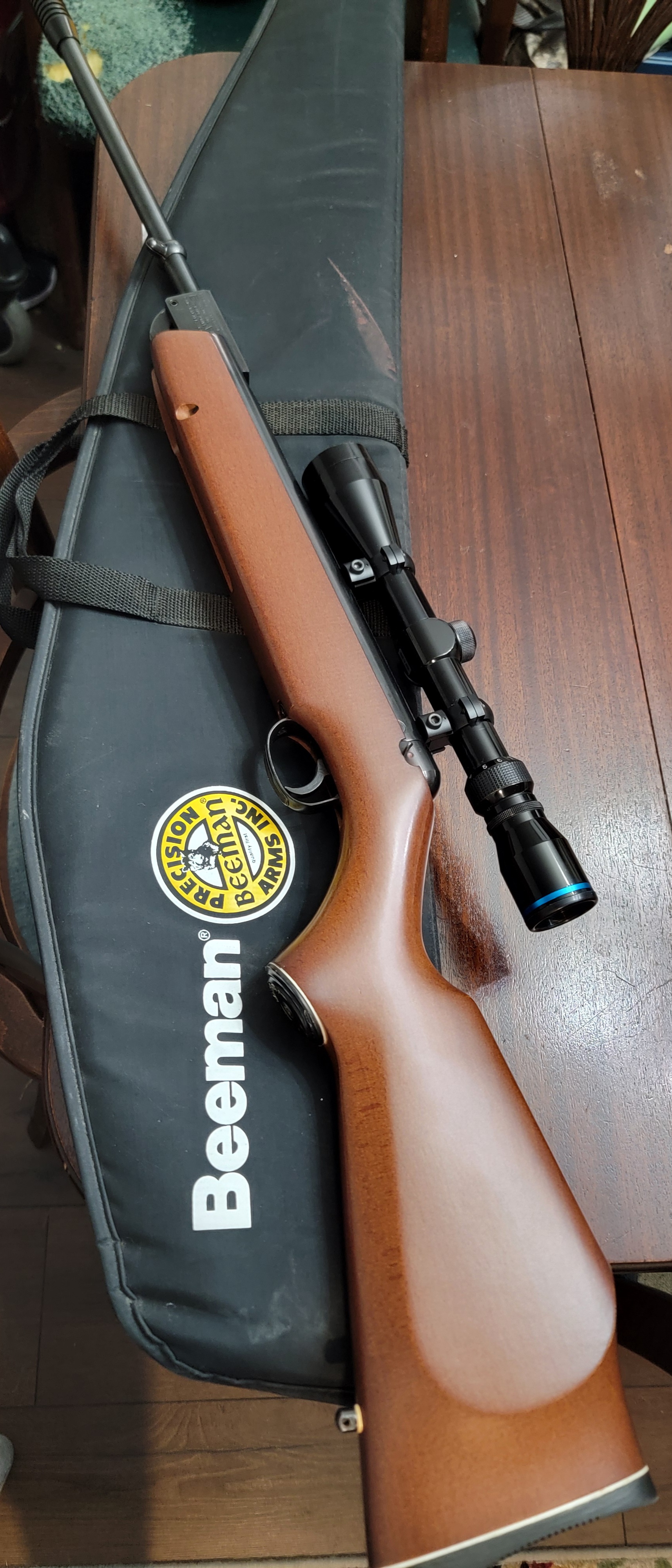

This Beeman Webly Vulcan is a .177.
The Hatsan 95qe in .22 is a dead duck.
All my other springers are .20 cal, so I needed a .22 to replace the Hatsan. 🤔
And the Legacy lives on with a respectable modern example.

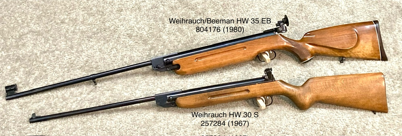

For the record, here are vintage examples of those two "thirty-something" Weihrauchs compared...obviously related, but definitely not alike.
The HW 35 weighs about 8 pounds, has a massive 35mm receiver tube with 30mm piston seal, and a manually-locked breech with a sliding thumb latch. Beeman's "EB" version combined the deluxe "Export" walnut stock with a 19-inch barrel (European version has 22-inch tube). When correctly set up, these older leather-sealed 35's can do 10 FPE or so; new ones can shoot a bit harder. A big, heavy, but perfectly balanced classic.
The HW 30 barely weighs 6 pounds, has a 30mm receiver tube with 25mm piston seal, and a simple auto-detent breech. This one pre-dates the Beeman R7, and has a slender finger-groove stock and light 14mm diameter barrel. Also has a leather piston seal, and is about a 6 FPE gun. I love the light weight and handling of this rifle. The current HW 30/R7 is a somewhat chunkier rifle with a plastic piston seal, greatly refined stock, heavier barrel, and better sights, but still the same basic action.
This 30 recently got rebuilt with a Maccari kit and the little dude is a total gas to shoot! The 35 is also newly cleaned, lubed, and deburred, but is a bit crankier and still a work in progress, lol...
