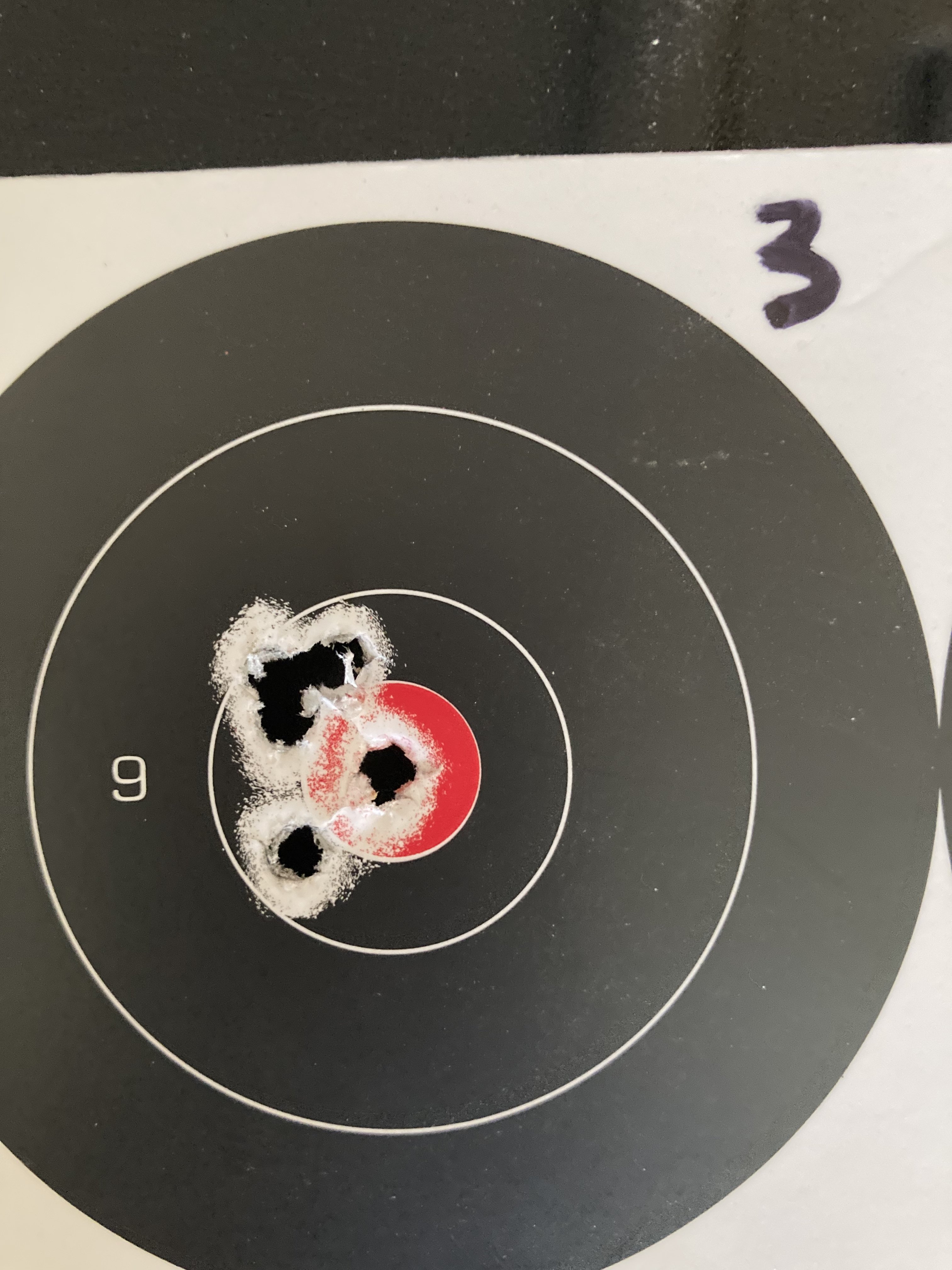

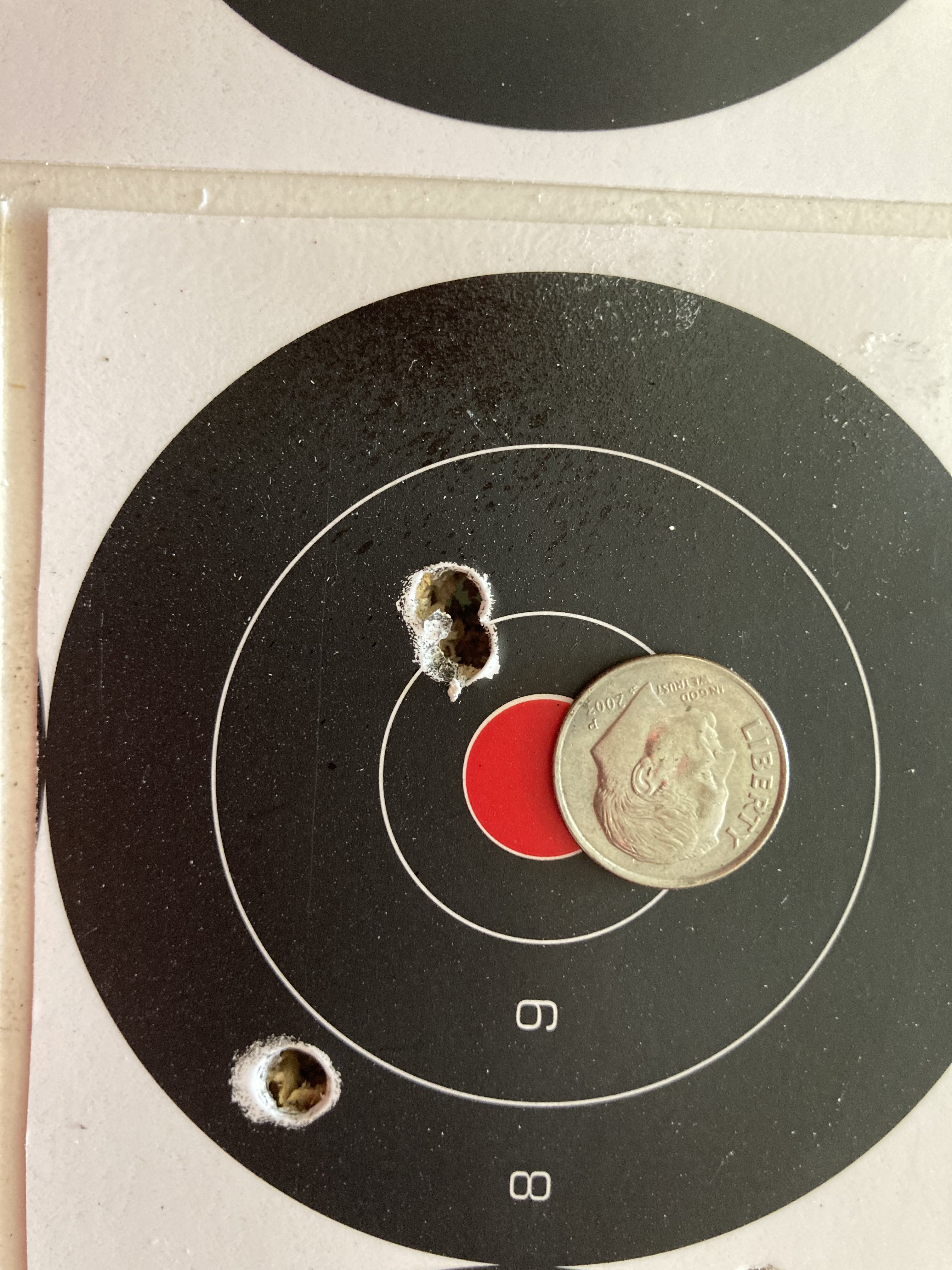

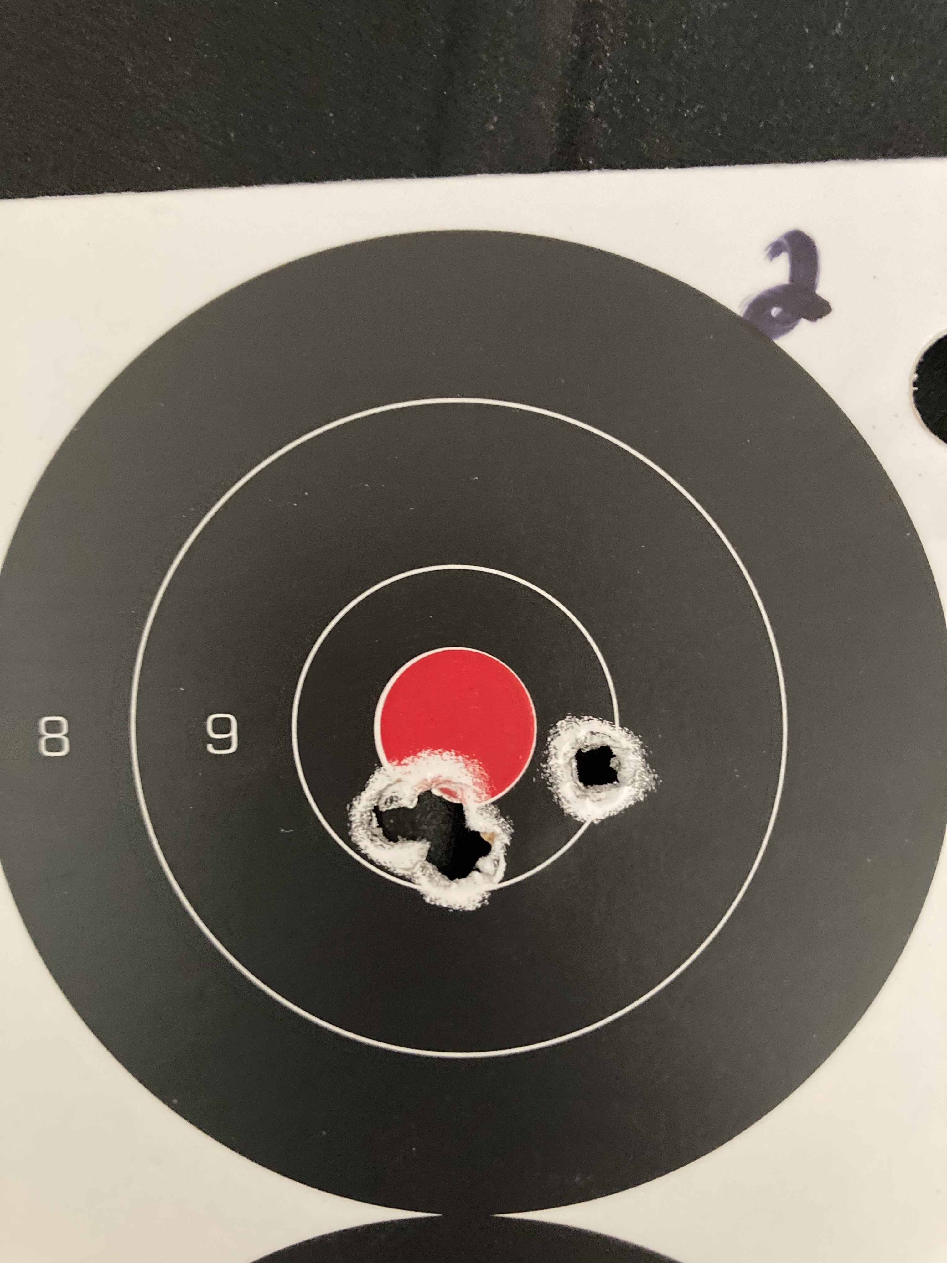

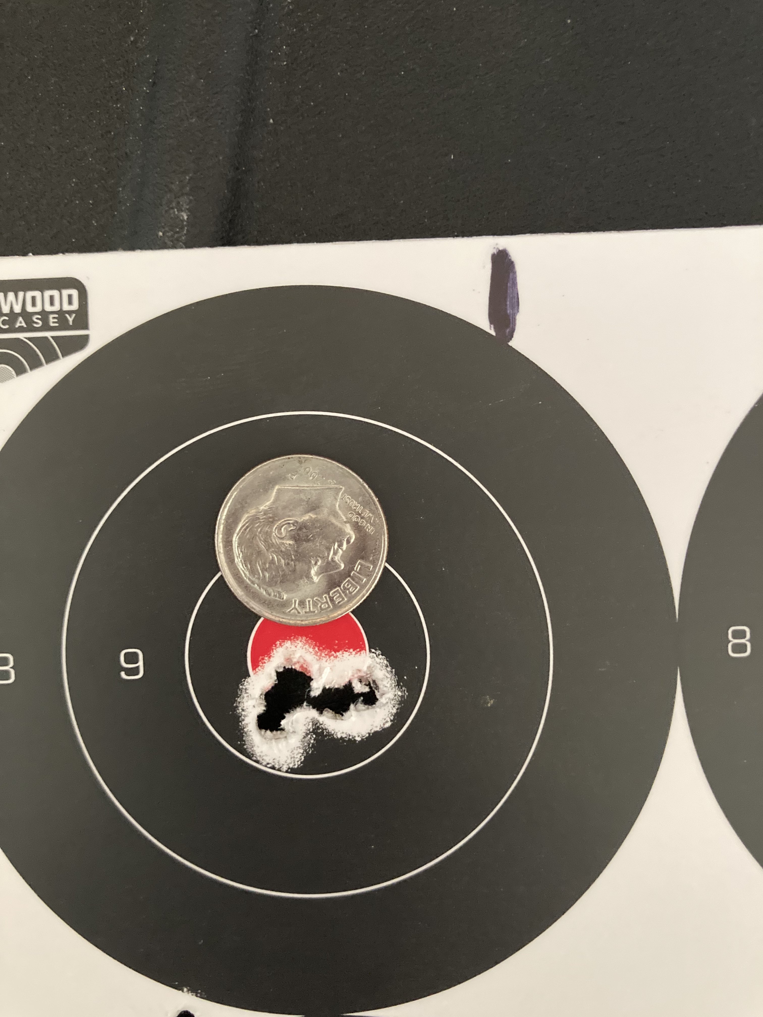

I had problems with my delta wolf not grouping at all with slugs so this morning I went out shooting and set my target at 25.5 y and I used the factory setting for 18g and set the speed to 1000 fps and left the reg set at 160 bar ( see pic 3)and it shot ok then I set the speed to 900 fps and the group was real good (pic 2 ) then I did a custom setting at 3000 u 65v and 160 reg (pic 1 ) so it does shoot real good with howler slugs but it took me a lot of trying to get it that way
Reactions: Centercut

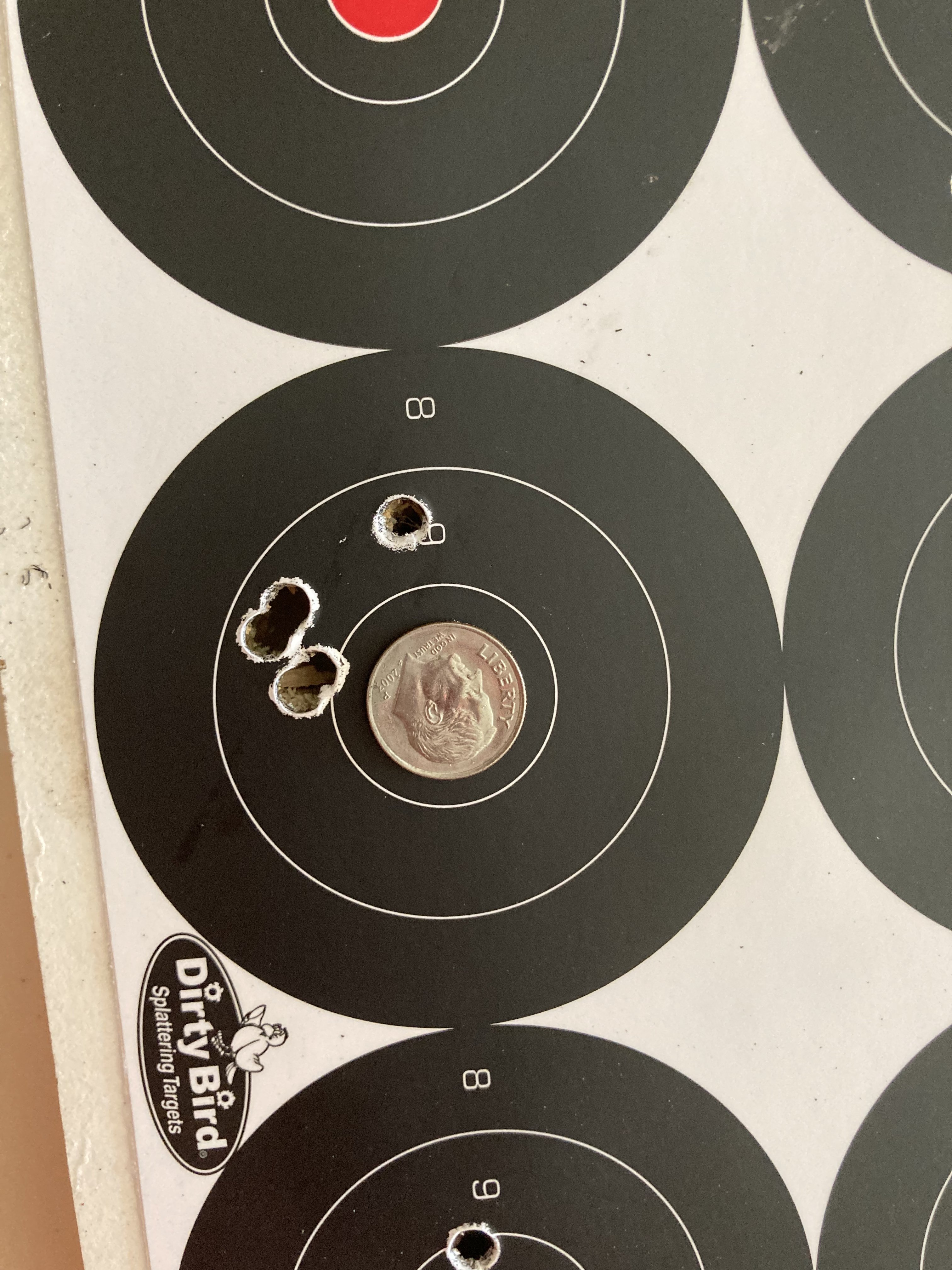

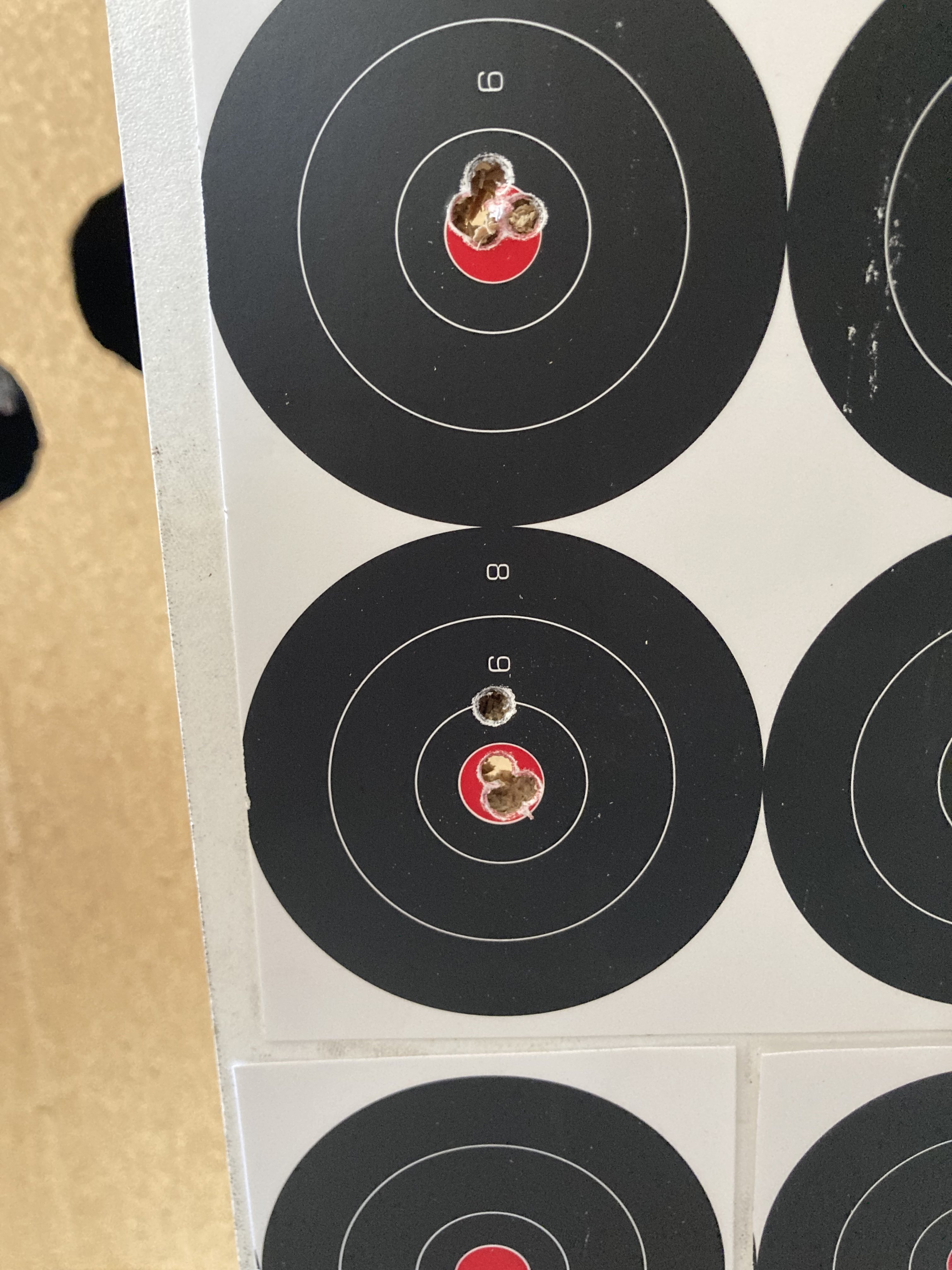

this is 25y with howler slugs , the gun was set on advance and the settings I used were 3000u at 68v and 160 reg , fps was 895 , if you go above 900 they dont shoot very good , you might be able to try 920 I have shot them at 950 and 1000 with bad groups , I have not tried heavy slugs yet , the groups in the pic are 5 and 7 shots
