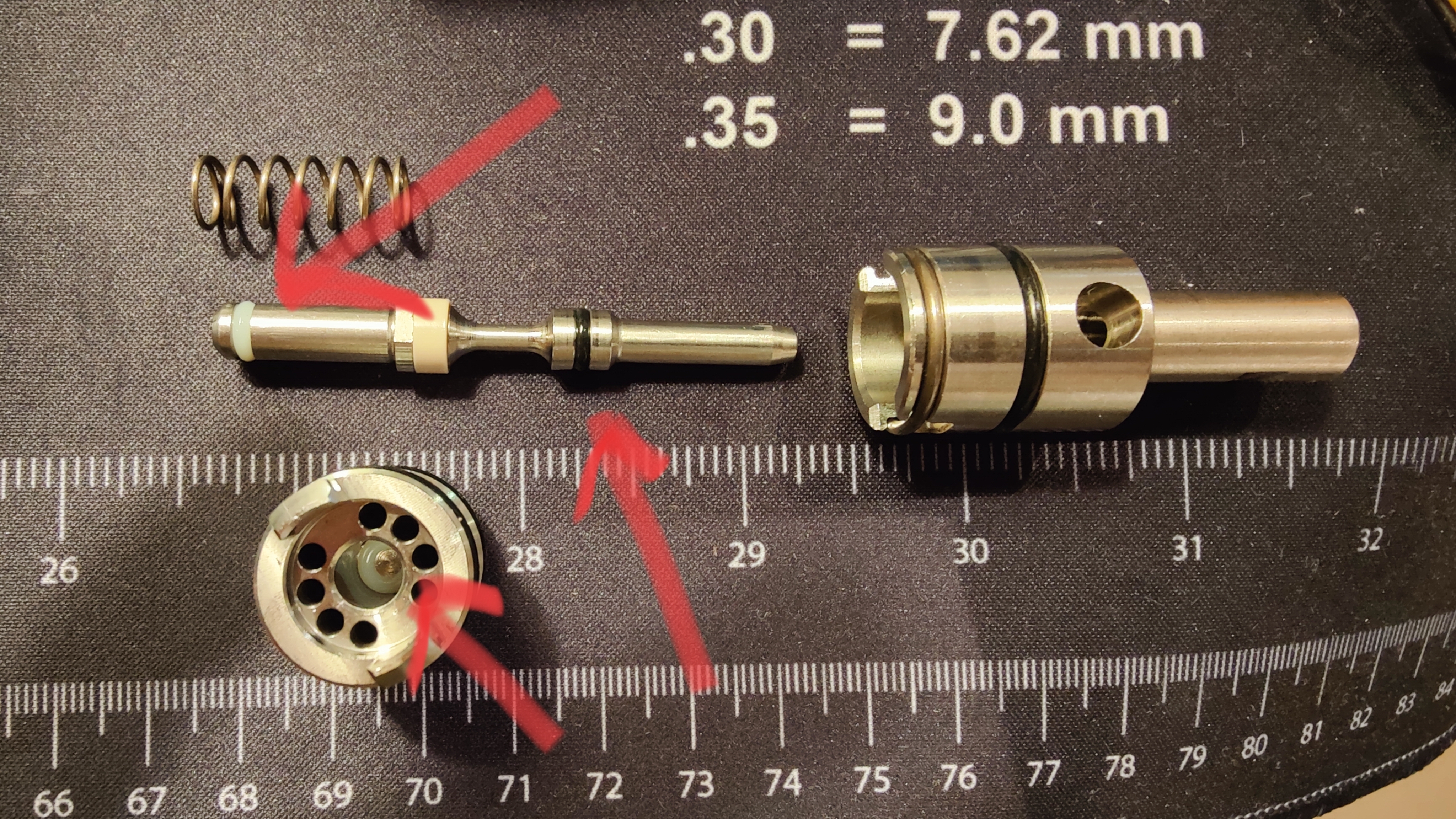

I have changed the o-rings on the valve pin and re-lubed the valve. But it didnt solve the leaking.
Can anyone tell me what to look for? I suspect a bad valve but everything looks good when I inspect it.
These o-rings are changed
I suspect the valve sealing might be the problem, but it looks good. The seating also looks good
Any ideas?

Also a careful look at the metal mating surfaces to the o-rings. Even a small nick or bit of debris can create a leak or cut an o-ring. Take the o-rings off and pinch them all around to see if there may be a cut somewhere that isn't seen at a resting position. Use a magnifier or strong reading glasses.

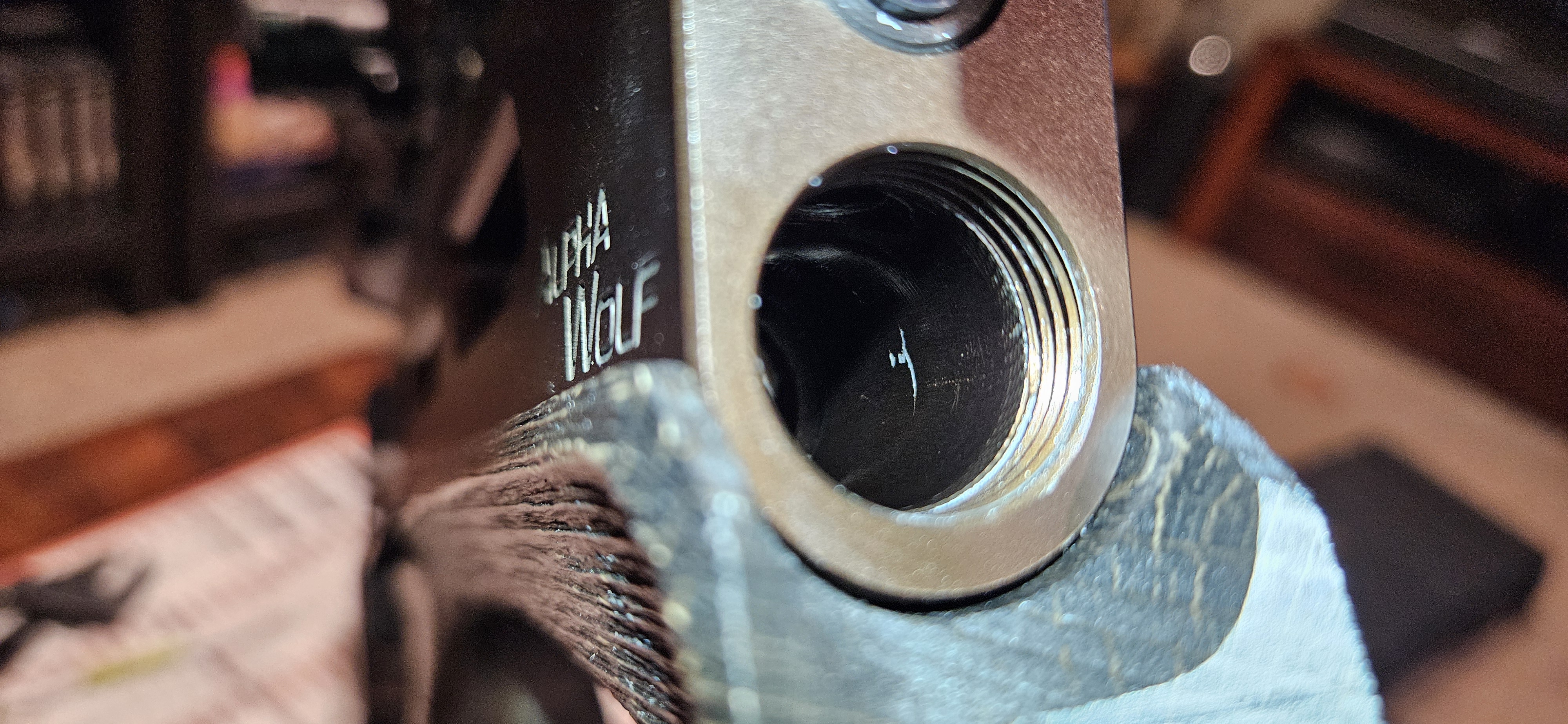

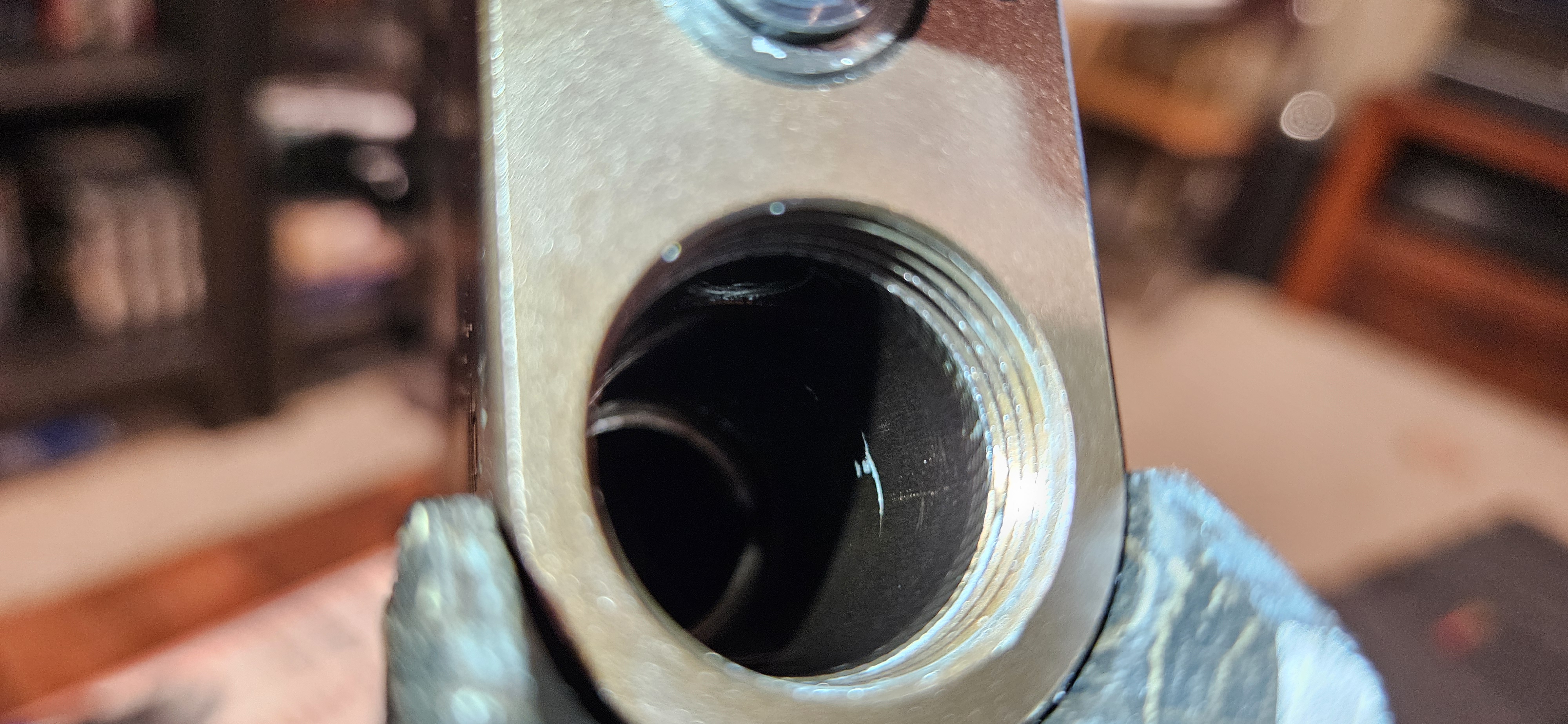

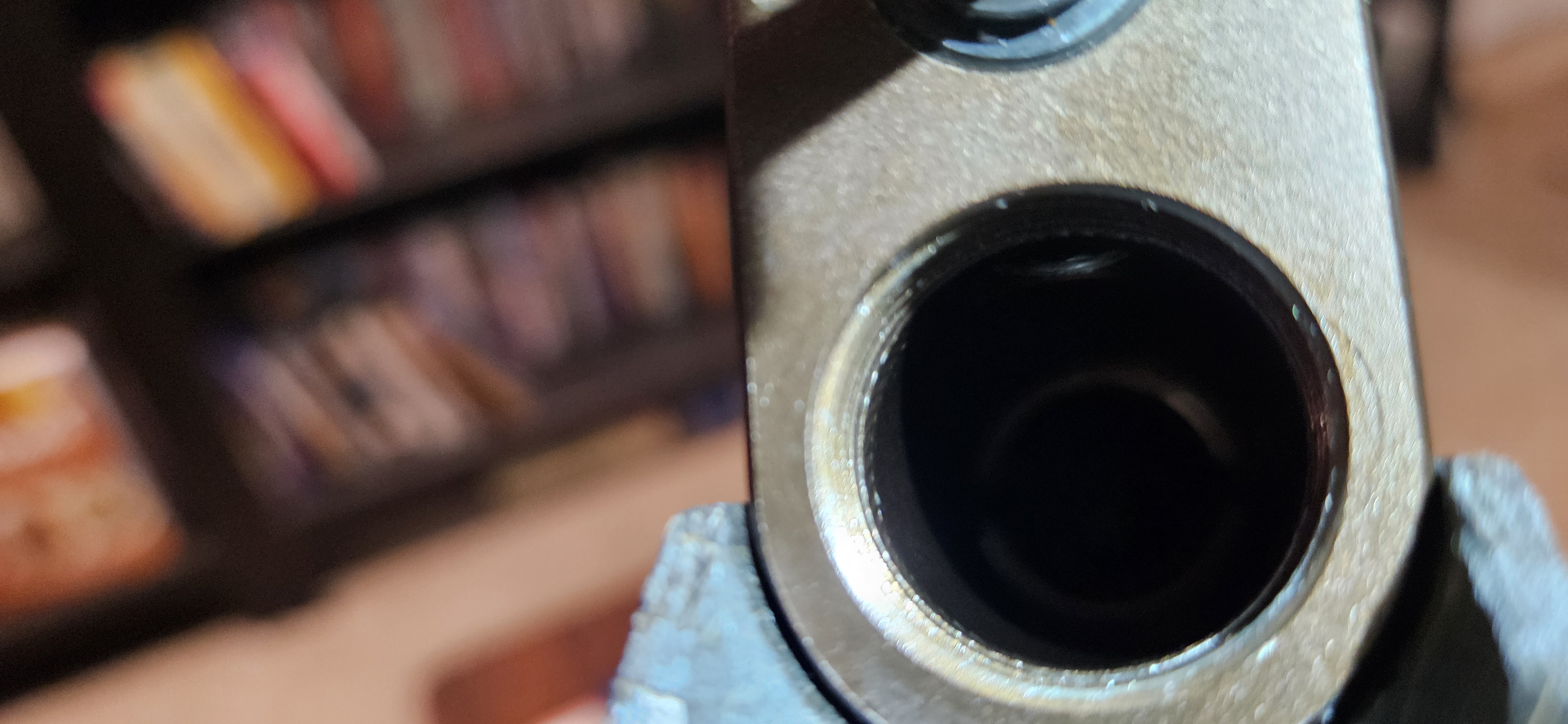

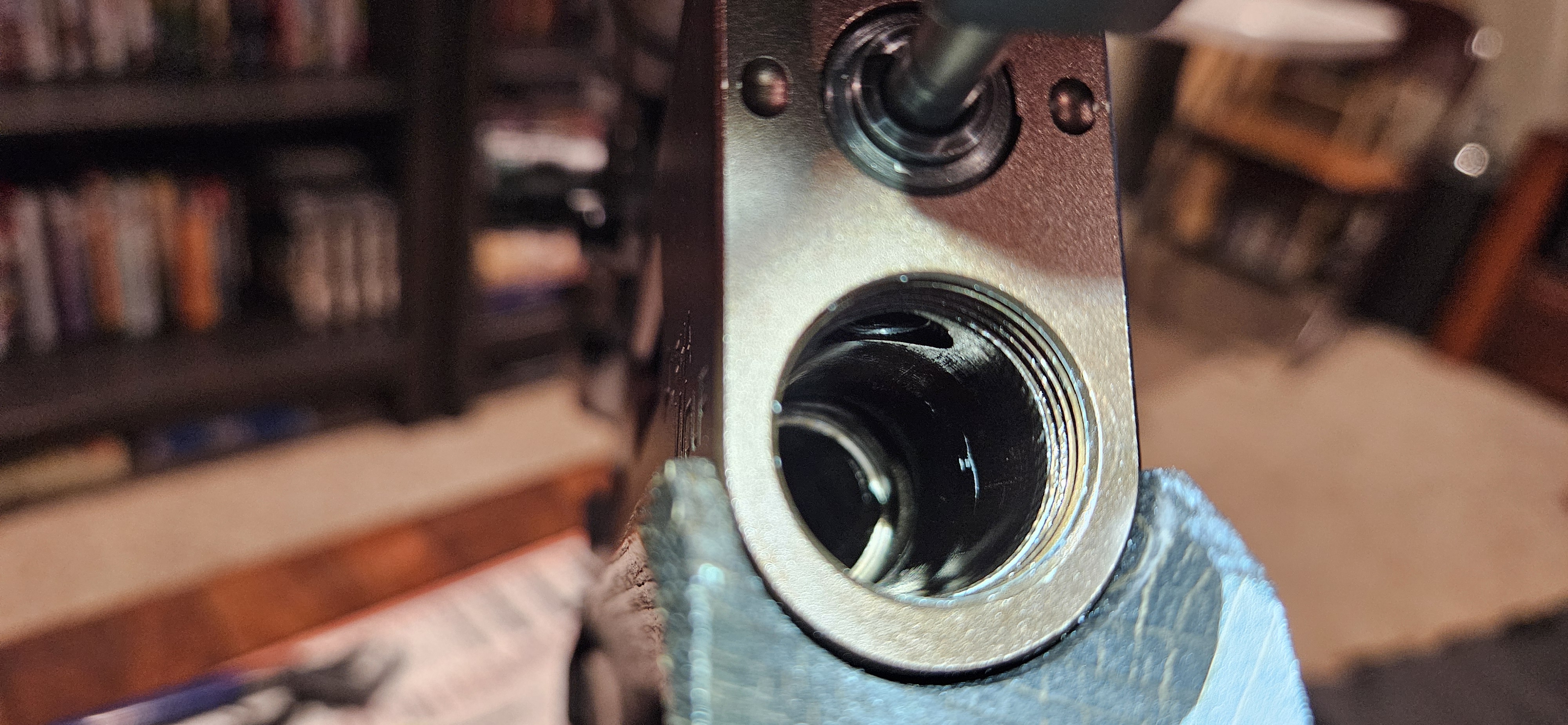

Inspect the block where the valve and regulator are inserted. I had two yes 2 alpha wolf safari's in a row with blocks that had deep scratches, and machine marks, that prevented the valve from sealing in the block. I ended up just getting a refund AoA was fantastic to work with. This is just a major Daystate QC issue that needs to be addressed.
Reactions: msg1979
That is pretty crazy. OP I would replace every single oring and seal in the valve. Not just the ones you point too.

Just checked the block. Its smooth and well machined.
I inspected all orings again and changed them
Its still leaking
It must be the valve seat or the valve seating that has a fault which cannot be seen with the eye

If you have not already done so, may I recommend cleaning the entire valve housing and, and replacing all the seals in the valve after lubing them? Sometimes they get dry and stop working. Since it was not leaking before, I would assume this is a seal issue rather than a badly machined housing (then again you’d never know ☹️, you’ll have to eliminate common culprits).

Yup the valve seat is bad. You got two choices, either send the whole thing back to AOA, or explain it to AOA and have them send you a new ultra valve. Since it seems that you don't have a problem troubleshooting and working on your own PCP I'd request a valve and replace it yourself that way you'll have spare parts. Worst caseif that still doesn't work you can send it back.
