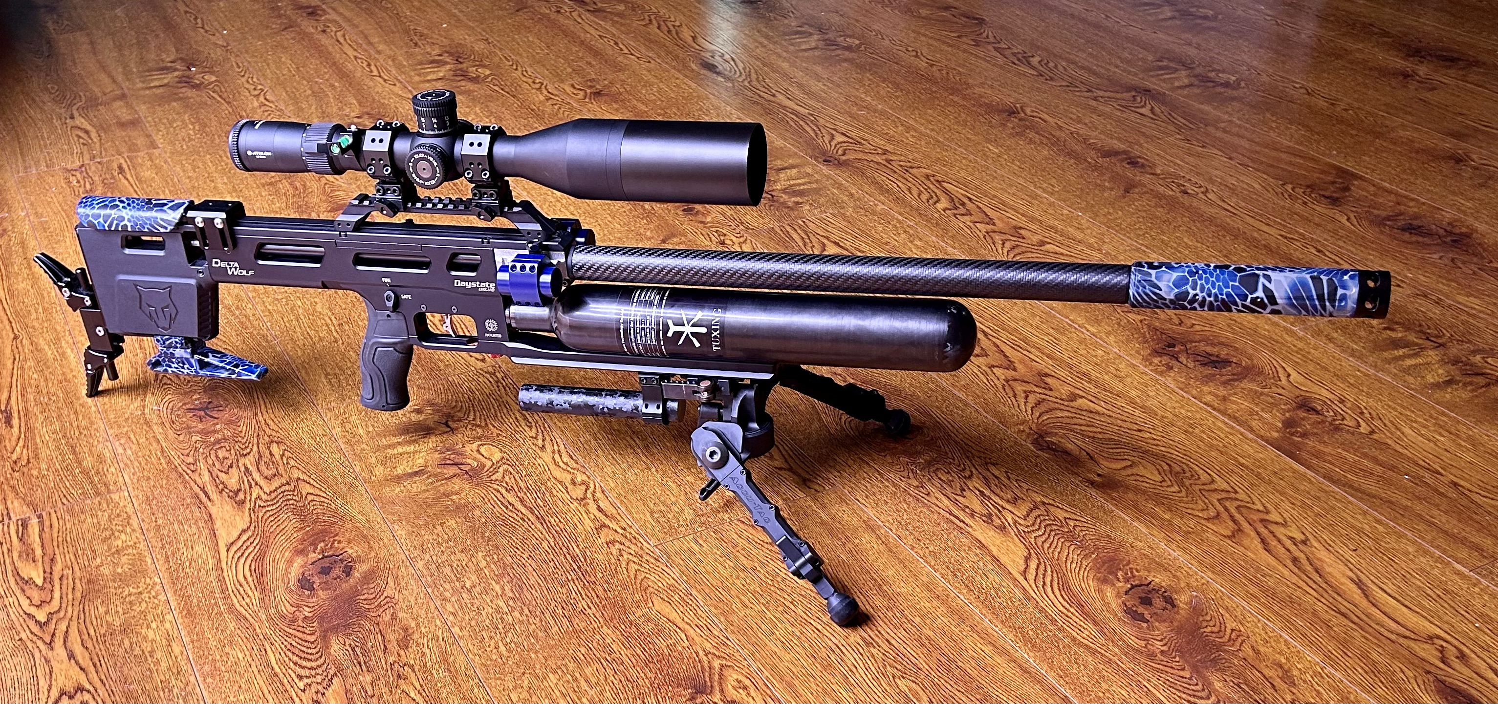

I sure do like my Delta Wolf. It’s come a long way with a lot of factory upgrades installed as things have improved. Of course, I must do my own tweaking as well. His name is Daddy. Shoots the .30 56gr Zan pellets so very good!
