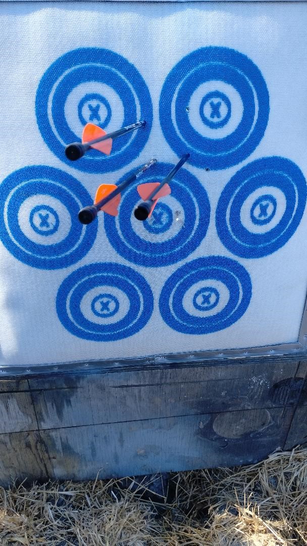

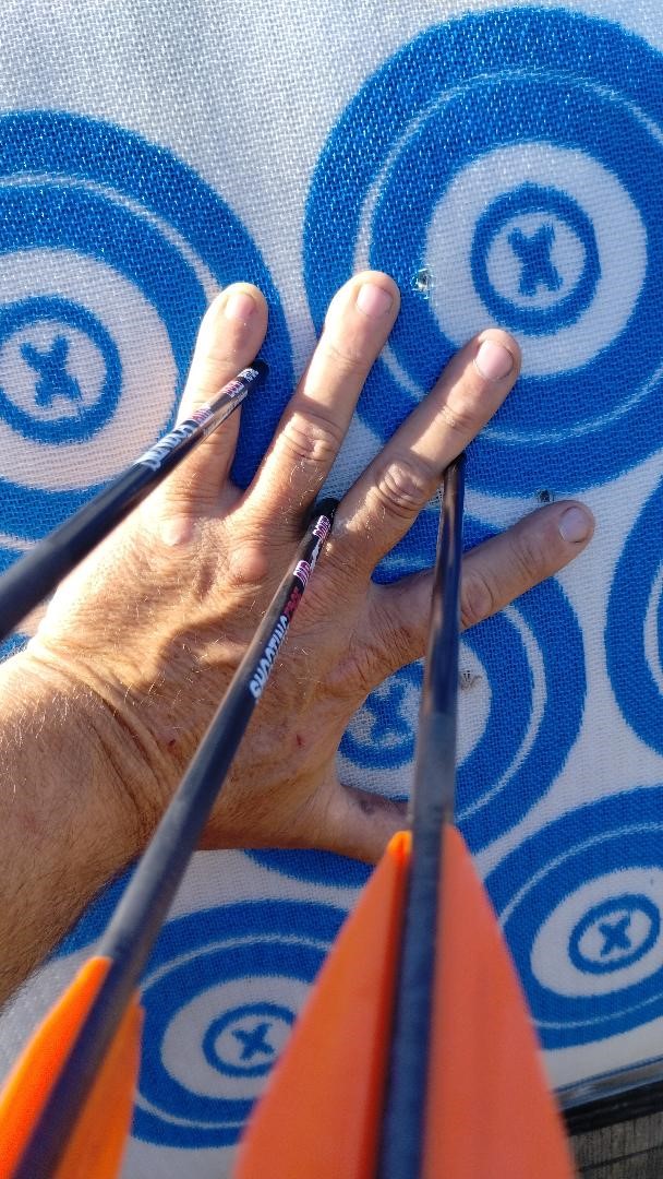

So, the 24" Spyderweb target is as good as advertised. It stops my bolts cleanly and efficiently. It allowed me to shoot some groups through the chrony and watch both the accuracy and the speed. First time I've ever been able to shoot a group at a target.
Filled to about 2600 psi and did two 3-shot strings without refilling. After the six shots, the air dropped to @ 2100 psi. I did not tether nor use the regulator as it doesn't seem to be necessary. Shots are very consistent from 426fps to 431fps. The best grouping was the last three shots with lower air pressure, and those were also the faster ones.
All shots taken at 40 yards with 100 gr. field tip and using 1/2 power. I'm curious if 125 gr. tips will increase or decrease accuracy. Next session I'll do a comparison and post it.

To summarize and helps others, using a 450 fps and lower-rated target WILL NOT WORK. If penetration goes to the fletching, it's over and you can take another $25 and throw it away. Speculating on what COULD work or what MIGHT work is expensive and time consuming.
I can verify that the Spyderweb is suitable and does the job. Not cheap, but this hobby is not built for those who pinch pennies. Guns. crossbows, etc. that generate that kind of speed and power are expensive. Once you pass the $1000 threshold and keep climbing, why 'fight' using subpar or homemade (i.e. you do all of the r&d on your own budget and time) contraptions. If one can afford the gun and the arrows, he/she can certainly afford a suitable target. My advice is save your money and buy the RIGHT one, and not end up with 2 or 3 that don't work before you have to buy the right one.
As far as pulling them out of the target, it's a bit difficult but that's because I have a 'gap' between the field point and the shaft that hangs up a bit. But considering what I went through before I can manage that or put some on electrical tape or something to soften the 'barb' on the lip of the shaft.
I would LOVE to shoot actual broadheads at some point, but I'll have to do a LOT of research to find a foam block that can handle the force. For now, I have enough to 'worry' about just fine tuning my groups using tip weight and air. Once I have total confidence in that arena, I'll expand out to practicing with broadheads. For now, I'm just thrilled to be able to have a target that I can actually use.
