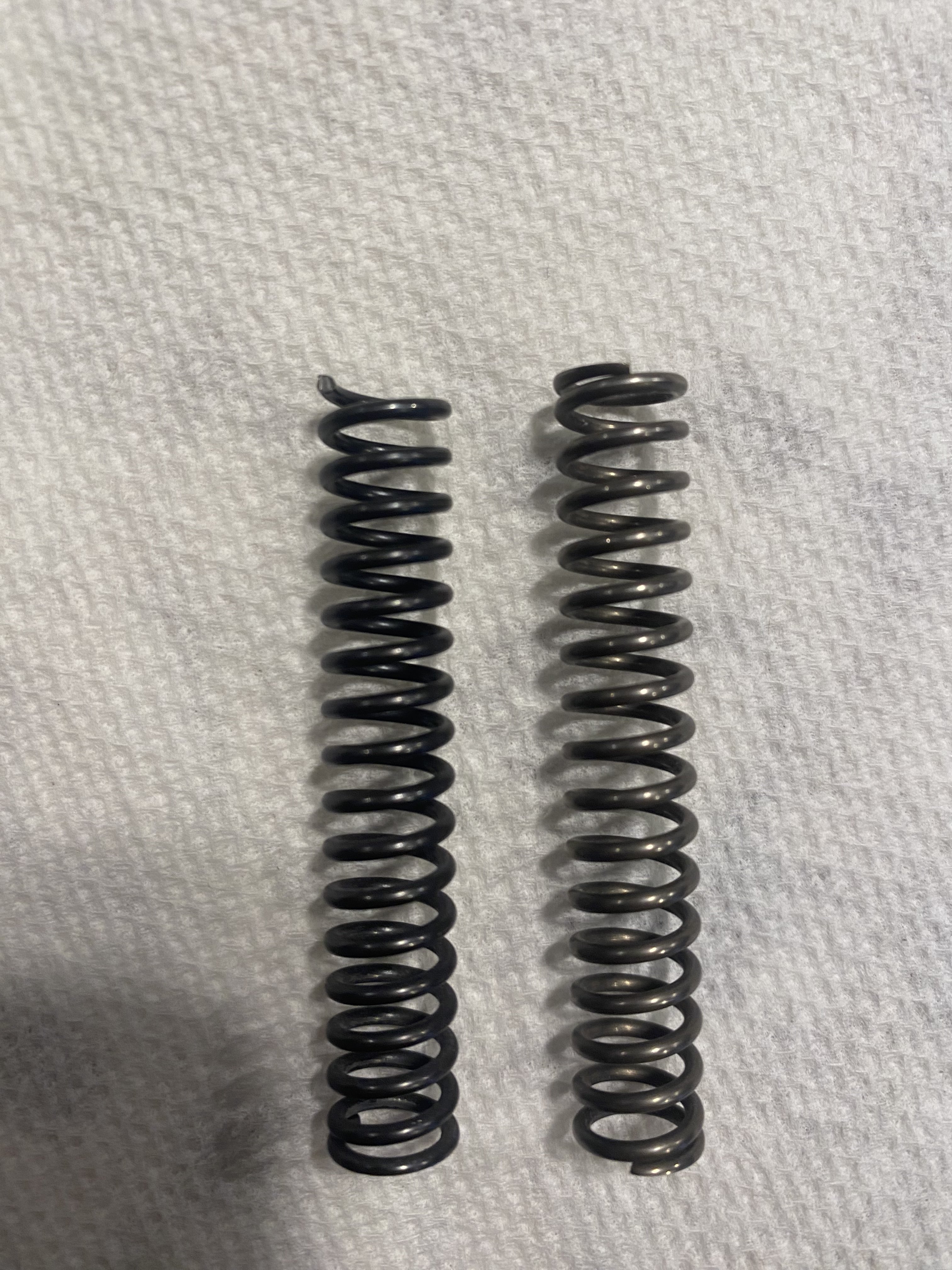

I had a similar issue with my first crown. Turned out the hammer spring was broken, and causing my spread. It’s not an isolated case also. There have been many crown owners with similar issues caused by a broken spring. Mine was broken straight out of the box. Others have been also.
I would take it apart, and pull the spring. See if it’s indeed broken. The crown is one of the easiest rifles to tune well. Once my spring was replaced, I was shooting monster redesigns at 950fps with a sd of 2.4. That’s the kind of consistency you can expect from your crown when working properly.

here are the spring next to each other. Broken on the left.

here are the spring next to each other. Broken on the left. View attachment 334346
wow, just that tiny bit broken. i know mine is good, i had it out and cleaned up the edges on it. I wanted to check for things like this in case it was something obvious. Im learning FX and in my tearing down, i like the simplicity compared to the Impact and such. I wanted simple.
