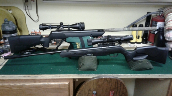

So here are my synthetic siblings, courtesy of Crosman/Benjamin...
.177 F4 in the front, .22 Summit in the rear. Both destined for a tear-down and home tune, my first effort at doing so. With the reduced power and velocity, the F4 is almost as quiet as the Summit. Two backyard friendly air rifles. I am blessed.

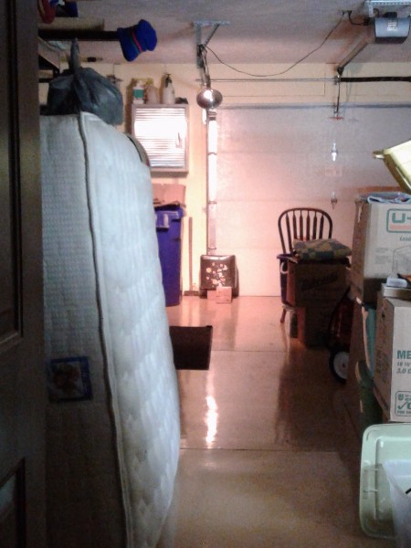

I have 10 meter lanes set up both inside and outside so I can shoot regardless of weather. Tonight was an inside night and I decided to push myself on accuracy. Very glad I did!

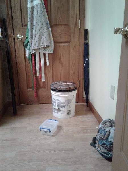

Here is my shooting spot, between the door into the garage and the inner utility room door. Sitting on the 5 gallon bucket and propping my left foot up on the clear plastic container to raise my knee to optimal height.
My shooting lane. Ignore the mess - still sorting out stuff from the downsizing move made in August.

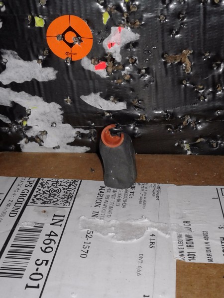

That grey box against the overhead door is filled with twenty pounds of shredded rubber mulch and then wrapped in duct tape. It is a great pellet trap and I can paste targets to it in any fashion. I also stick bottle caps to it using duct seal putty, or place targets in front of it. For my shot of the night I used the latter strategy and placed a wire nut in front of it atop a small column of putty.
The photo above is immediately after my one shot from my 'bucket seat' at 10 meters. The nut is 7 mm in diameter, the .177 Vortex Extreme 8.18 gr pellet is 4.5 mm.
It's not sub-MOA shooting at 100 yards but I figure we all need to start somewhere and I'd like to see success and growth in my shooting as I work my way outward. And honestly, having 'tuned' a $70 break barrel as a first-timer and then getting this kind of result has me pretty jazzed.
