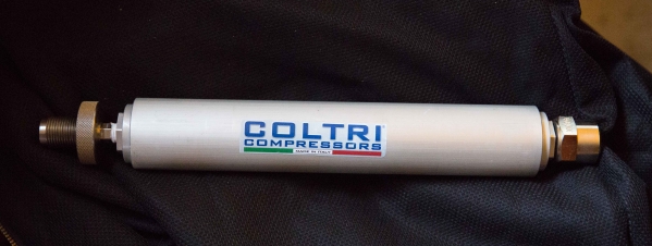

Here is the one I just bought for my Coltri compressor it uses the same cartridge you are showing. The cartridge does not fit tight it just drops in. I don't have a measurement but I would say there is an 1/8 jn gap between it and the sides
