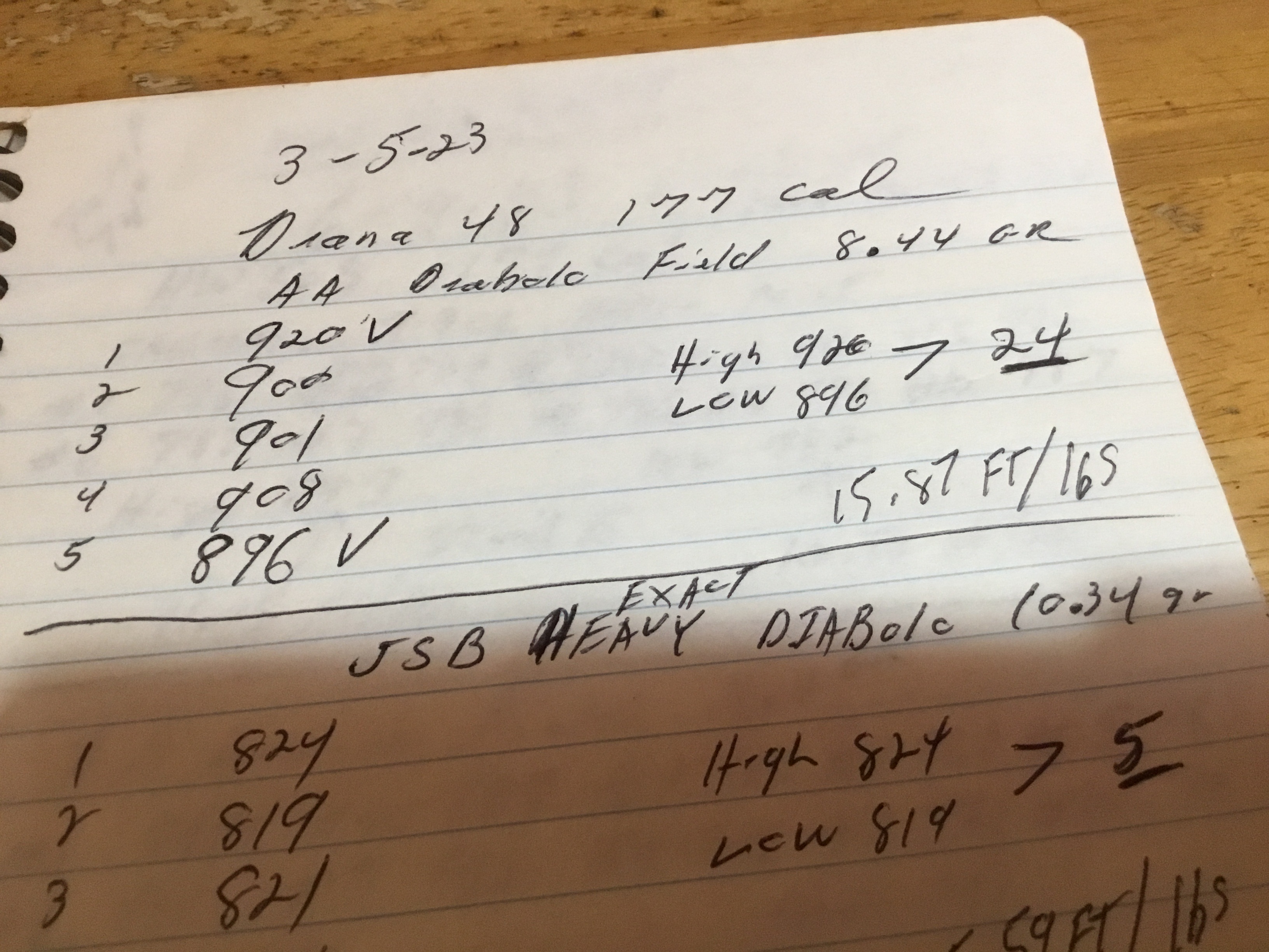

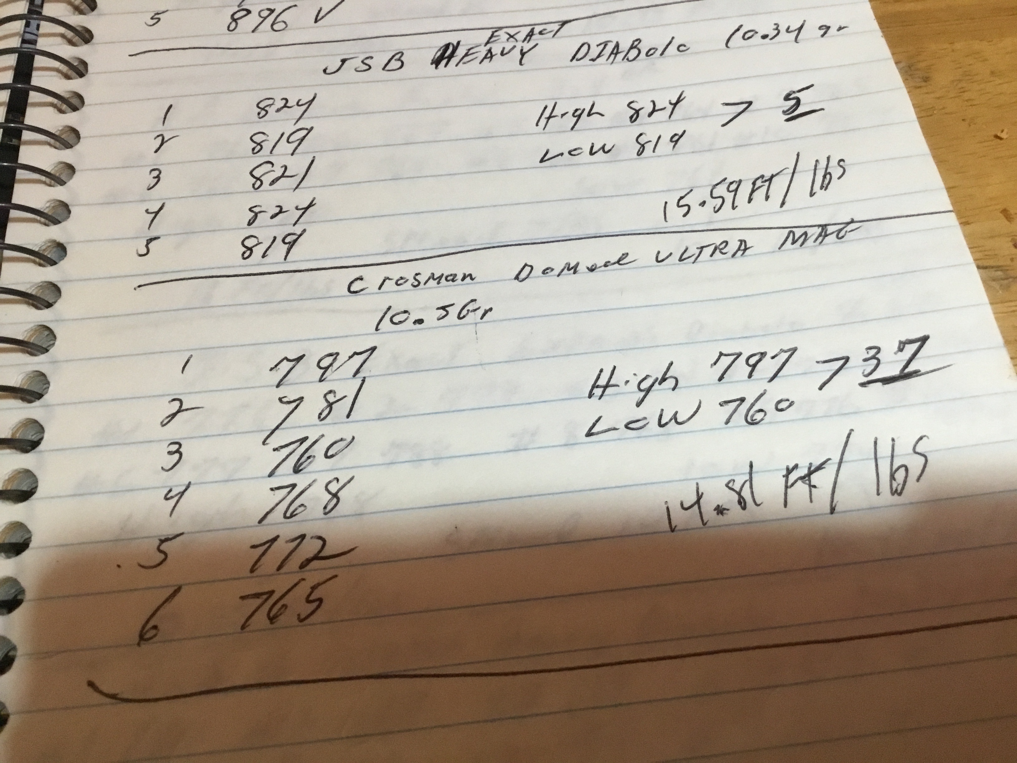

Well don,t have factory mine after a vortec kit
Reactions: Deadeye Dick
