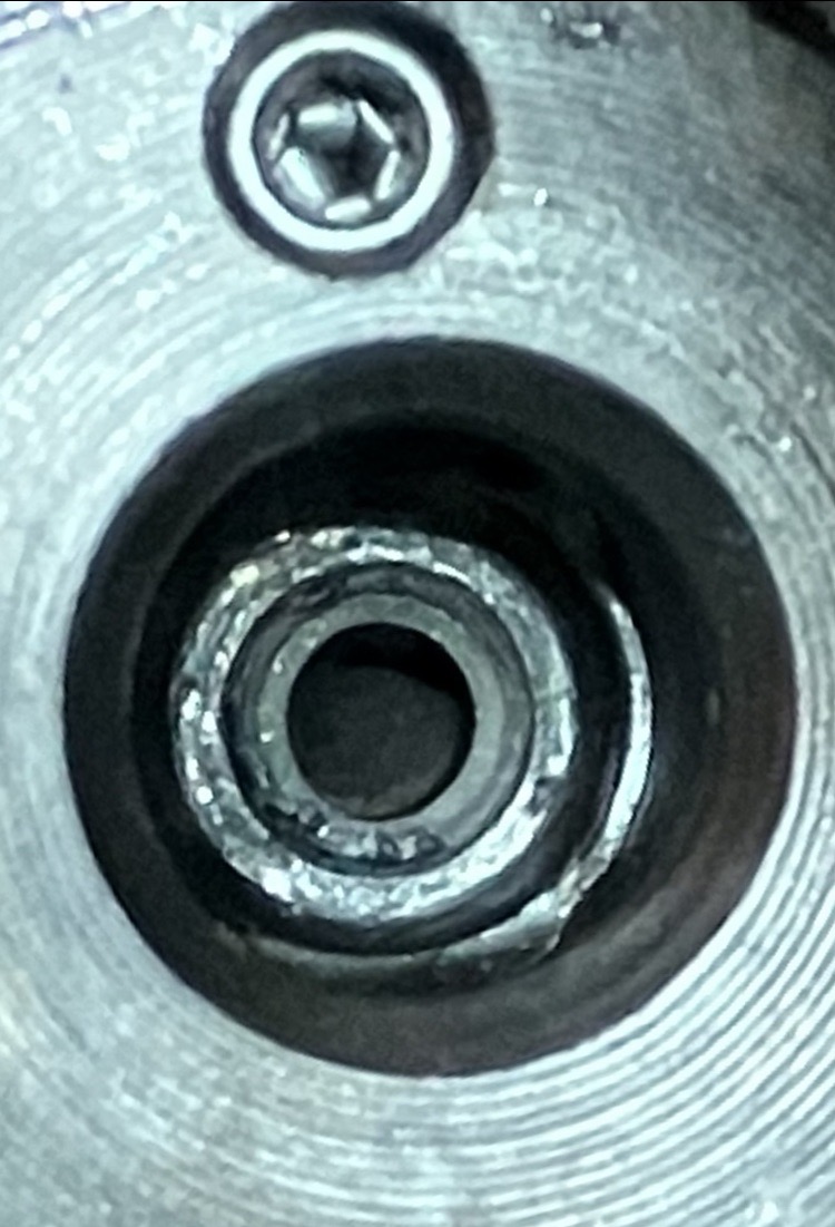

That gun in new condition should make 20+ FPE with just about any pellet. Could be tired spring, but my first guess would be breech seal. If you’re worried about it get either an ARH breech seal or one of the “new” blue Diana ones. You have to take it apart to do that so you‘ll be able to inspect everything.

Got a good pic of the breech seal, looks like damage at 6 and 8 o'clock

Diana mainsprings last around 3500 shots - any old-ish gun is suspect for mainspring fatigue / breakage. Aftermarket options are way more durable and readily available.
Piston seal fit is critical for performance: a piston seal just a hair too tight robs a couple hundred fps just like that. Vortek seals in particular need hundreds of shots to start shooting like they're supposed to.
The sidelever Dianas are sensitive to both breech seal condition and pressure. Adjusting the sidelever for proper tension giving the breech seal proper pressure against the breech is critical, and mandatory after replacing the breech seal.
