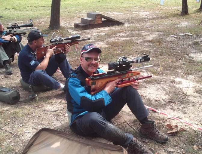

I believe Ray Apelles used a bullpup Diana side lever in FT competition very successfully.
I would love to see a commercially available version.
looks like a 48/52/54 or possibly a 56? someone probably knows for sure but either way it is the same action..48 is the same as 54 but the 54 has a rail recoil reduction.. the 56 doesn't have open sights..
the one he is using must have something different as far as the shroud because I have not seen a silver one.. I like shiny so I was disappointed that the stainless version of the P1 is only the frame 🤣🤣 id want the whole thing silver 🤣🤣

I have shot in a match when Ray was using that rifle. It's a 54 but is so heavily modified it might be hard to call it that now. It has a solenoid trigger and battery system that cranks the weight up to about 20 lbs. with the scope IIRC. I think with the mods he did he had to abandon the recoilless action which went against what he was really hoping for (again IIRC).

Putting a 48/52 into a bullpup stock is not difficult, the linkage to the trigger is simple and the saftey is not effected.
I wouldn’t use a 54/56, too heavy (I have one of each).
The difficult part is going to be fitting the scope mounts, it would need to sit over loading port.
I think the rear sight assembly has screw holes that may be used.
