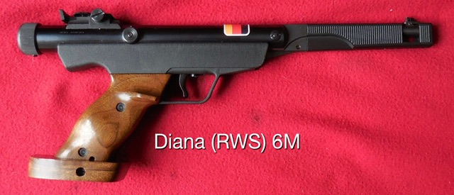

I have a 6M.
If the barrel is cocked, it cannot be fired.
The trigger will not do anything.
It is quite likely that the seal has gone bad due to age. I have a Beeman(Diana) original 6, I think the same gun but with different stock and had that problem. It was actually discharging small pieces of the seal into the barrel.

the simple answer is the pistol needs a complete rebuild
i bought a model 10 that the piston was seized up the tube, so the barrel was loose
grips are not a problem Vernon Austin can make grips for them
so very model 6 or 10 that have factory seals in them need to be rebuilt plain and simple
the front seal crumbles and turns into a real mess and for of us that have rebuild these pistols a mess is an understatement
as for the rear seal it never shows the same effects but needs also to be replaced
