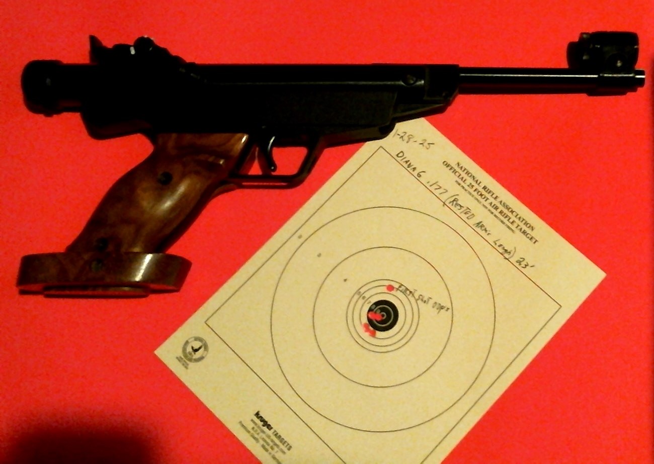

Shot this Diana 6 today . Indoor target 23 feet , a bit stiff to cock but what a shooter ! (maybe build some sort of rest with a hydraulic ram to jack that barrel ?)
I have one of the Beeman "original 6" models, one with the big heavy plastic stock. I wish it were like that. Be careful as that front sight is rather fragile, at least mine was. Plastic and it cracked. I finally found one that would fit the factory dovetails on the barrel, but it is a little high so I had to file the front sight post insert down some, so it does not appear centered. At least the gun shoots good, off a rest accuracy is about like that. That Giss system is so smooth.

Wonder if the old Crosman 411 front and rear might fit.

are they hard to cock, well yes and no
they have a short barrel and a cocking aid would be a great addition but at 29 LBs of Energy to cock not bad, a Hatsan model 25 is 59 LBs
