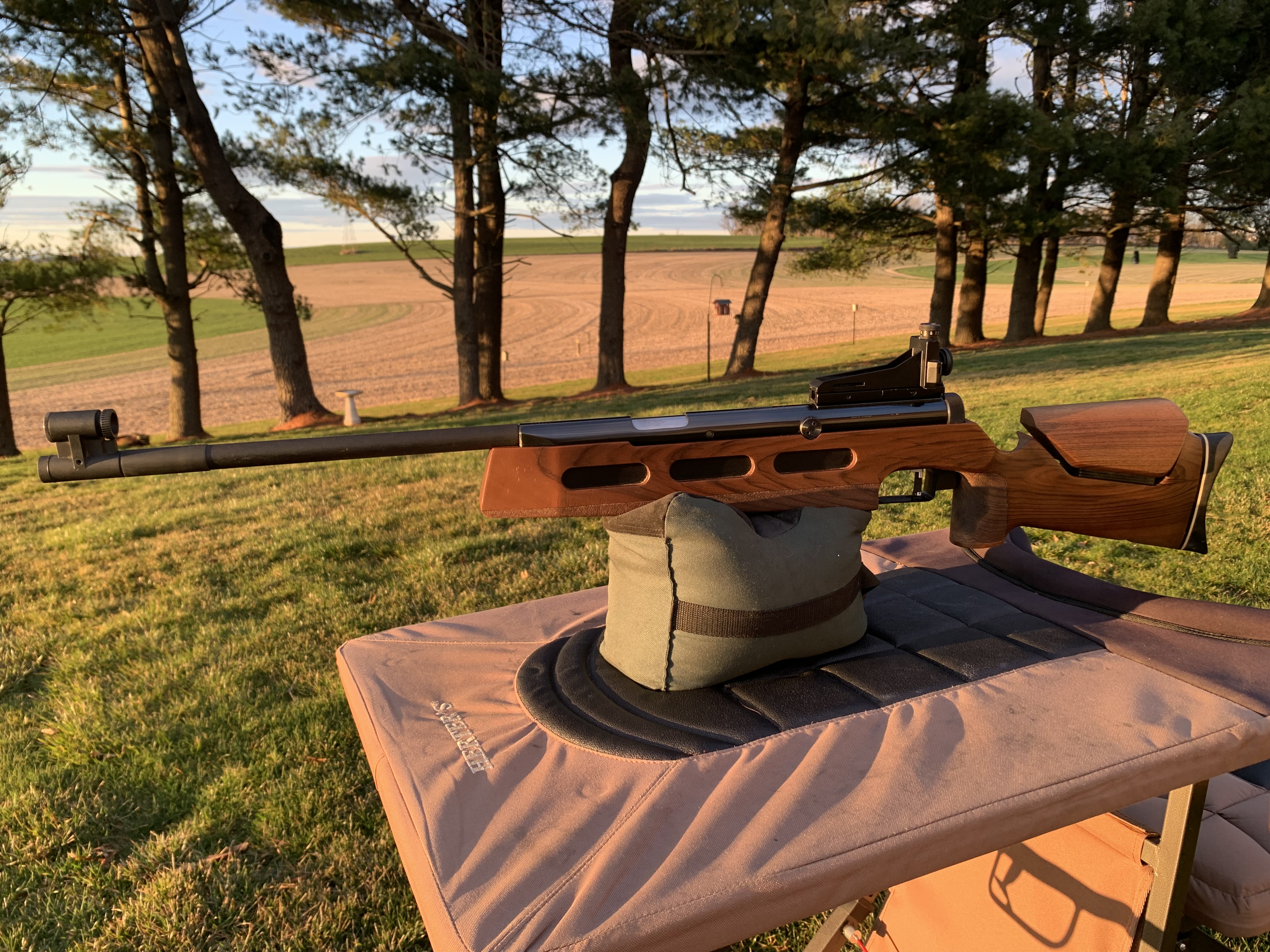

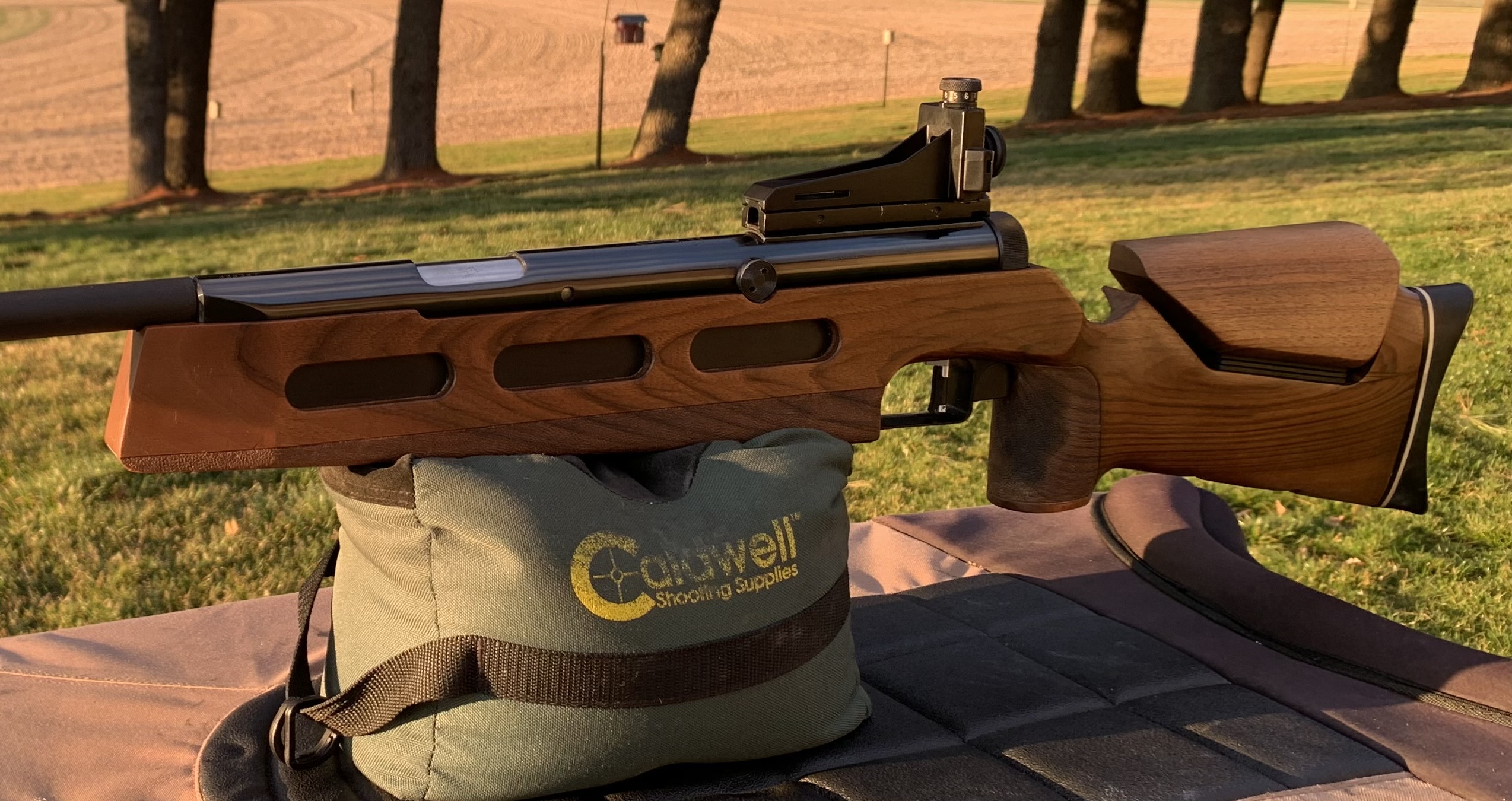

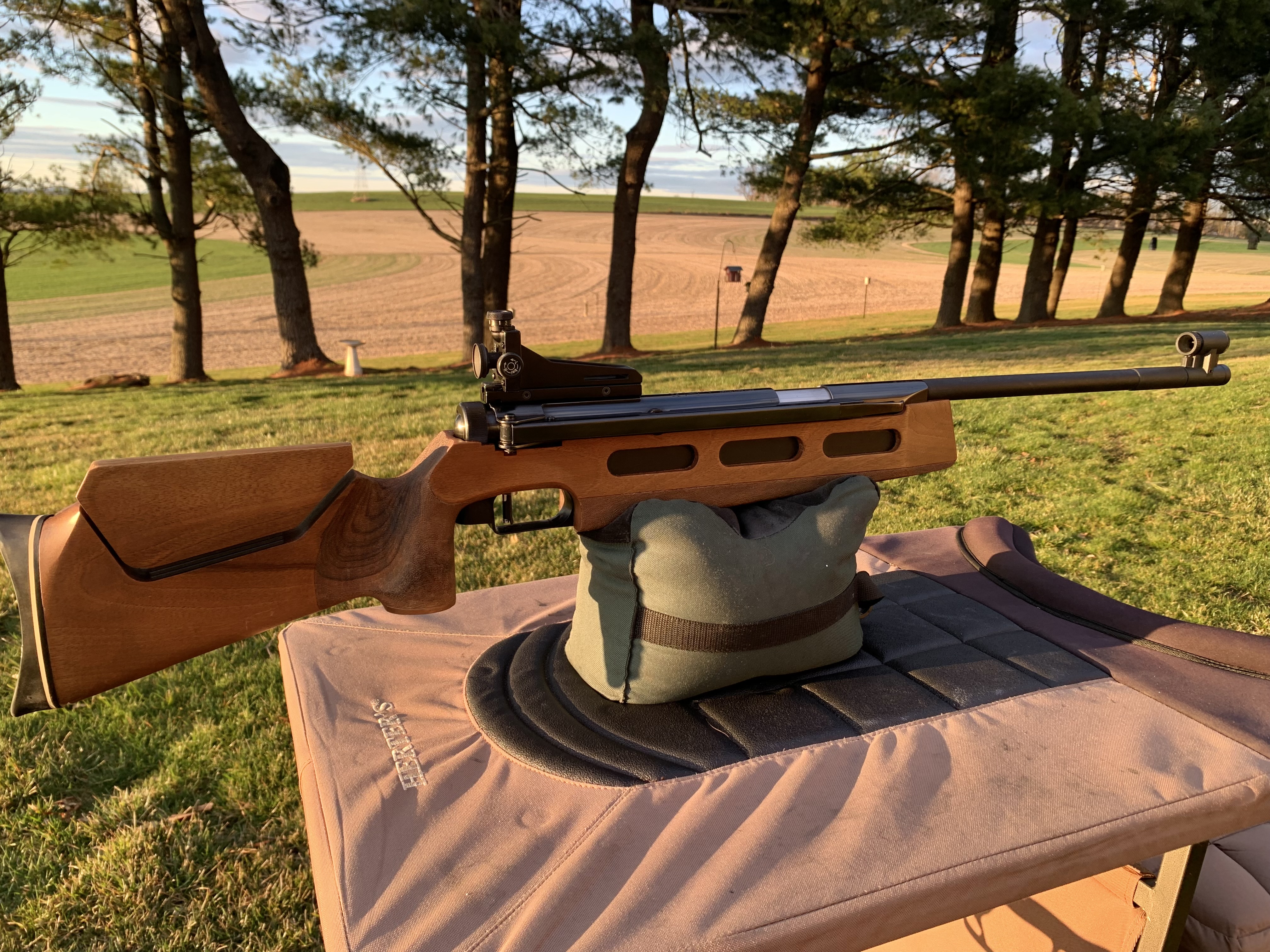

After JEFFPPC gave me the report on his Diana 75, I decided to begin my search for one. I lucked out and CT Airguns had just picked one up! It needs seals, but for a 40+ year old rifle it is in great shape.
Thank you JEFFPPC for the tip on the D75, and CT Airguns for having one available.
I’m looking forward to getting this old classic back on the range.
Steve

WOW!! Jealous, now I would like to have one!!!

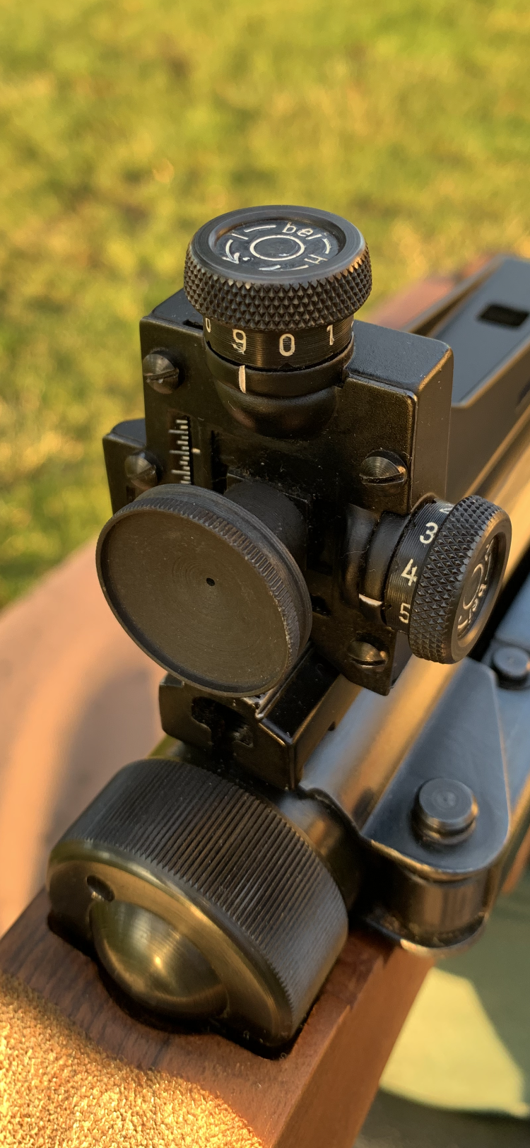

I was able to get the missing pieces for my rear sight, so it is now fully functional with factory parts. I would be interested in gathering any other bits that the HV’s would have come with.
Steve

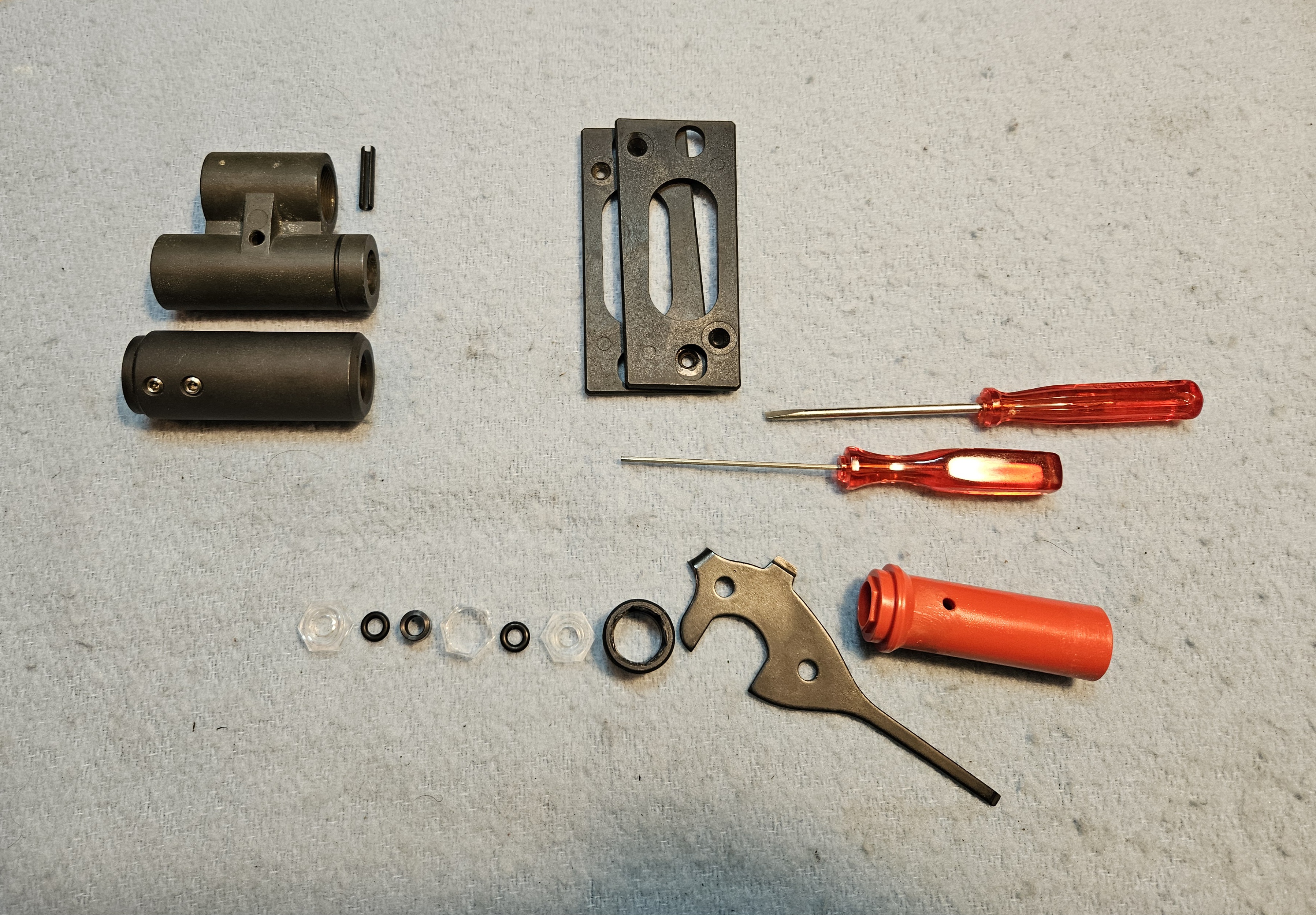

As I recall with my personal HV
Manual on rifle, another for o-ring front sight set up
Sight tool for front insert changes ( Red Plastic )
Sight post inserts of several widths, Posts as well circles, Crush o-ring insert & required parts.
Alternate height Low FRONT sight housing w/o any guts, Rear sight riser rail ( mounted as delivered )
Test Target, 2 small screw drivers and that weird multi wrench.
The photo shared on page 3 IIRC was pretty accurate outside the added different front sight housings on the HV's
No extra seals, springs or internal service parts as i recall. ( Damn man it was 1982 ) :ROFLMAO:

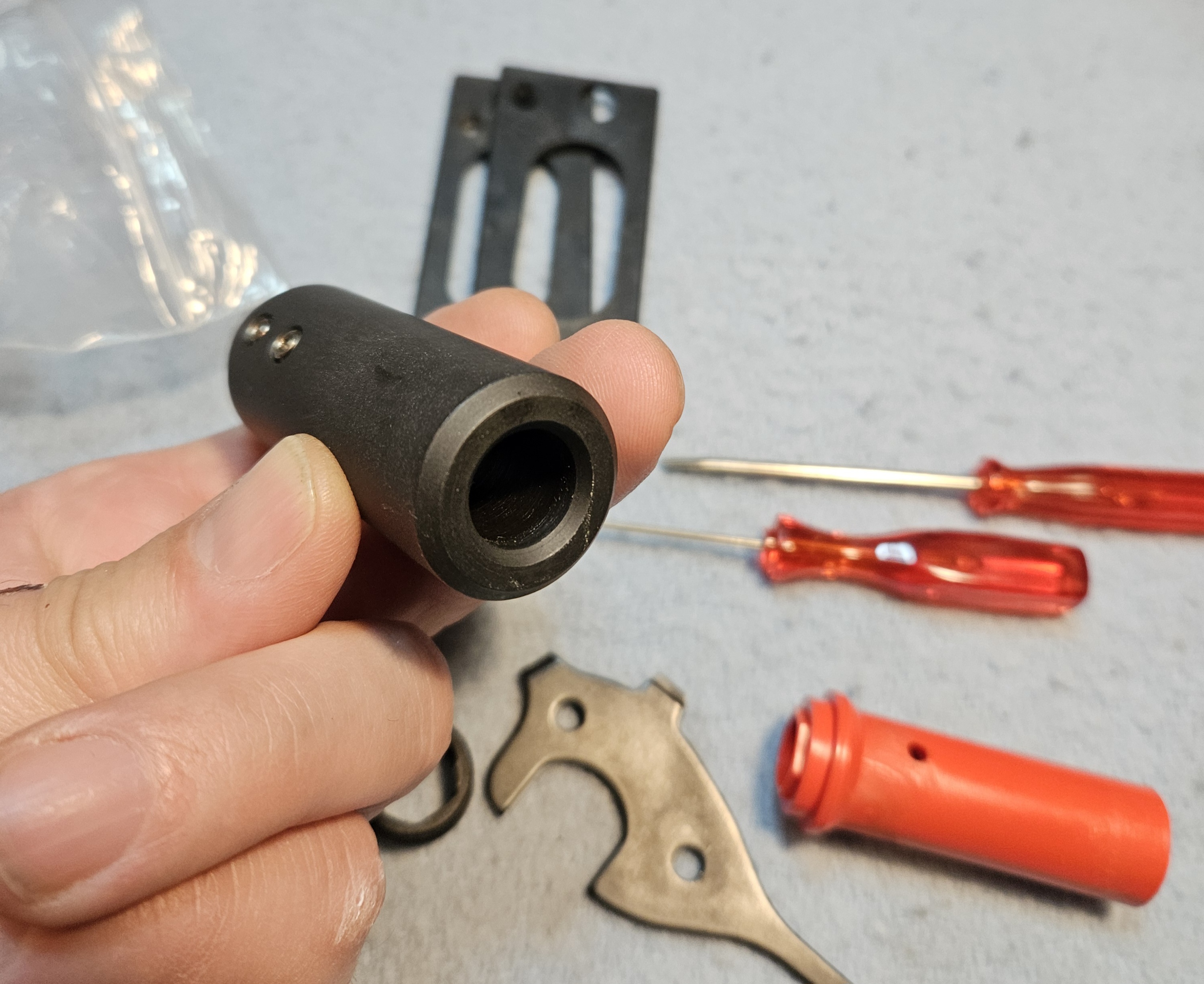

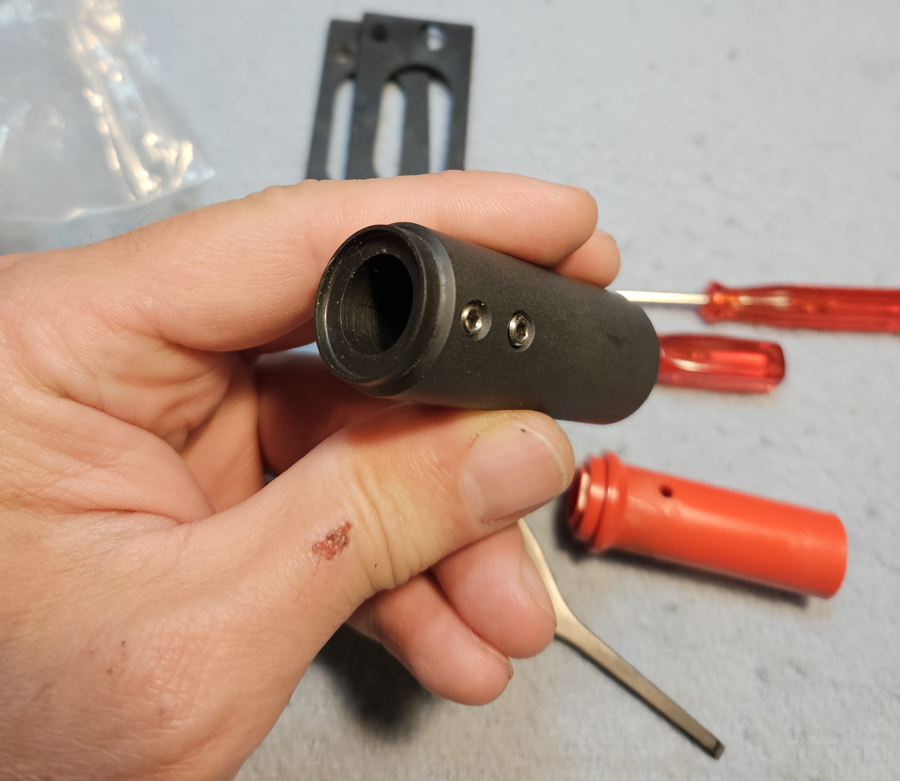

Adding to the pic on page 1 provided by Mike W., this is what mine came with
There were a total of 5 spacers for the adjustable cheek riser, and the muzzle sleeve right below the low front sight unit.
I DO NOT know for a fact that the muzzle spacer is a factory part, but it appears to be used for dressing the muzzle off when you are using a scope.

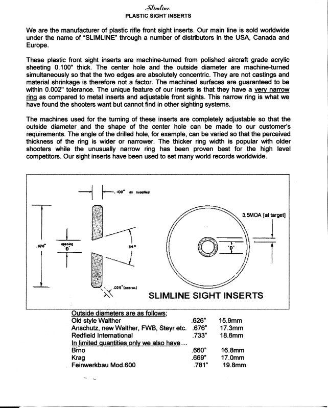

so, JEFFPPC wants inserts for a TO1 and that is completely different than the other front sight
the globe sight that has both with caps take 15.9mm inserts they are same used in the FWB 300 but are called old Walther
you can find both their metal inserts and slimline style inserts on Ebay
