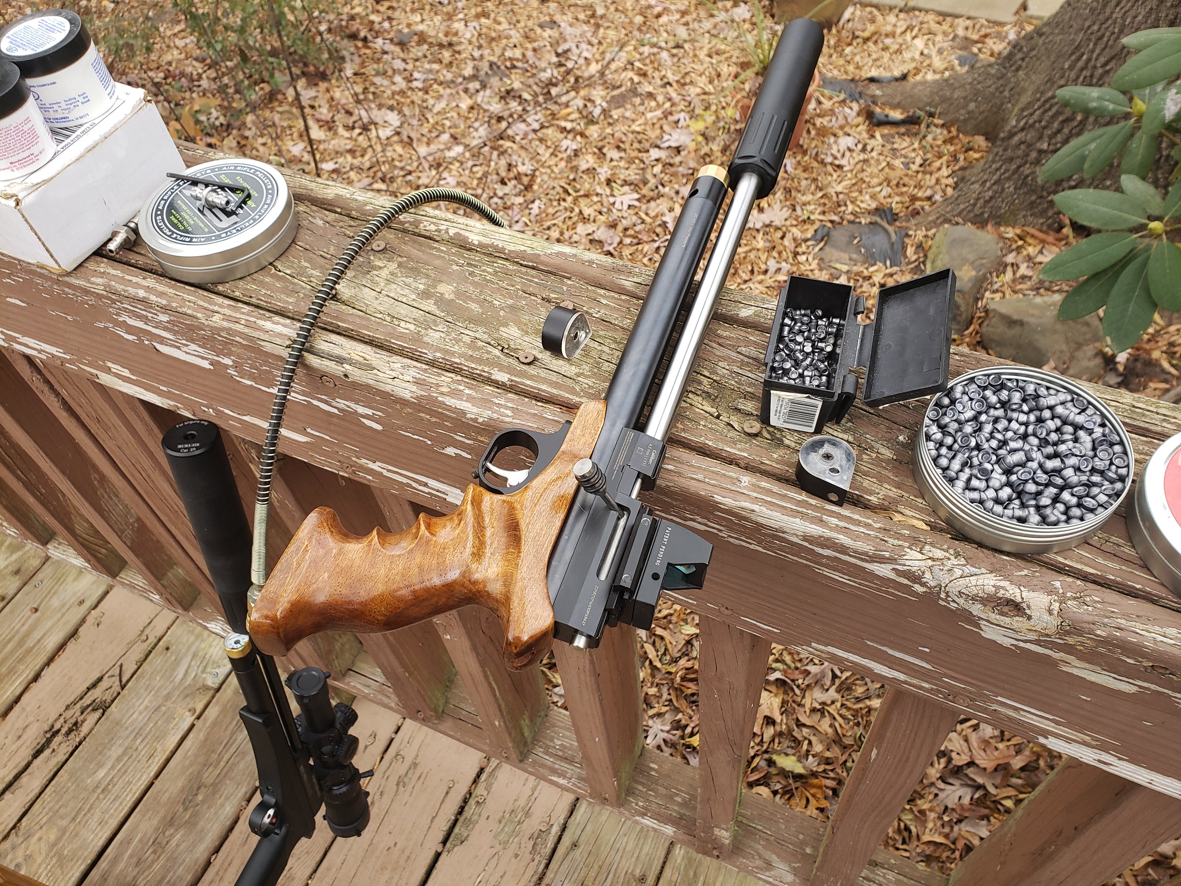

This thread is awesome. I got my .177 Bandit from Utah Airguns back in late 2019. Out of the box, it was just a descending string. Clipped some hammer spring coils and it was shooting with more of a curve but not how I like. Having only shot regulated guns since early 2015, I had to slap a regulator in there. I also chopped the barrel to 5" and used a shortened Prod shroud to somewhat quiet it down. It's loud, still, and wastes a lot of air. I've found that I've only shot it a handful of times since "finishing" it; I usually grab the Beeman P17 if I want to shoot a pistol indoors. So I've got some plans for this little guy, just waiting for some parts to get in.

Hello @UCChris
I really like seeing and reading what all modifications people are doing with their various pistols. There are some really cool and far-out pistols and I hope a lot more will be added. I even like where just a custom grip was added.

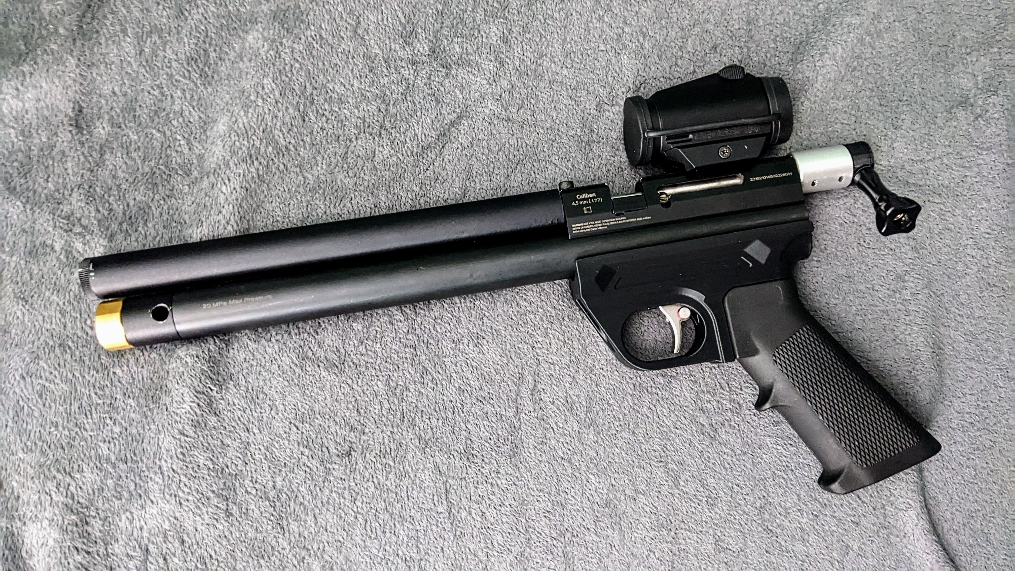

I've got a 177 bandit as well, I spoke with Thomas briefly about it, I got it from pyramyd air a few years back and the power curve was pretty wild. Up to 850fps with 8gr pellets and steadily declining. Barrel was phenomenal. I pretty much immediately installed a huma regulator but decided to ditch the included plenum and hogged out the valve body to suffice as enough of a "plenum". This increasing shot count. This involved cutting a valve seat into the front face of the valve body to seal against the regulator body.
I got 50 shots at 650fps with 8gr when I tuned it. The gun now has a leak I need to track down and is the only 177 caliber gun I own (of many).
At one point I tried polishing the bore and thought I destroyed the barrel. Turned out my scope was bad. But didn't discover this until actually destroying the barrel trying to recrown and "fix" it. And I had also already gotten a LW barrel which is now on it. 🤦. I still need to get around to polishing and bluing it.
I also reworked and refinished the stock, and tuned the trigger to break at 12oz. As well as added a trigger over-travel stop. Hammer is lightened as well to help with shot cycle characteristics.

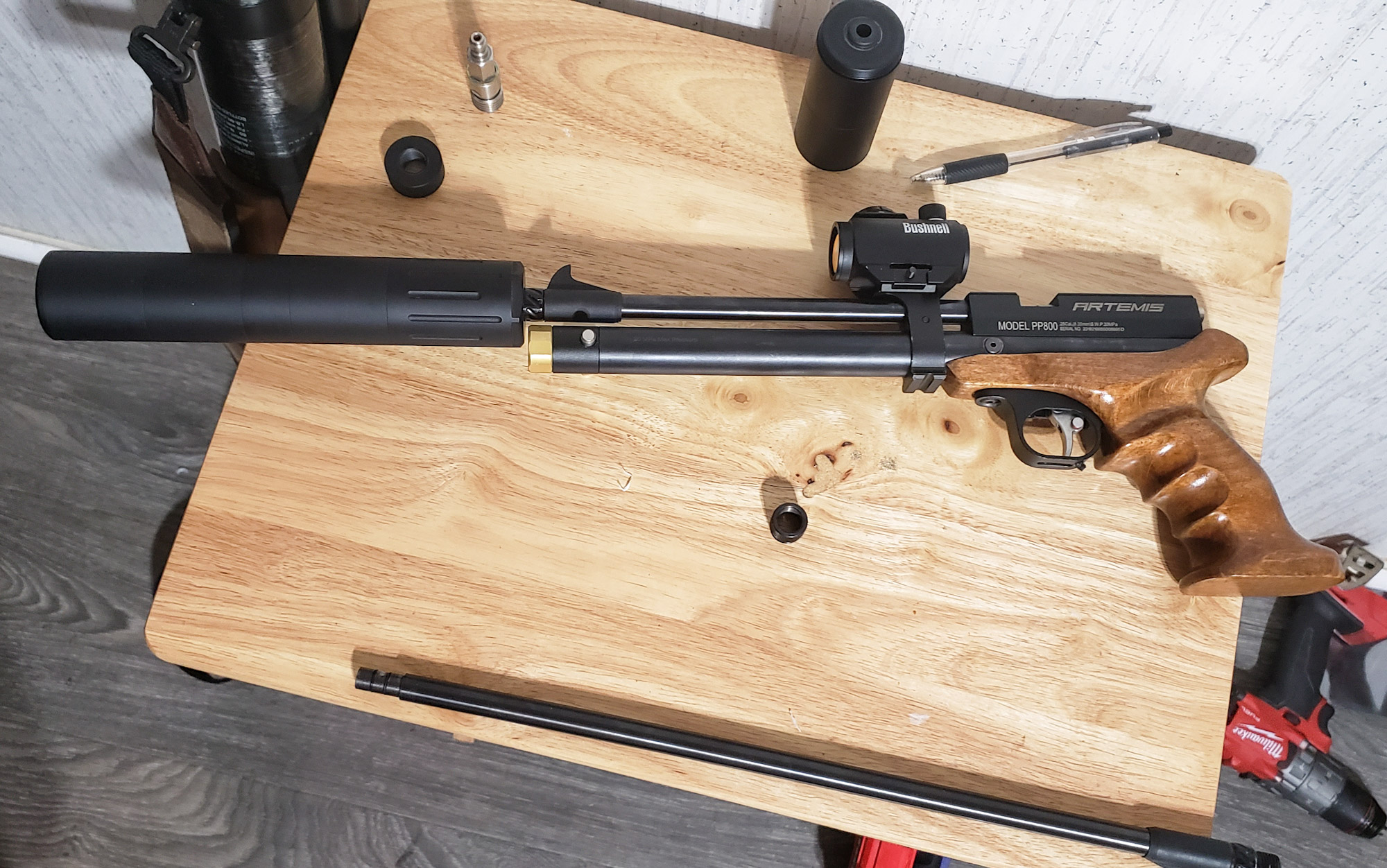

My other one is a pp800 25 caliber with a cothran powerhouse valve fitted, 6.1mm ports throughout. (ports involved cutting thru one of the original barrel oring grooves and cutting a new barrel oring groove for each barrel). I like to swap grips between the two. It does 48 fpe in 9" barrel and 65fpe in 15" barrel. Only gets 2 shots unregulated, but shoots lights out with jsb kings.

Hello @Long_Gun_Dallas
That is a really nice looking setup. With that moderator it should be whisper quite.

Not really lol. Its quite loud. 48 fpe in a short barrel is a LOT of power. And it's using half the air in the tube in one shot. It's approaching somewhat quiet with the longer barrel and long mod. No moderator, it is obscenely loud.
