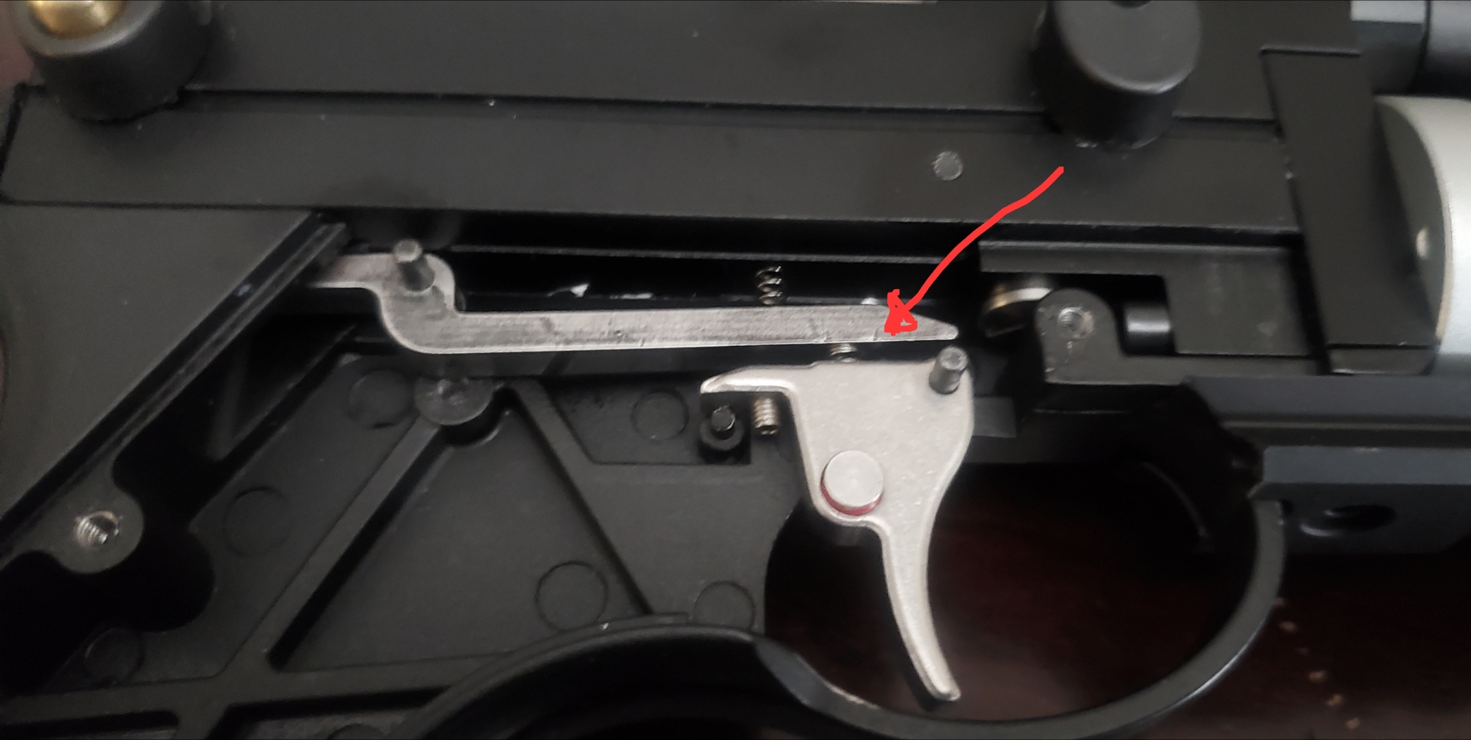

See if you can find any info on polishing a regulator. I've done the one in my fx crown, although it is a huma regulator. I run several of these in other guns. Basically I just polished the washers and made sure the piston was as smooth and flat as possible. Same for the piston shaft.

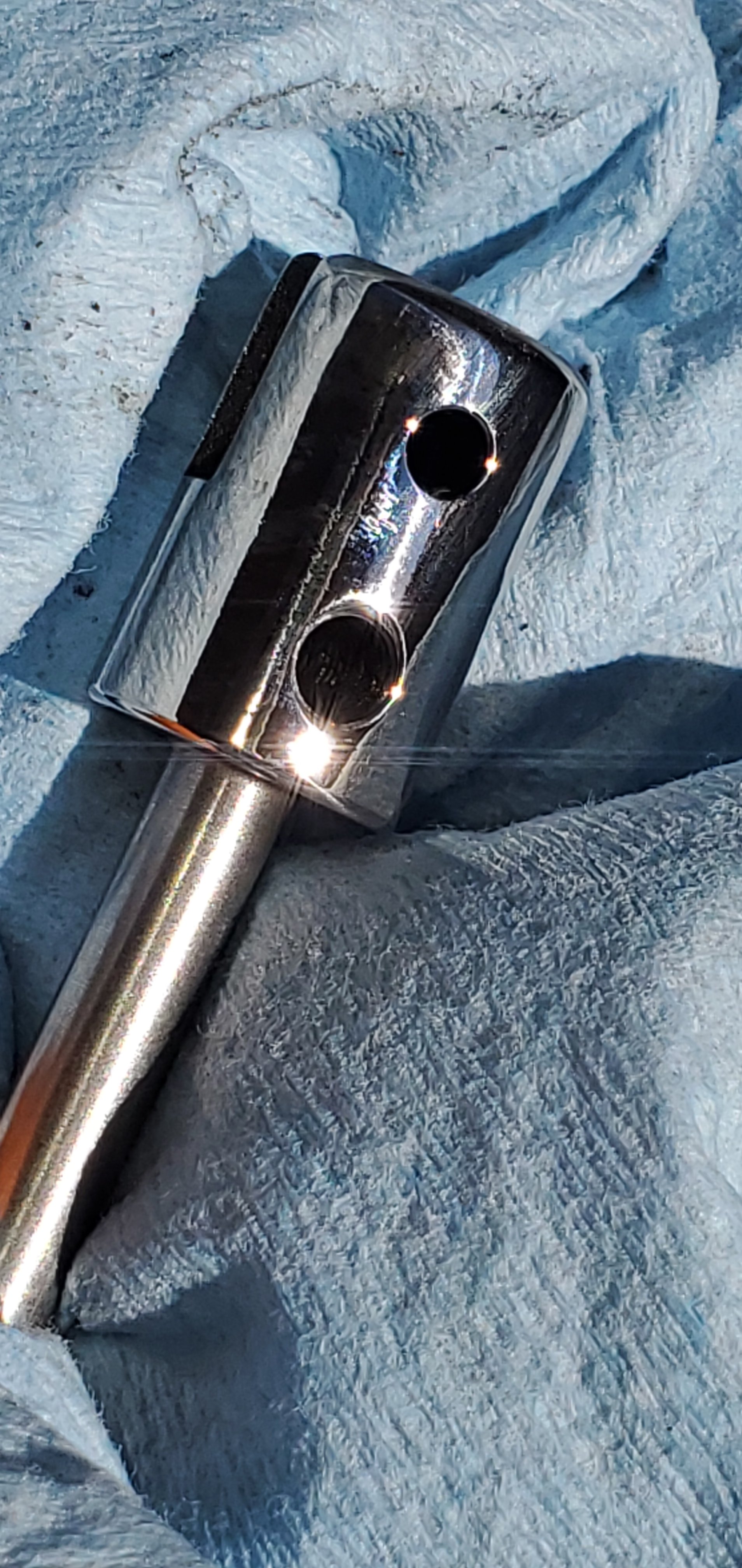

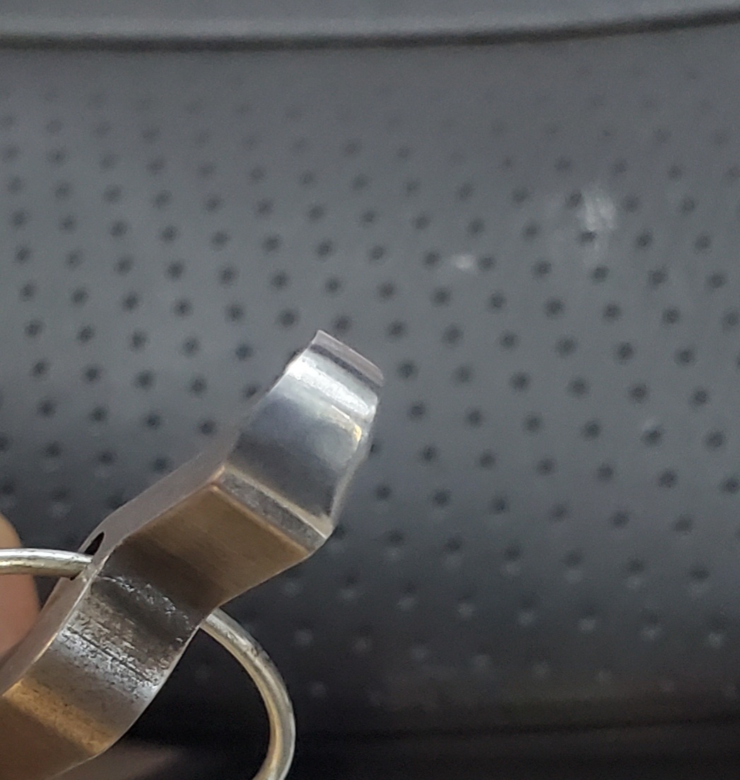

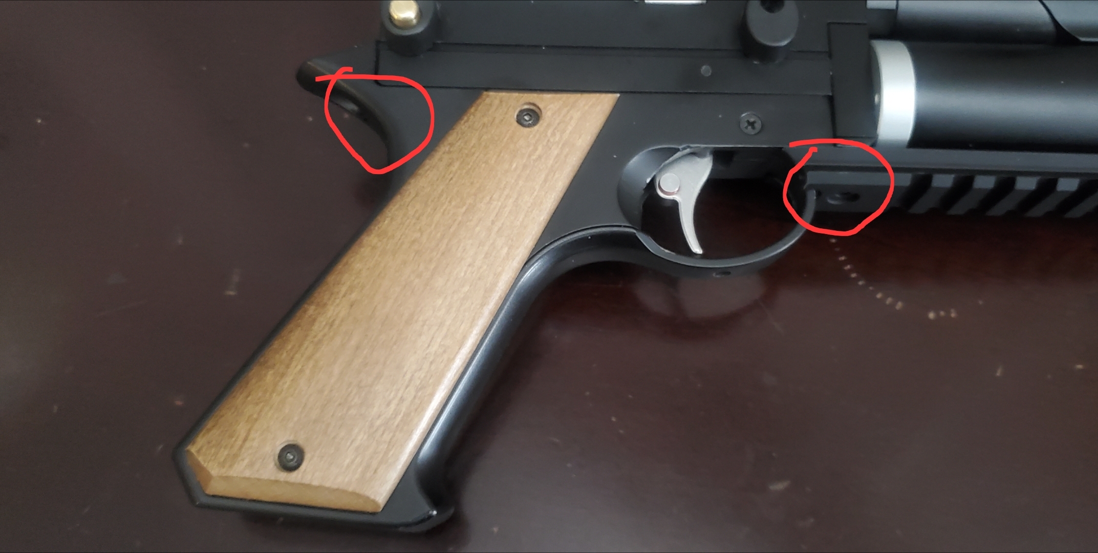

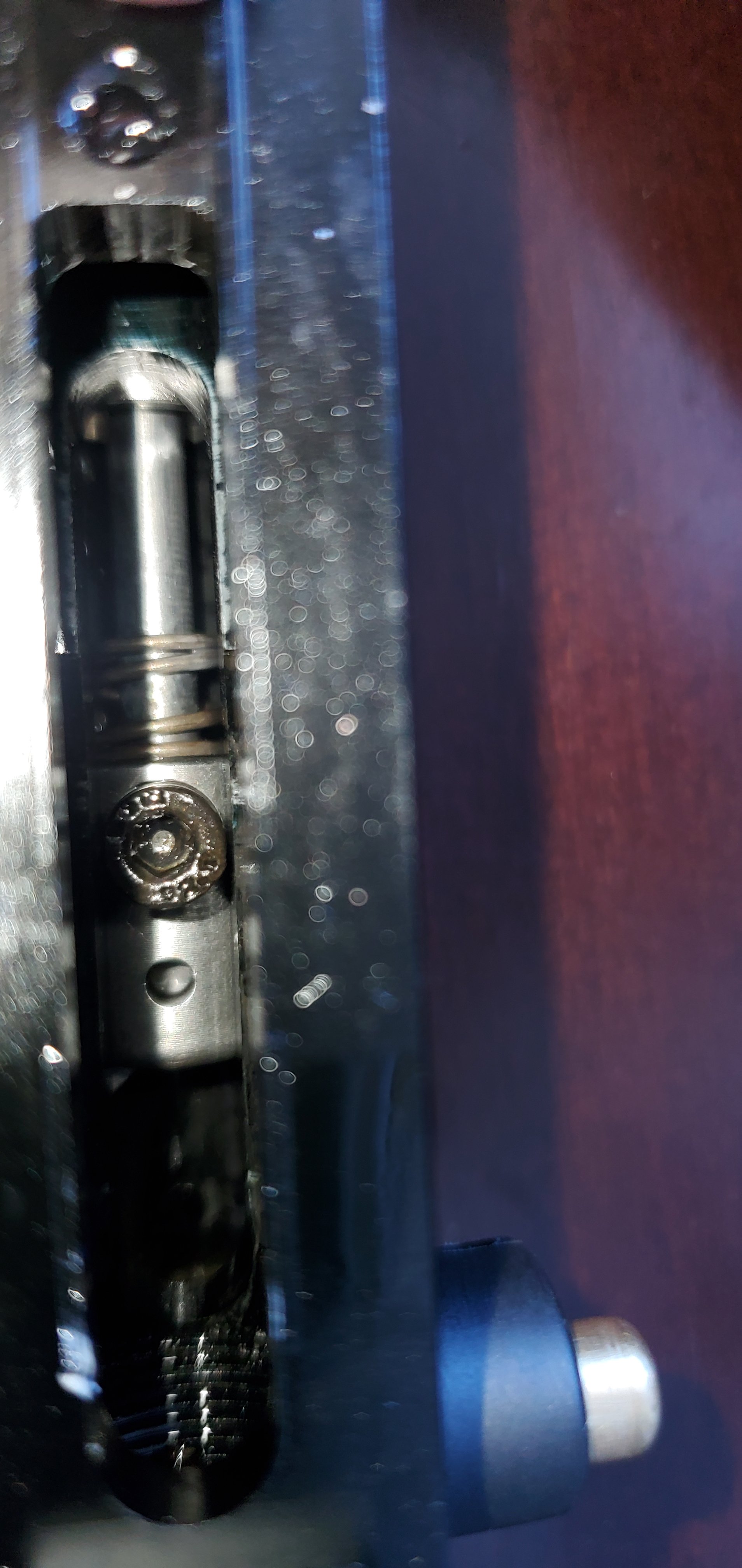

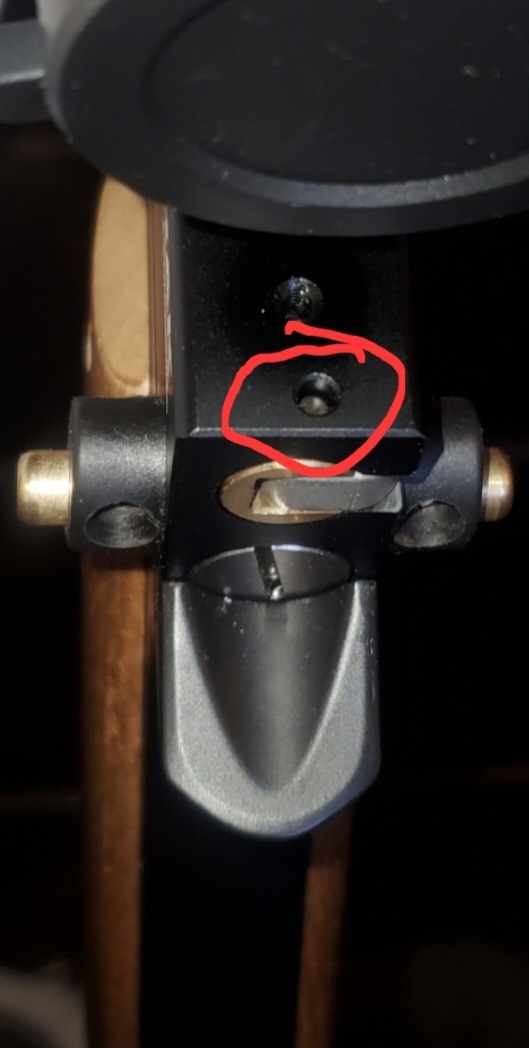

@Healthservices My pp800 and bandit both came with horrible triggers. With some polishing and manipulation of the set screws, they are both very smooth and crisp now. However, as is the case with both of mine. This tends to render the safety inoperable. Basically neither gun has a working safety now.
Hello @Healthservices
The PP750 is a different duck but it is a pistol and that is mainly what this thread is all about. It is an upgrade ( for lack of any other word ) from the Bandit/Artemis/Snowpeak and all information and modifications shared are surely welcome.
Okay so trigger wise if the pp750 is a up grade I would assume it can't be all that great then. Like many sanding smooth or even better polishing the sear points help a lot with getting a consistent trigger.

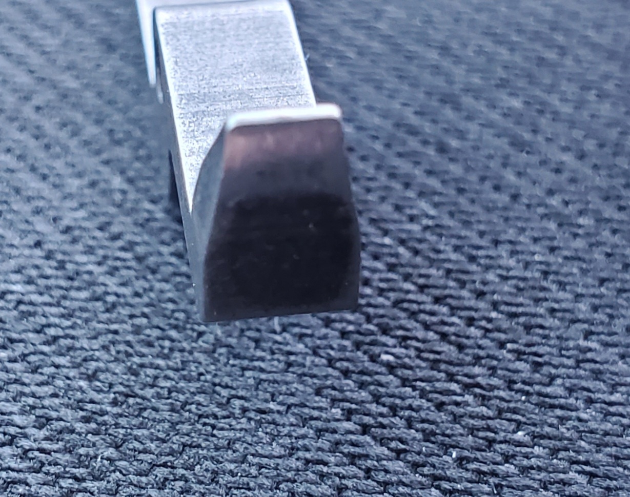

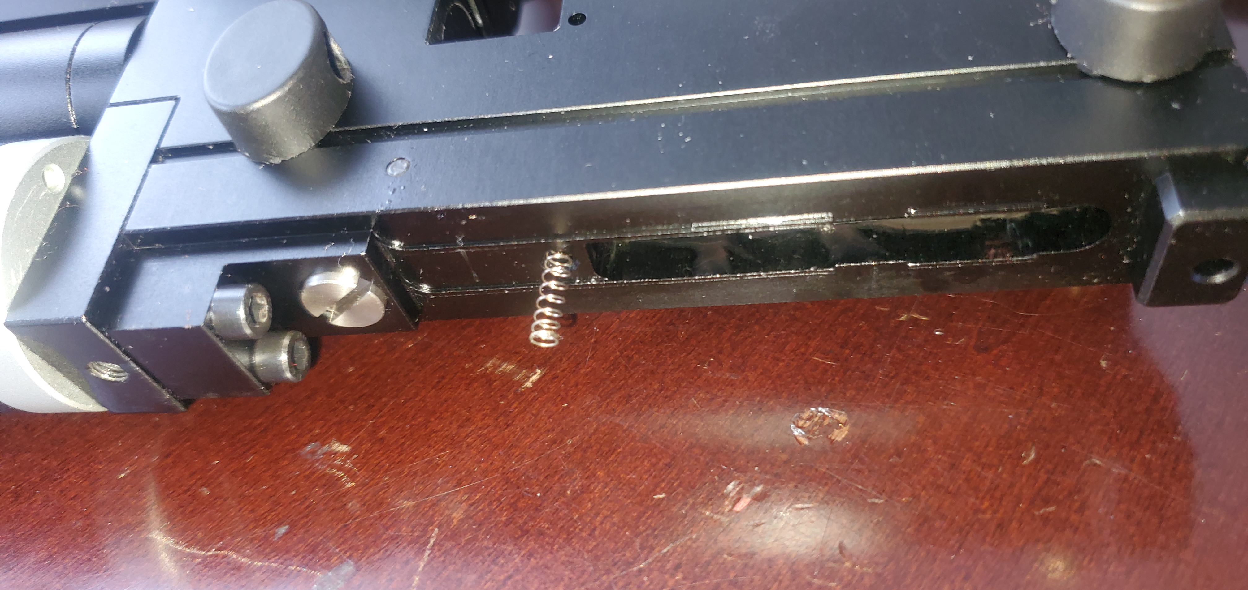

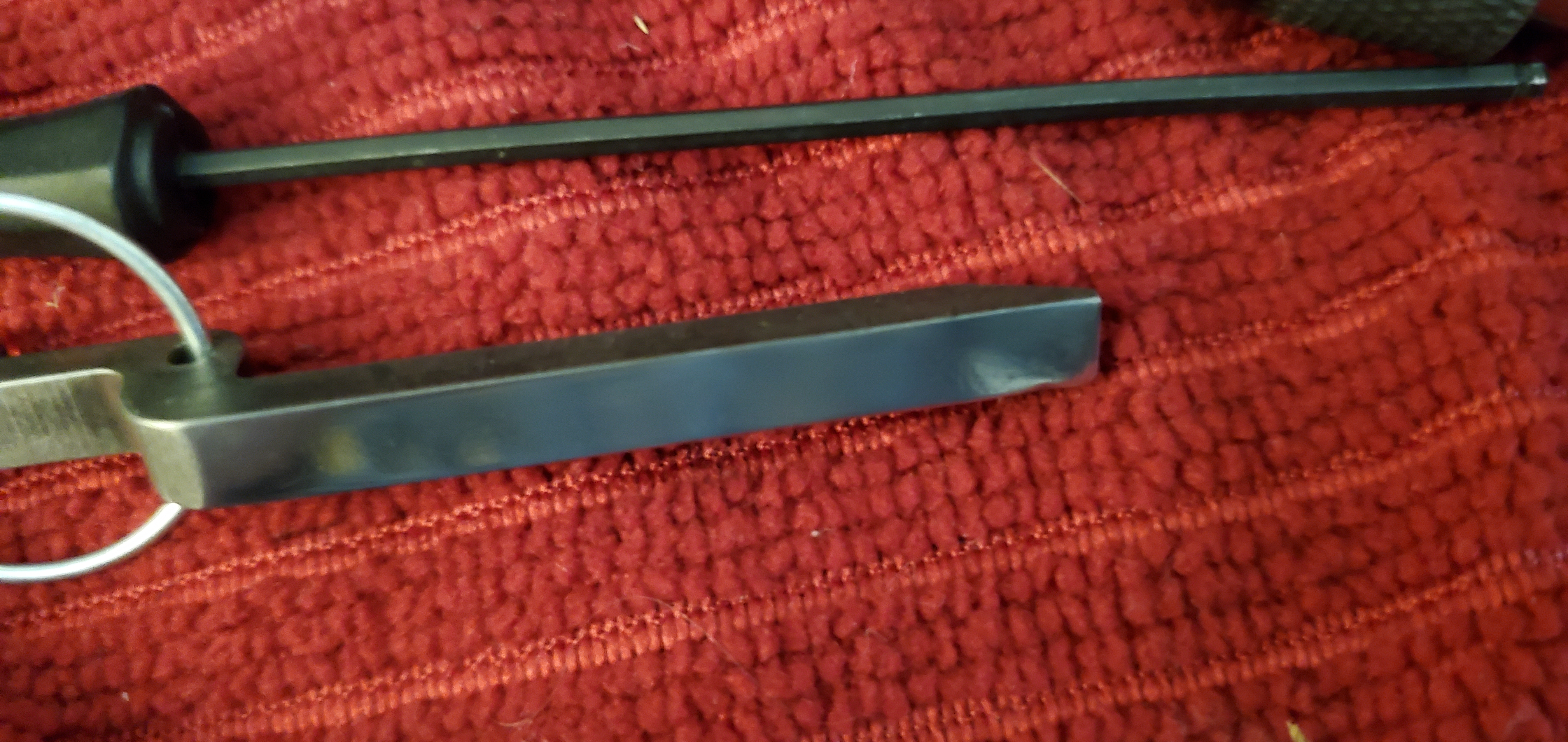

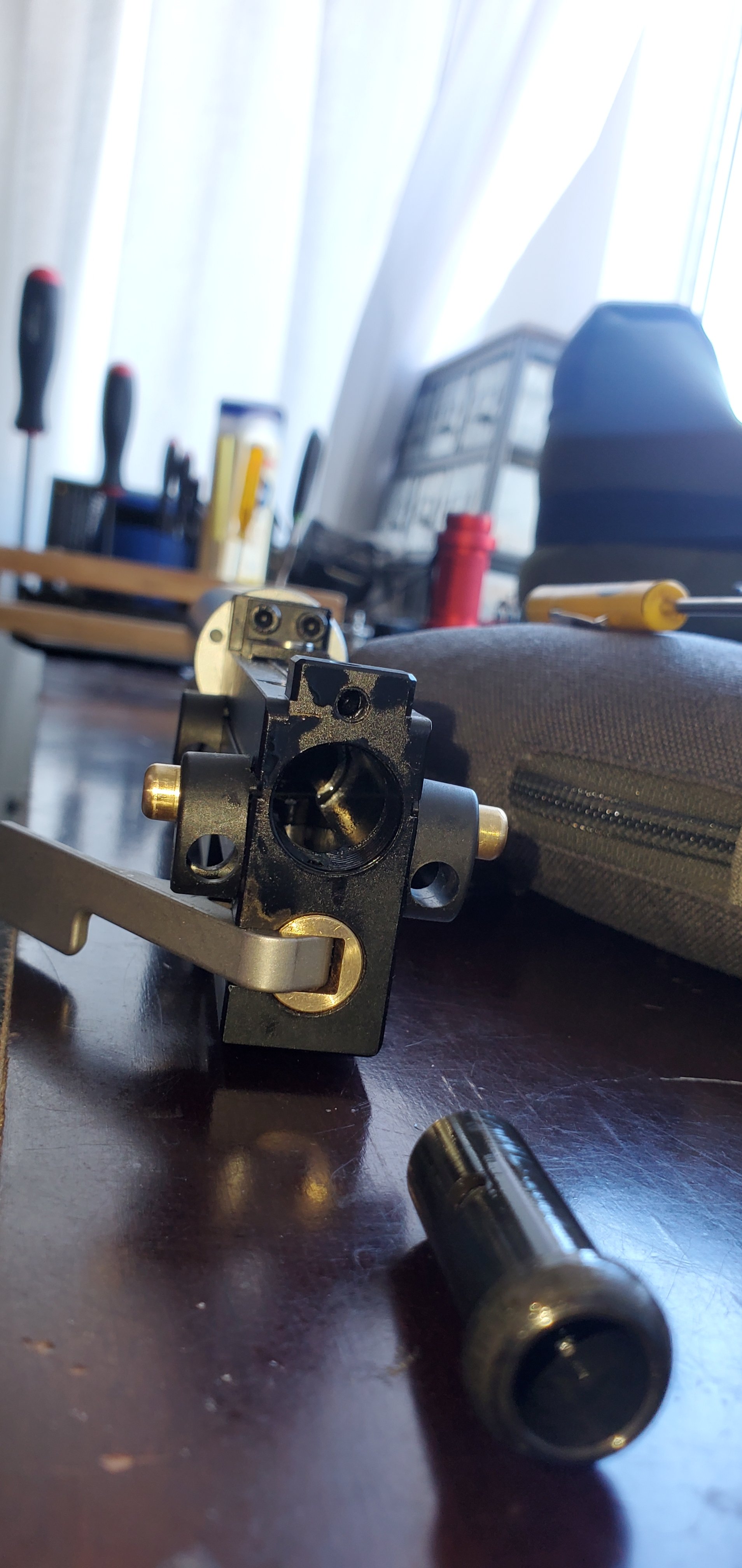

Removing the old sticky grease and using something better also helps.
With sanding, starting with 400 I went all the way to 2000 and it got shiny and slippery.
But then I put a buffer on it and it turned into a mirror. I also did the same to the hammer since the cocking felt gritty too. Besides that is also a sear point.
This part too

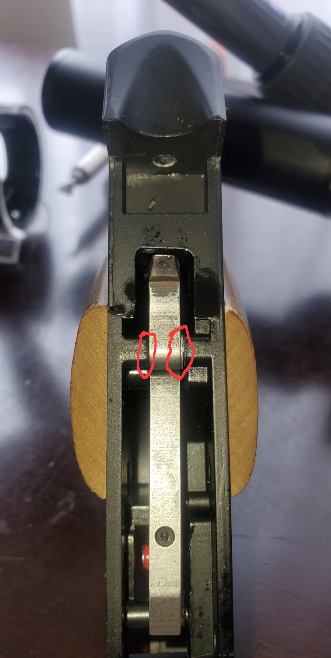

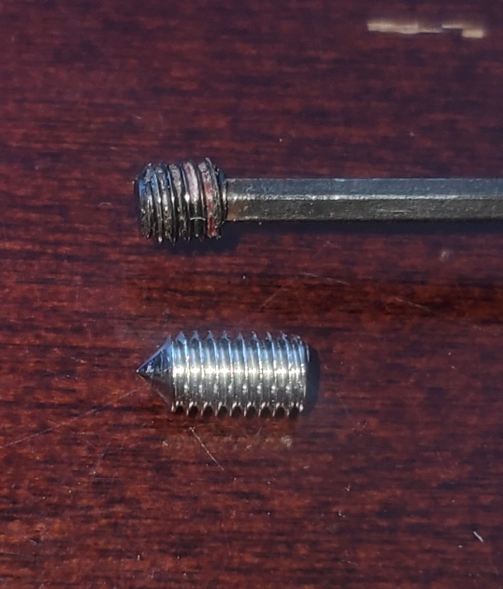

I replaced the grub screws with stainless pointed ones (amazon) so it would have a fine point to hinge on. Dab some grease on the fine point tips before installing.
I polished the bottom of the sear too where the grub screw meets.
Have some washers on order to take the sloppy wiggle out. The ones i had were a little thicker than i thought at .5mm get something thinner like .3 mm the size should be 2.5 x 6 x 0.3 flat wssher.
Played with some springs and if you noticed the trigger is a single stage after you cock the handle. So I put a additional small spring above the grub screw at the trigger so it is easier to feel a small movement before you feel a point
where there is a second stage wall is, then PEW! 😁
Made some adjustments with the grub screws and it actually feels decent now. Oh and made adjustments so the safety actually still works! But that little 1st stage spring above cannot be heavy at all otherwise the safety is non usable.
Hope this helps some and sorry I did not know that some of the pictures were blurry until after everything was installed
Allen

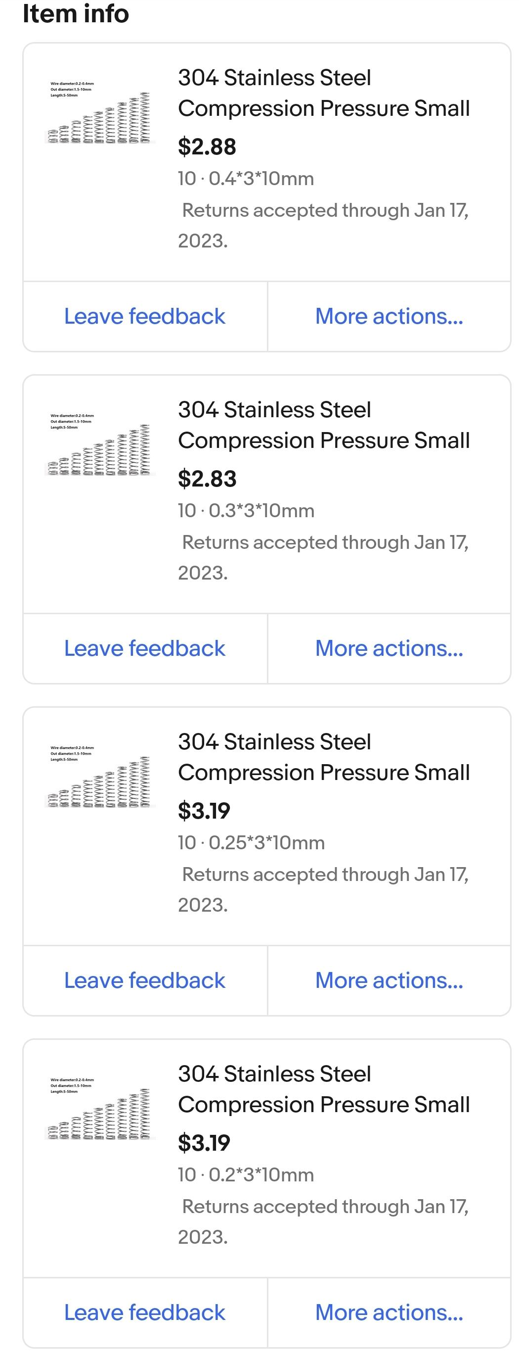

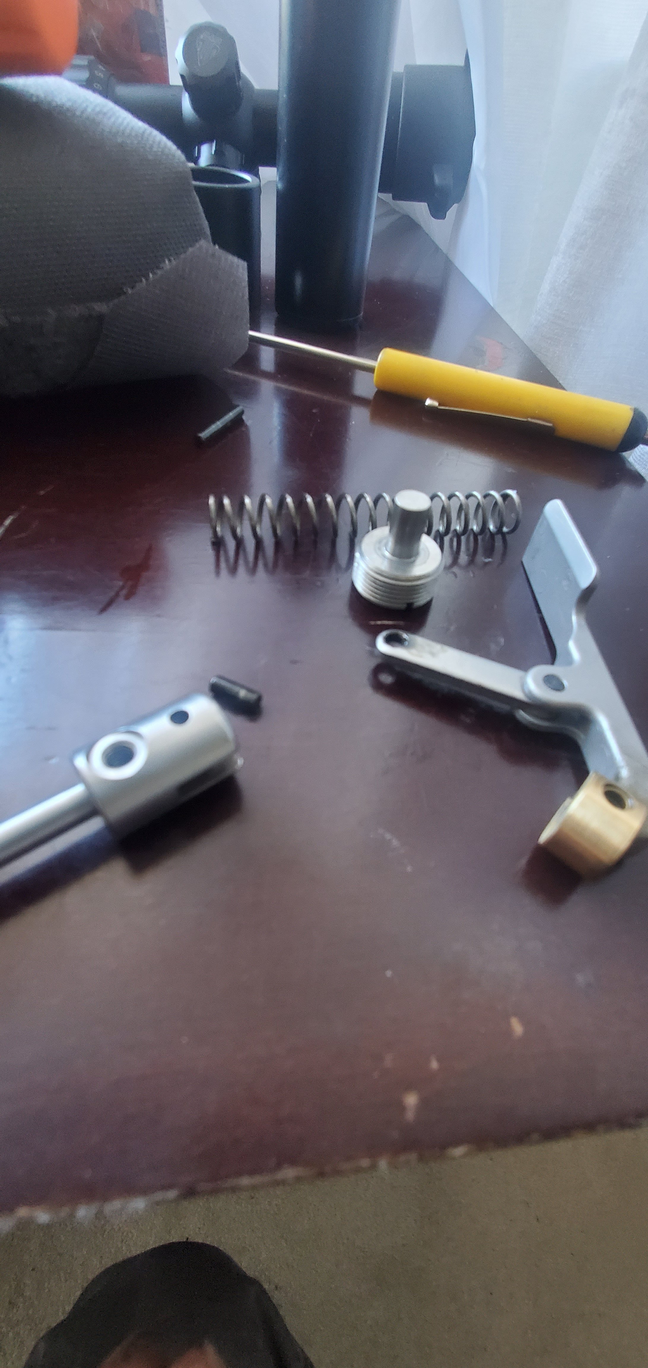

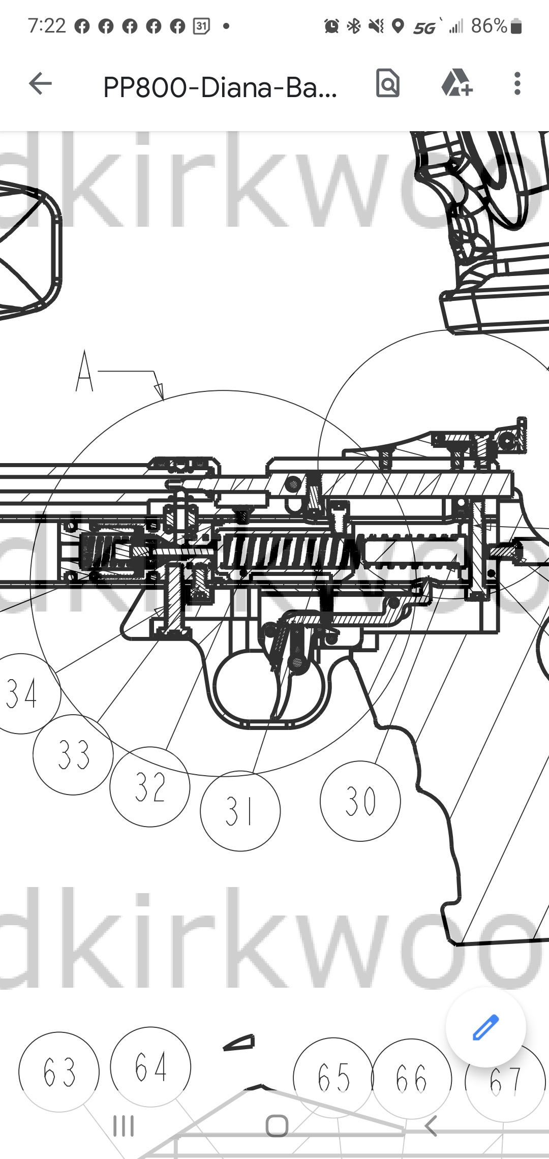

And to clarify I think currently both the trigger springs are lighter than stock. I think I bought those on ebay or Amazon. The ones on ebay took a while but are cheaper than the Amazon ones. The spring size is 3mm in diameter and 10mm long. The factory diameter of the wire if I remember correctly is .45mm.
The factory long hammer Spring on the pp750 is 9mm in diameter. Which is the same diameter as a mk2 hammer spring. The wire size is 1.1mm and the free lengths vary but mine is 62mm
If you plan to shim the large spring get 6mm ID washers that are no larger than 13mm in diameter. 6mm id x 12 mm od seems to be a common washer size.
Allen
When and if you decide to remove the hammer to polish, change springs or othere work on the pp750 it's pretty easy and no need to air down. Remove the 2 screws that hold the handle here and jiggle the handle off be careful with the hammer Spring as you remove the handle.
Then unscrew the large screw at the back to remove the hammer and Spring. Once you can remove with your fingers keep tension on the screw and be careful not to let the Spring fly out.
After removing the Spring and hammer, you can remove the bolt first by removing the Allen from underneath the hammer in the slot.
Remember to clean and regrease when reassembling. On the pp750 to remove that assembly you need to remove the rear sight. Then take a magnet to remove this pin.
Oh remove the crossbolt that holds the plastic brackets too.
Afterwards you can slide out the assembly.
Allen

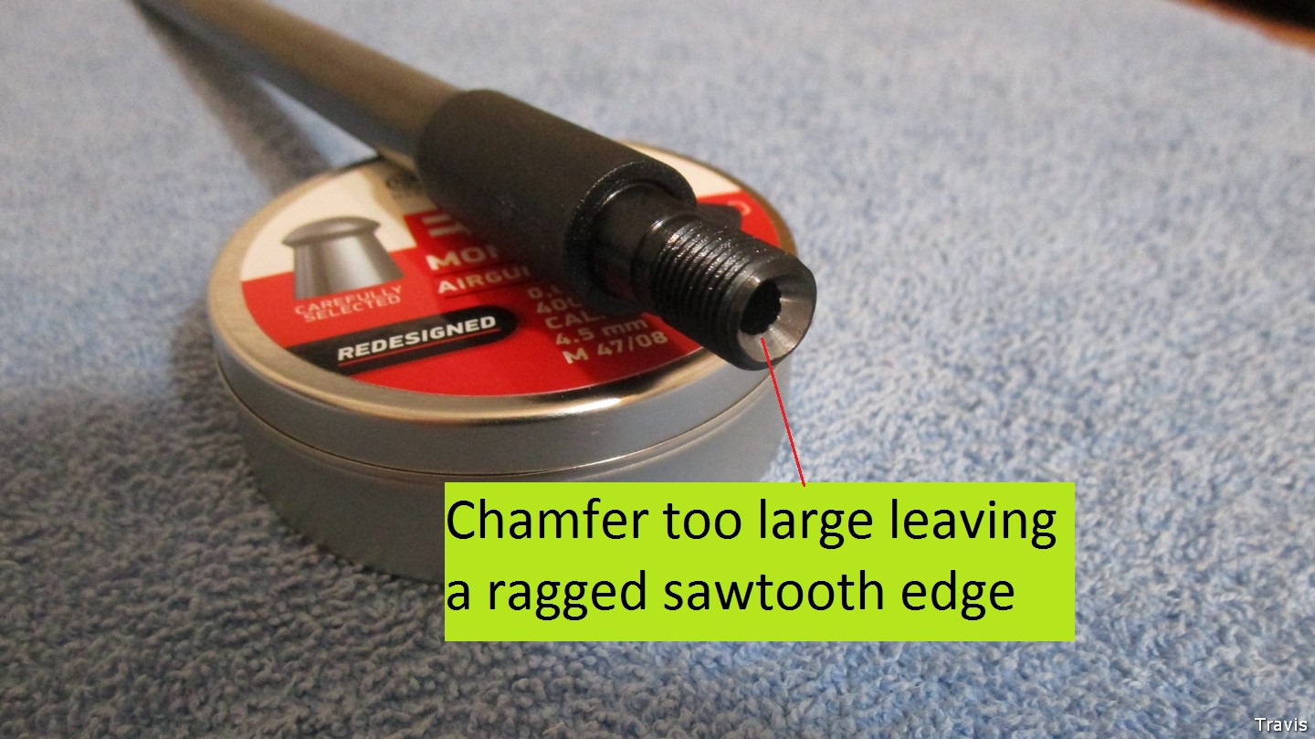

Hello everyone,
This is a “heads up” / “information” post basically for any Air Gun.

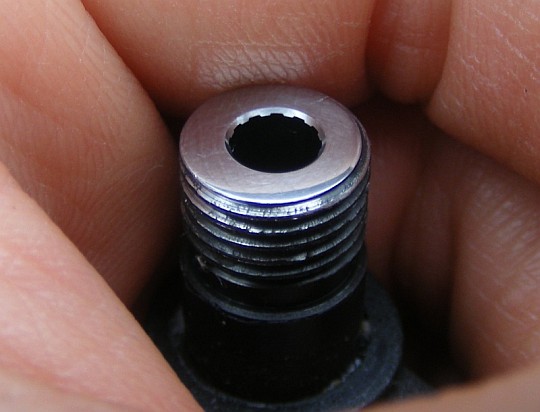

I have not been getting good clean round holes on the targets that I have been shooting with the new Snowpeak PP800R. Long story short, it was not the targets or the paper, turns out it was a bad Crown chamfer on the bore of the barrel ( see attached photo ).
I shot the same paper targets with three different air guns and they all produced clean round holes and I realized it had to be the new Pistol. I figured it had to be “clipping” the pellet so I first removed the Barrel Nut and saw the bad Crown chamfer / bevel as shown in the first photo.

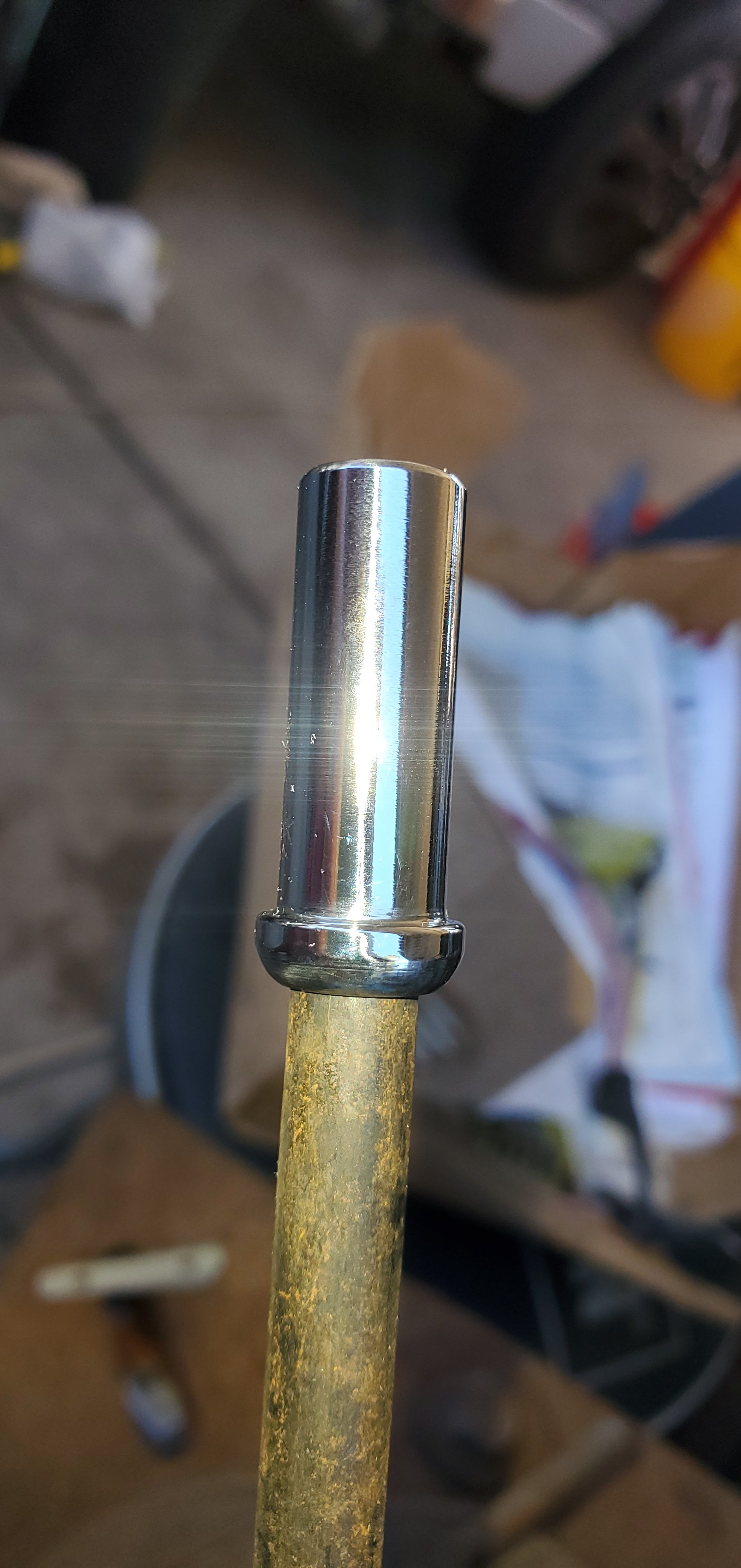

I de-burred each of the “lands” and then polished the chamfer / bevel eliminating that sawtooth exit of the bore ( see photo ). Unfortunately the pellets are still hitting the target at a slight angle and not producing a good clean round hole, but the dealer is sending me a replacement barrel.
Clipping not only cause the pellet to hit at an angle it will also effect the accuracy. So if you have a gun that is not shooting clean round hole in paper targets, I suggest inspecting the crown on the barrel.
Hope this information will be helpful.
ThomasT

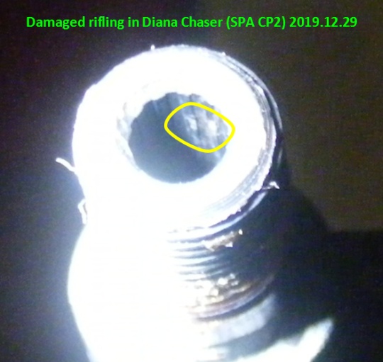

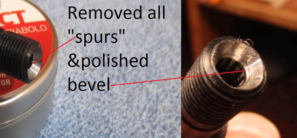

Excellent picture of the muzzle. Looks like SPA is still at it, chewing up the lands with a piloted crowning tool. Accuracy should improve substantially if you can chop off the damaged portion, face it off and apply a new crown.
The barrel of both my CR600W and CP2 (Diana Chaser) were the same way.
Before:
After:
Before:
After:
Hello @nervoustrig
If I still had my lathe I would have done exactly what you suggested. It looked to me like their tool was maybe loose because there was some chattering and the chamfer was actually off center. Your finish looks good.
ThomasT

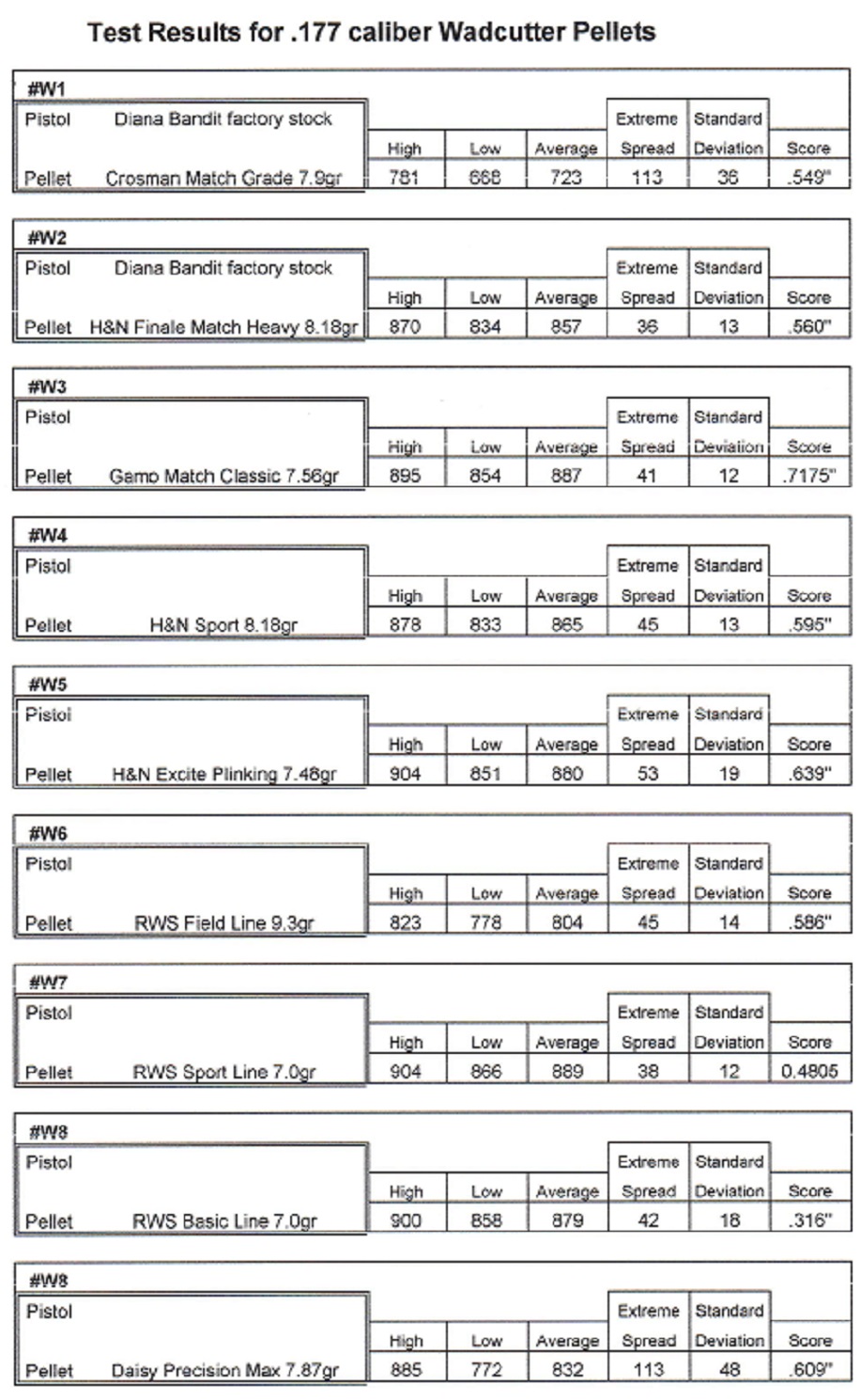

Wadcutter Pellets Compare
#W1 Pellet Crosman Match Grade 7.9gr
#W2 Pellet H&N Finale Match Heavy 8.18gr
#W3 Pellet Gamo Match Classic 7.56gr
#W4 Pellet H&N Sport 8.18gr
#W5 Pellet H&N Excite Plinking 7.48gr
#W6 Pellet RWS Field Line 9.3gr
#W7 Pellet RWS Sport Line 7.0gr
#W8 Pellet RWS Basic Line 7.0gr
#W9 Pellet Daisy Precision Max 7.87gr
Hello everyone,
Over the next couple of weeks ( weather permitting ) just for fun and a bit of information I plan to compare the above listed .177 caliber Wadcutter Pellets. I will be using a factory stock Diana Bandit Pistol shooting at least 20 rounds over a Chronograph and recording in 10 shot groups. I will clean the barrel between each Brand and Weight of pellet shot. If no anomaly is indicated between the two rounds shot, then I will use the second or last round shot to record for this test. I will be shooting at a paper target set up at 10-meters to establish a score for each of the 10-rounds shot, the Score will be the distance in inches between the centers of the maximum spread. Today I shot the H&N Finale Match Heavy 8.18gr and here are the results.
ThomasT
Hello everyone,
Weather not perfect but good enough to shoot some of the above listed pellets this morning. Could not get good readings on the Chronograph due to clouds so I will do that at a later time. Attached is a scan of pellet W1, Crosman Match Grade 7.9gr and note the Score is "adjusted". The two shots inside the green circle are error shots by me and not the pellet, so I did not "score" them. I did shoot two more pellets for a total of 10 shots for the final score.
I am surprised how well the Bandit has now shot all 9 of the different pellets. It will be interesting to compare the Chronograph numbers for all 9 pellets. I will add those numbers when I get them.
I have noticed that almost all of the Wadcutter pellets appear to be a lot cleaner and overall better looking than other pellets. In loading them into the magazines they all seam to "seat" the same.
ThomasT

Hello everyone,
Attached is a photo of the Final Results for All of the nine Pellets that I compared. Again this is not an all inclusive scientific comprehensive test, but it does offer some pretty good information. Note the “Score” shown is for only two 10-round shots at a target set up at 10-meters. I am certain that I could best each score shown by shooting multiple rounds using only that particular selected pellet but it does offer a reference to the other values listed. The overall “average was 846fps for my Diana Bandit, any one of these pellets shot from a different pistol will most likely give a different result.
Over all I am very pleased with the results and a bit surprised how close all of these pellets were within this group. I am confident that I can use anyone of these pellets on an Official 10-Meter Pistol Target and achieve a very good score.
Hope this information will be of some help in choosing your next .177 Cal Wadcutter Pellet.
ThomasT
Reactions: Bandito and EdinGa
Sweet, so what do all those numbers mean exactly? 🤔
Allen
Hello Allen,
The High, Low, Average shows the feet per second for that pellet shot. The Extreme Spread is the difference between the Highest and Lowest FPS shot. For Standard Deviation, the closer to 0 indicates the muzzle velocities tend to be very close to the average, meaning they're very consistent. The Score is the max measurement of the "hole" in the paper target after 10 shots. Look back up at posting #73 is one of the targets that I shot.
ThomasT
