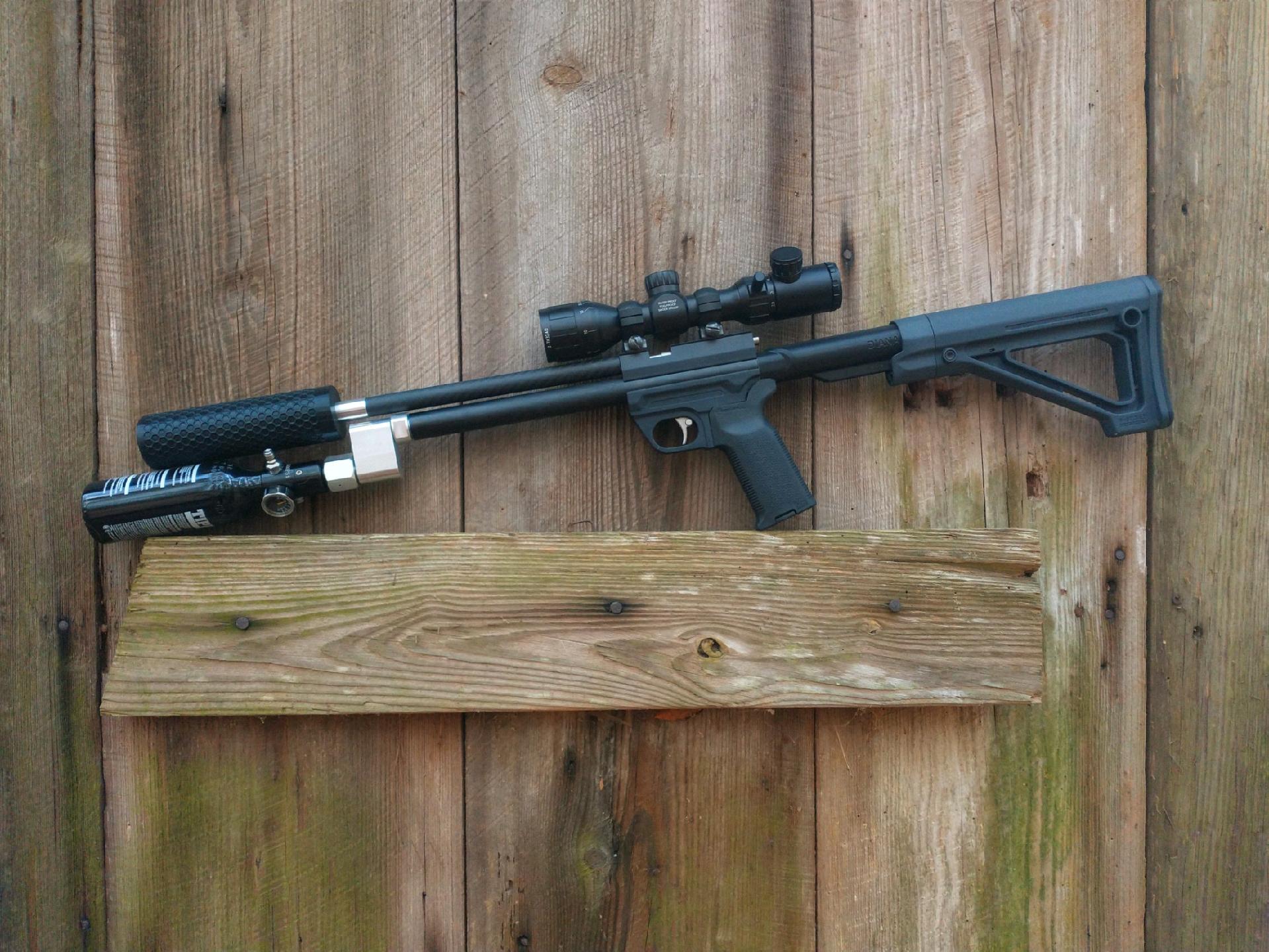

Ooooo niccce!! I can see me doing something like that in the futureBottle Bandit mini thumper... Still not bad to hand pump with the 9ci tank.View attachment 329173

Perfectly stated. You can also tune these little pistols to some pretty decent power levels with a lower regulator setting. The .25 bandit in my picture is making 14 fpe on a 55 bar setting. Even if you go with a bigger 4500 psi tank, you don't have to fill it all the way to get plenty of shots.No matter the size of the bottle, you’re putting in an equal effort per shot. The main consideration is simply when and how often you want to put in that effort.

These things will surprise you with the power they can make.I put a 40gr slug through the chrono
twice the fps as my ruger rifle, uhhh what?
Oh I am quite convincedThese things will surprise you with the power they can make.
If I remember right, you've got a longer barrel too?Here ya go...

I'm using the stock barrel. I was thinking about ordering a longer one, but never did.If I remember right, you've got a longer barrel too?
Aww ok, then you just fill your bottle and put it on your slinger, right?I'm using the stock barrel. I was thinking about ordering a longer one, but never did.
Oh nice!!I leave the bottle attached all the time. I fill it on the gun. I'm running a carbon fiber tube over the barrel, but it's not necessary. I listed everything else I used.

@EdinGa ; how would I go about making a bottle slinger conversion?* I really like yours
