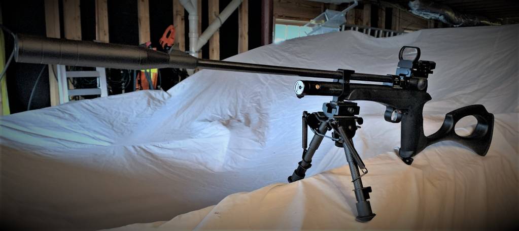

Here is mine, post project. Shoots well with the chaser rifle barrel on it. Have since added a 2x7 UTG pistol scope mounted on the barrel band. Shoots great and groups well after the recrown job I did with my dremel.
