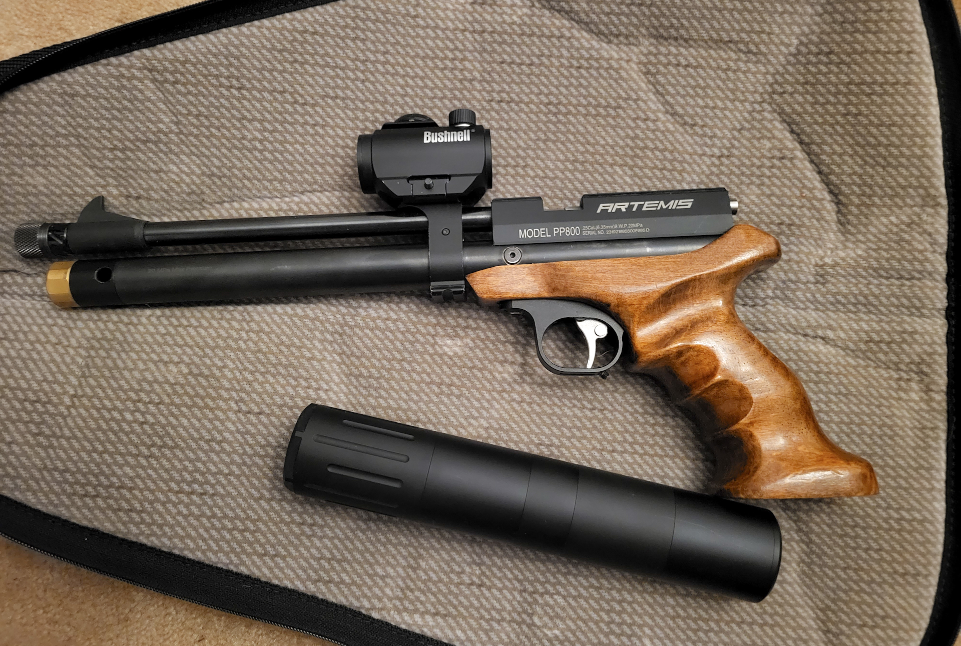

Here's the thing.... 80 shots may be true for how they are setup in the UK (they have power restrictions) my .177 was doing something like high 800fps with 8gr pellets, but had maybe 10 usable shots like that. If you detune it, it should get more. I put a huma regulator in mine, but I guarantee mine is smaller than any other one you will see because I deleted the plenum on it. Mine gets 50 shots at 650fps with 8gr pellets. My other one is the opposite end of the spectrum, and has a custom valve in it. Does 925fps with 25gr pellets for 2 shots :ROFLMAO:
