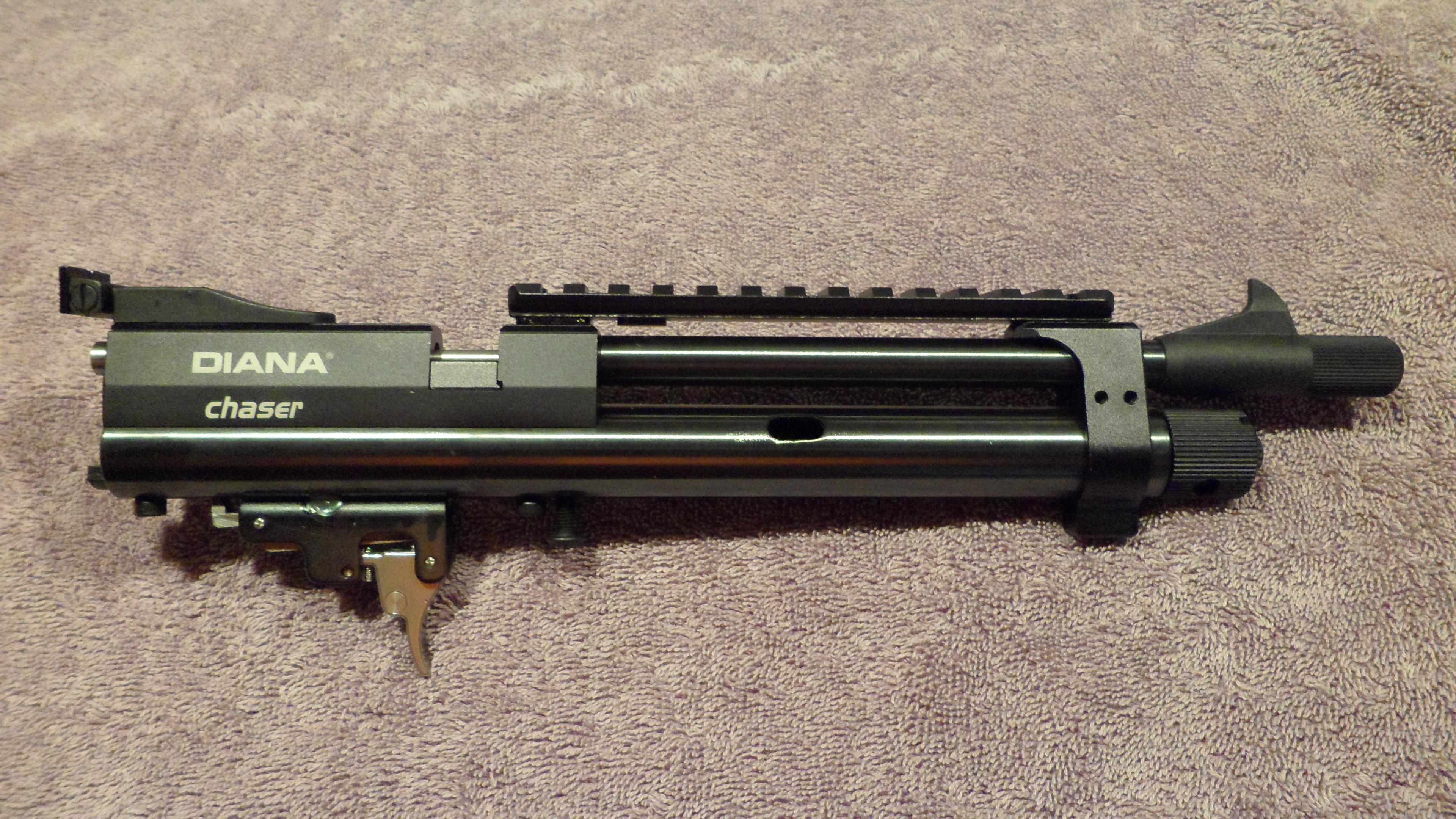

now on the 2 custom Chasers i made up have a bridge M-Lok mount using one barrel screw hole and a barrel band so you can mount a scope or anything forward
also, i have seen these mounts on Ebay that should work on the 12mm barrel and keep the breech clean
https://www.ebay.com/itm/115692533586

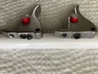

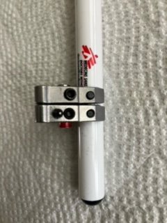

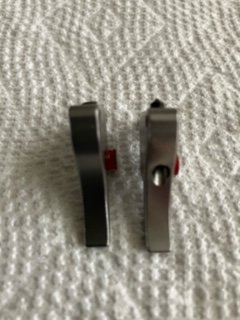

Mike, thanks for that info. I'm wondering if deleting that screw was more of a "we don't want folks messing with the trigger settings" kind of thing, because it sure couldn't have saved Snowpeak very much in manufacturing costs. The "front" screw is still THERE, you just can't access it without removing the stock. The o-ring change, at least on the Artemis, is good from a durability standpoint. They DO look like a urethane material is used, again, at least on the CP2. I'm still deciding on what red dot to get for my brother. Those Hawke models that attach directly to the dovetail are calling to me, but I have to get a look at the sight itself, and the "crispness and roundness" of the dot before I plunk down my cash.
you mean the rear screw is still there
you could use the rear screw do all the work but you would need it to be 10-12mm
you could add a 3mm grub screw at the top of trigger without drilling through
you could use it as a starting point to where the sear sits on the hammer and in reality that is what it was doing in the first place
do i think the liability lawyers did this 100%
oh well it is done and we as owner have 2 choices leave it or tinker with it
1-you mean the rear screw is still there
2-you could use the rear screw do all the work but you would need it to be 10-12mm
3-you could add a 3mm grub screw at the top of trigger without drilling through
1- No Mike, I mean the FRONT trigger screw is still there, what "they" did was drill/tap the hole for it from the (3)TOPSIDE of the trigger. The hole does NOT extend down through the trigger bow. So, to adjust it (the "front" screw), you have to remove the action from the stock, and then the trigger bow itself, to get TO it. I think, if one really WANTED to, you could remove that screw, vice up the trigger in a drill press using that hole as a guide (for proper angle) to drill completely through the trigger bow (from the top of the trigger), then "through" tap it, and then insert a suitable screw from the BOTTOM side, the same as the Diana DIT trigger shoe. You would then also have to cut a slot in the trigger guard for access as well. That's a LOT of work though, MUCH easier to simply adjust it from the TOPSIDE of the trigger. This DOES require removal of the trigger pin/trigger to access and adjust that screw though. So, adjust the screw, reinstall trigger, TRY it, lather-rinse-repeat until satisfied with the setting. But no big deal to do so. The "rear" trigger screw (it's there) can be adjusted by that same process as well. All this is clear as mud, right? Sorry for my crappy writing. I'll get a pic up later of the trigger so it will be clear(er) I hope. One more thing--as you mentioned, (2) the rear trigger adjust screw may need to be changed to a slightly longer one to get enough adjustment "range".

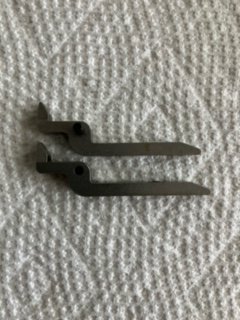

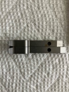

well, this is interesting and sad at the same time
the shorter sear could be the problem here but that can be worked around by overlaying a .5mm stainless strip and gaining the length back
and the trigger can be fixed by what you wrote before or try to use the safety spring tension grub screw as a front sear adjustment screw it is 4mm and i thing 4mm long i have taken mine and made them sit flush
so they changed the pieces and they would have to be worked in a different way but not that hard really
The safety tension grub screw can be used in that manner on the CP2 by screwing it CCW whatever amount is needed to increase the 1st stage travel (initial sear lever movement). At the same time, this reduces the 2nd stage travel. That's pretty much how the CP2 trigger is set up. It's kind of a balancing act, because one adjustment affects the other. If you need more 1st stage adjustment, a slightly longer screw may be required, in order to maintain adequate tension on the safety "button". Hope that makes sense.
what they have done is remove the leverage that you had with the other setup and sort of when back to what the CP1 has
now you mention 2 stage trigger and i believe the CP2 or Chaser has always had a 1 stage trigger and the why is that a true 2 stage trigger has 2 points of contact that never touch the sear and or assembly parts of the trigger before you start to pull the trigger
the Chaser has the front screw pushing the sear and to be more precise adjusting the sear and trigger pull and take up
now could the safety grub screw be used as the starting point for sear disengagement and also be used as the adjustment screw for the safety spring pressure
i think the answer is yes but how
once the safety is taken apart and grease which all need and is set to where you like it, in theory it should never need to be touched again
so, do we use a longer screw, i think that is one way but the options could be a problem for setup how many screws would you need and is the 4 mm size to big
option
allen key epoxied in the screw,
you could get the screw out again if needed and the piece to be cut to size is also cheap enough
so, using the safe spring tensioner is plausible idea and cheap enough to try
we are on the same page just looking at from a few different ways
but i will tell you a trigger stop will be the most important part of the overall trigger feel and that can be done as have done it by drilling and tapping the sear or just placing some sort of material under the sear
you look at a Crosman 2300s or their custom shop grip frames and that trigger stop makes the trigger feel completely different and not because of the trigger feel but how it ends
i have said and will say the shorter time you are on a trigger the better accuracy you will have
in this case with these guns you can do nothing and or everything with their triggers, i was just one that did everything

Mike, indeed you DID (everything, that is)! I like your idea about the allen key "piece" in the safety tension grub screw. I may try that just for s&g's. I'm wondering, though, if Snowpeak would sell us the longer sear lever used in the DIT? I'm gonna contact them and see. If one could obtain that lever, all you would have to do is drill/tap the trigger bow for that 3rd (front) screw. Easy enough to do viced up in a drill press. And presto, a Diana DIT trigger in the Artemis CP2. Now that would be pretty cool.
well, you have the 2-sears mix and match and see if the short one will work in the DIT gun
parts are a SOB to find and if found they are way over priced.
i believe Air Venturi is the importer for the Snowpeak products for Diana, if you got a response back from Snowpeak i would be surprised
Pryamyd Air would know who to contact
after taking a good look at one of my Chasers the new sear front edge appears to be right where the front screw would be with the old trigger
the amount of preset on mine is 2mm minus so a half circle glued to the new trigger would give you the preset that the front trigger screw once did
and remember it's purpose was to set the sear and take up trigger travel
would the safety tension screw also work, again it would because it would be doing the same job as the front trigger screw

Mike, kinda agree with you on the "stupidity" thing. It's really not clear why Snowpeak assembles the Artemis with that shorter sear lever/2-screw trigger. Maybe it's a "Diana" brand only thing with the DIT trigger? I made some inquiries regarding possibly obtaining the Diana (longer) sear lever and a 3-screw trigger, but was turned down (albeit nicely) by the "first" source. I still have high hopes of obtaining same from a "second" source though, we shall see. In the meantime, I was thinking about your idea of using the safety button grub screw as a 1st stage TRIGGER adjustment screw. What I ended up doing was REVERSING that grub screw, such that the flat "allen" head side was DOWN, but still providing the needed spring tension on the safety button. I was able to thread the grub screw into the trigger a couple threads (plenty) by hand, no allen wrench necessary. A bonus is the safety button now works very nicely as well, a bit less tension on it you see... and just fine with me. Now, being how the OTHER end of that grub screw is nicely shaped, and is now pointing UP towards the sear lever, it now glides on the sear lever very nicely as you "work" the trigger. A little adjustment/tweaking on that screw, AND the existing REAR trigger adjustment screw, and presto, a VERY nicely breaking/crisp trigger pull on my Artemis CP2. Satisfied with my adjustments, I went back and put a tiny drop of "purple" LocTite on the exposed threads of both adjustment screws, my thinking is that a sufficient amount will "wick" into the threads and thereby hold my adjustments. Very happy with the CP2's trigger pull/break at this point. Please note, I don't recommend anyone use the technique described above, especially if you are NOT experienced working on triggers, and/or don't have a firm understanding of how this trigger functions.
so, you have outsmarted the Lawyers
i have taken every safety out because they install them dry, no lube, and add grease
now i know you are happy but work on the trigger stop idea just shim the area under the sear, the material is not important but when you know when the trigger is pulled it will not move anymore is worth the effort
Mike, no need to bring the Lawyers into this discussion:);). The trigger now has a nice smooth 1st stage right up to the "wall" (beginning of the 2nd stage). A bit of added pressure (you're on the 2nd stage now), and then a nice clean, crisp break. Really happy how it turned out. Sometimes it's the simplest things, like "reversing" the safety button grub screw, that can yield significant benefits. This kind of thing does not happen too often though. I will also have to work on/add your trigger stop idea, adding a "stop" to this CP2 trigger will be like icing the cake! Thanks for all your ideas, pics, etc on making these triggers as good as they can be. In this case, perhaps we HAVE made a silk purse out of a sow's ear(y):D.
