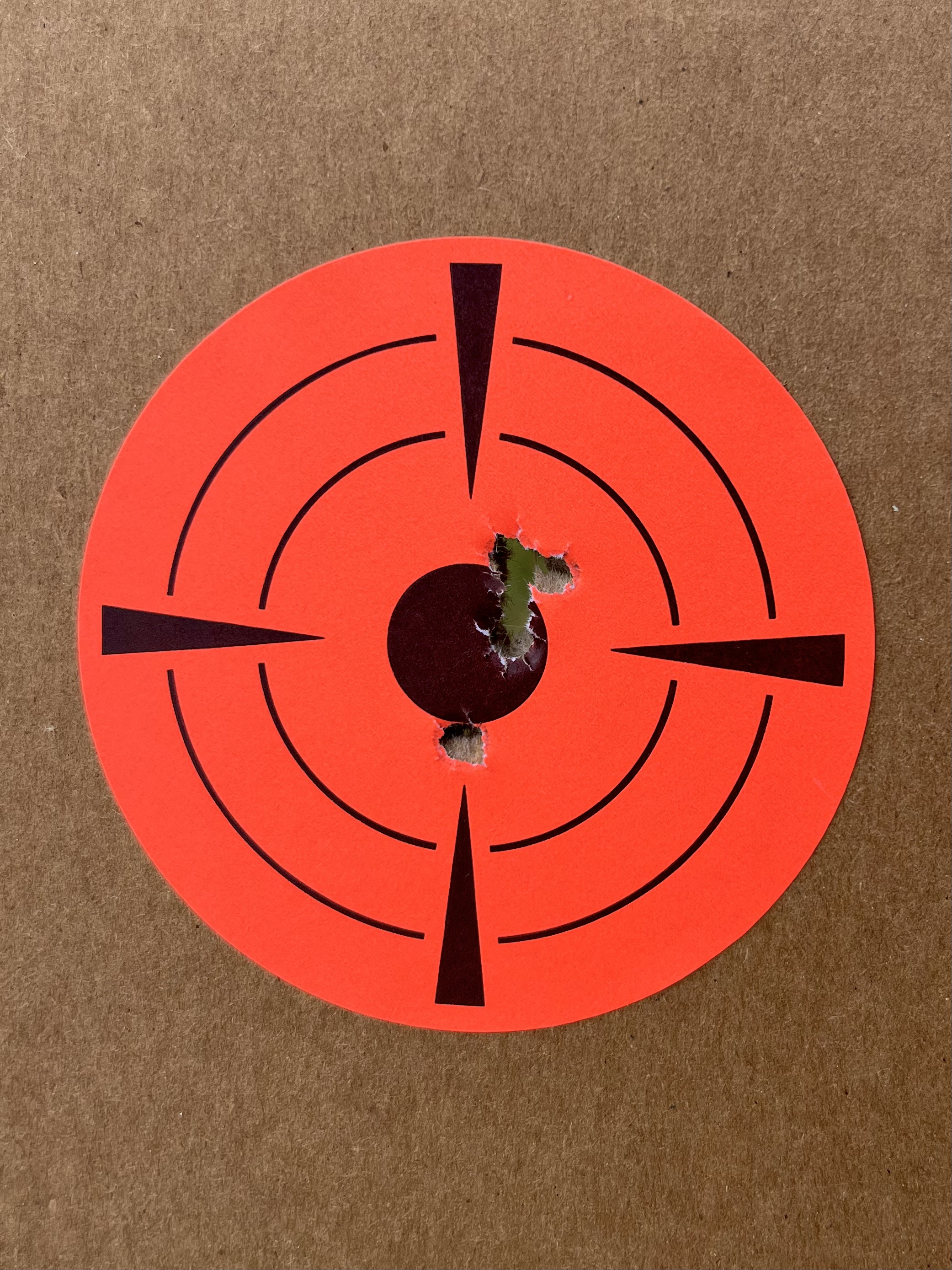

I received mine today from Midway. 22 caliber. Quickly went through it. Scoped it. After initially sighting in the scope, this was the five shot group at 20 yards. 14.3 CPHP. Dropped one. Fun little gun.

I did crony this 22 caliber today. CPHP 14.3. 535 fps was an average over approximately the first 15 shots. Then 517 fps was the next 15. One inch group is obtainable at 35 yards.

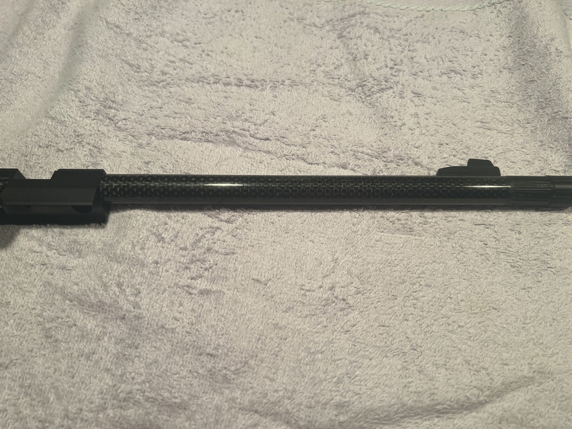

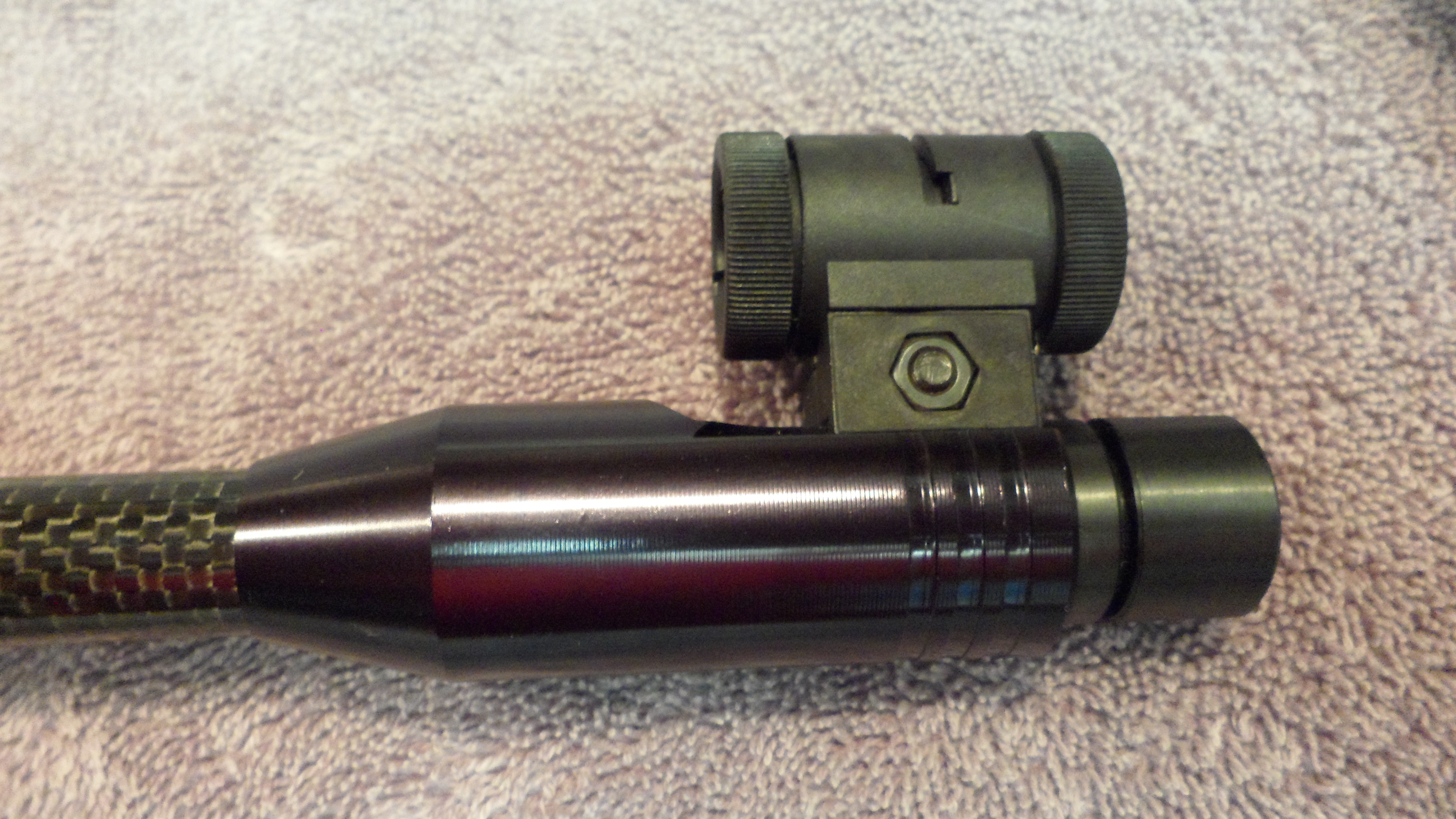

sure, i built 2 custom Chaser pistol a few years back and Air Venturi has a muzzle weight that has a way to mount a globe sight but the ID is 15mm
so i got 12mm ID x 15mm OD for the barrel i cut the barrel bands i had so the were flat on both side so the tubing would but up flat
now in your case you would need a barrel end finisher
i have made up 2 x.25 caliber pistol barrels that are covered and the 10mm-1.0 to 1/2-20 adapter holds the tubing in place
these are ideas nothing more but with the German barrel band you would have one the is perpendicular
now the silencer you have could work as the tube holder by using it as a nut but you will have to remove it from the factory barrel that take lots of heat a vice and soft jaws and luck
i hope that helps and again just ideas
