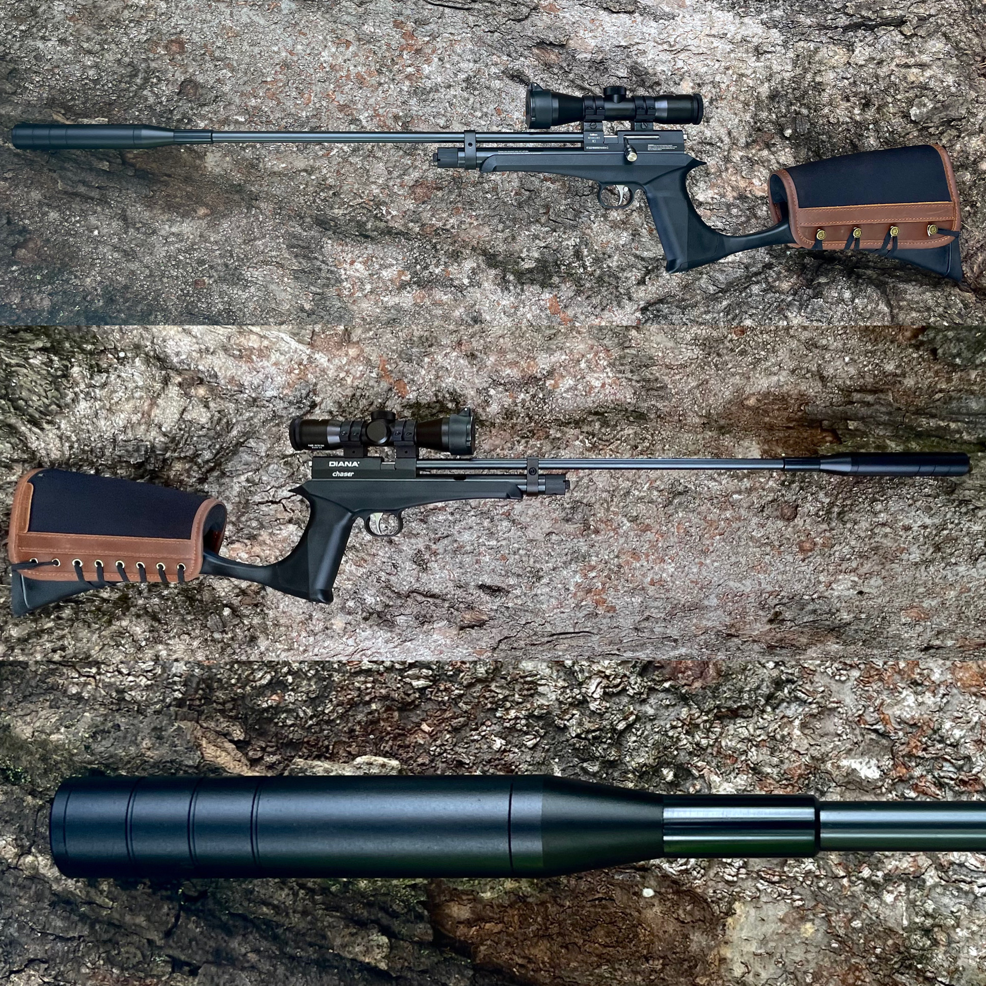

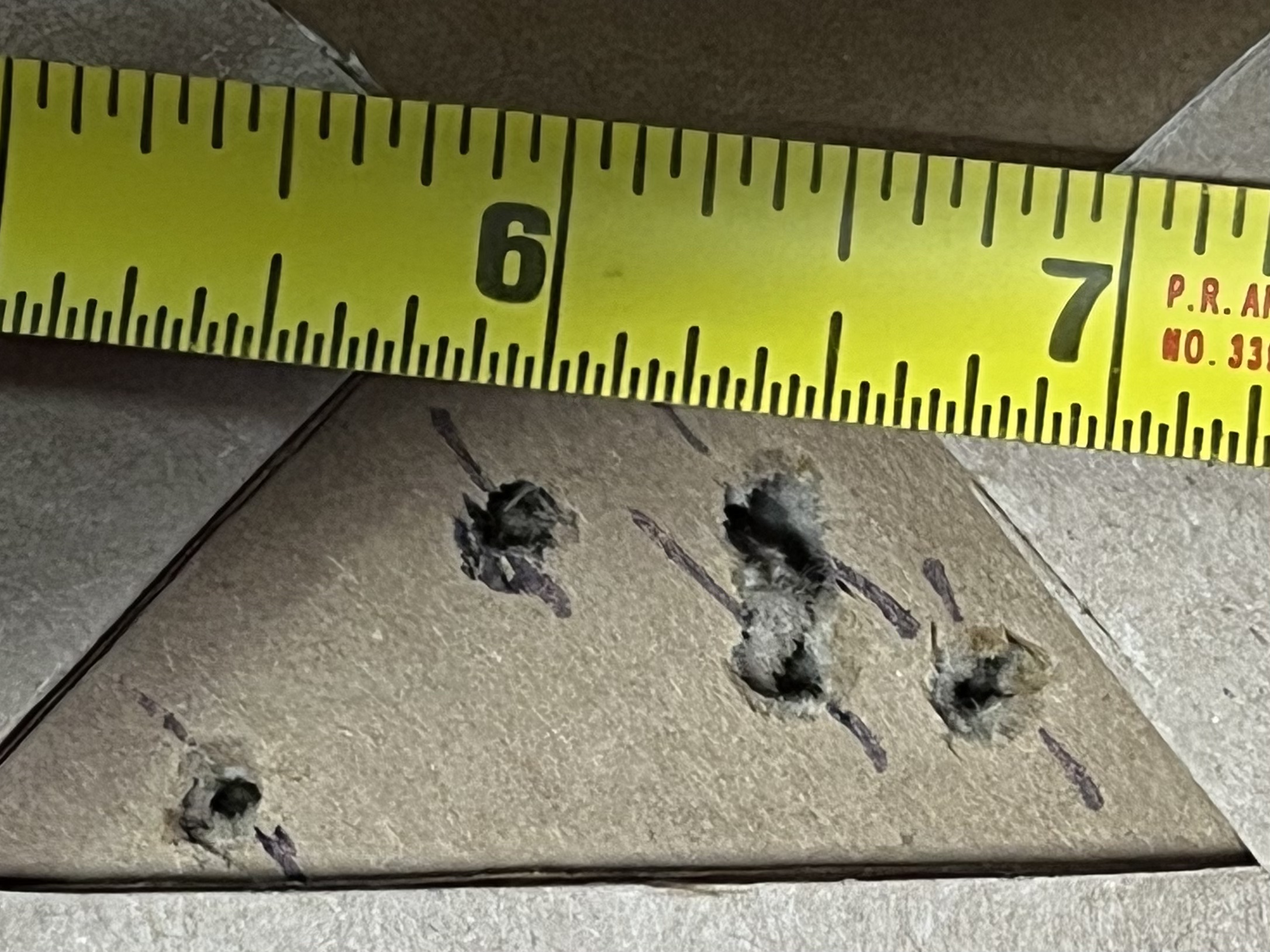

Picked up another 22 caliber to keep as a pistol. Went through it today. Trigger tune (under a pound), cleaning and lube. Mounted a (cheap) reflex dot. Removed the suppressor and mounted it to the pistol barrel. Totally silent. Trigger click only. At shot number 20, about halfway through the first CO2 cartridge, it chronographs at 440fps using 14.3 grain CPHP’s. This is the following 5 shot group after the chronograph at 35 yards and it measures 1 3/8” with five and 7/8” with four off a tripod. Really good shooter. May try it tomorrow with the shoulder stock.
Picked up another 22 caliber to keep as a pistol. Went through it today. Trigger tune (under a pound), cleaning and lube. Mounted a (cheap) reflex dot. Removed the suppressor and mounted it to the pistol barrel. Totally silent. Trigger click only. At shot number 20, about halfway through the first CO2 cartridge, it chronographs at 440fps using 14.3 grain CPHP’s. This is the following 5 shot group after the chronograph at 35 yards and it measures 1 3/8” with five and 7/8” with four off a tripod. Really good shooter. May try it tomorrow with the shoulder stock. View attachment 481324

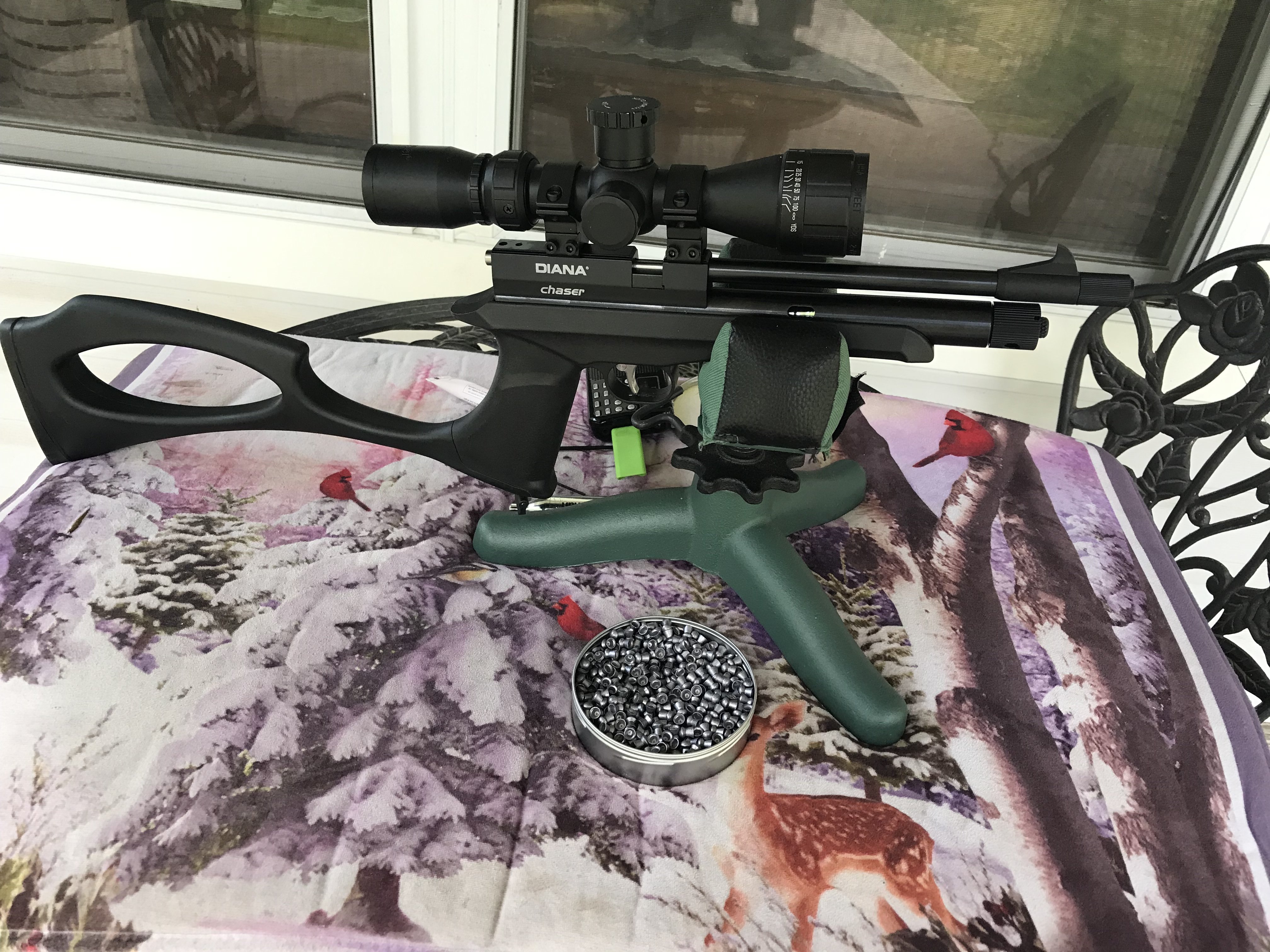

This platform can be very addicting! I have a Chaser rifle/pistol combo, an Airbug, and an Artemis CP2. Why? I'm really not sure... Just enjoy tinkering with and shooting the things. All are .22 cal. Latest acquisition is a "Bandit" barrel only (about an inch longer), that I got from our friend Wes (Canada). Gonna put that on the Airbug and see if I get any more velocity out of it due to the slightly longer length. That longer barrel length created a problem--- the case I had for the Airbug is now too short. Had to get another (longer) case for transport to the range. It's always SOMETHING! Not sure what to expect, but will be fun to chrono and find out. I wouldn't be too upset if the Bandit barrel swap shot more accurately as well. We shall see. So much to test, so little time...

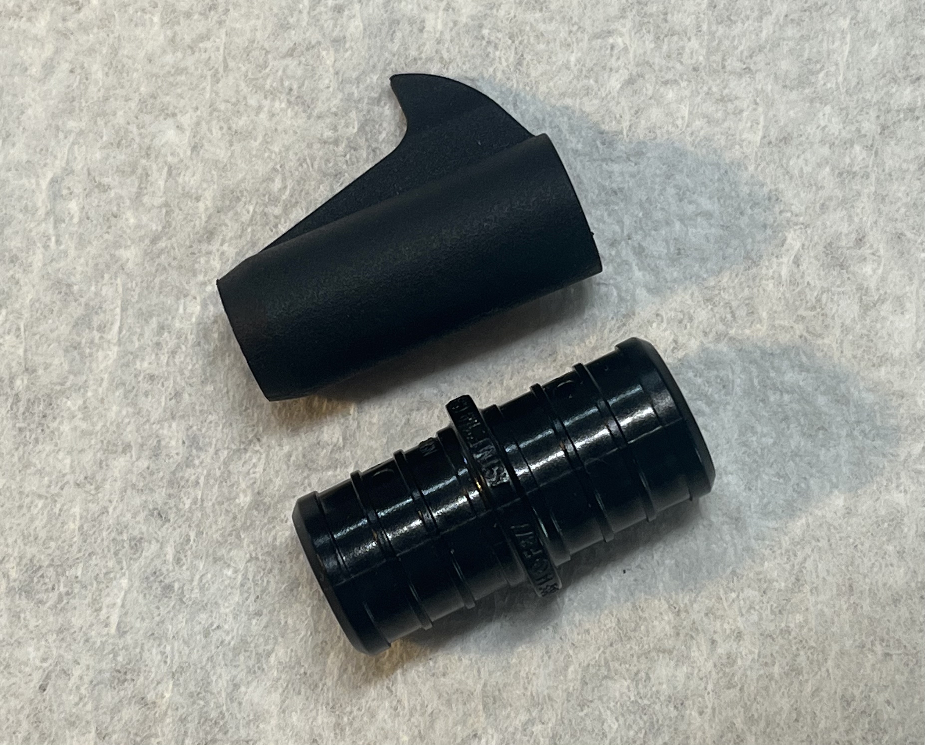

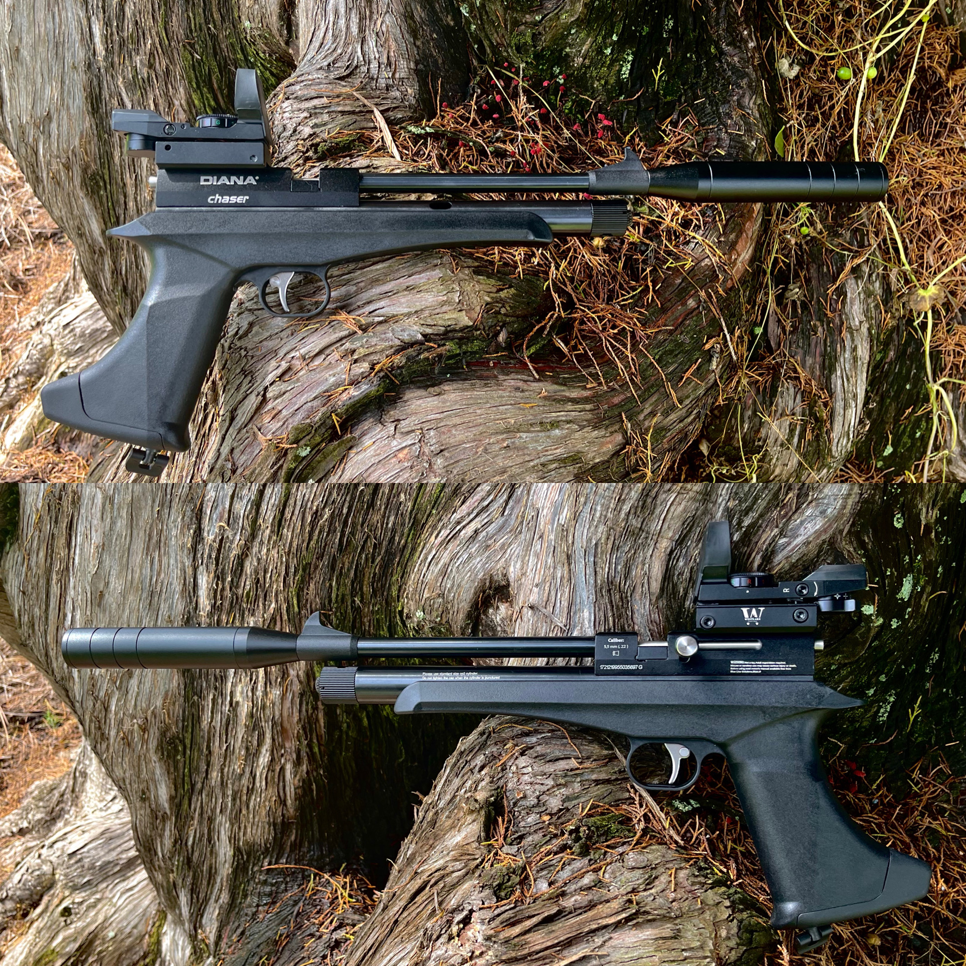

with two pieces of carbon tubing and the band, you could get rid of the front sight, they just tap off with and block off wood and a hammer
Thanks for the idea. Barrel bands finally got here. Shipped from Germany. Made the front sight replacement shroud from a .89 plumbing fixture. Did the pistol and rifle both. Looks cleaner without the sights to me.
