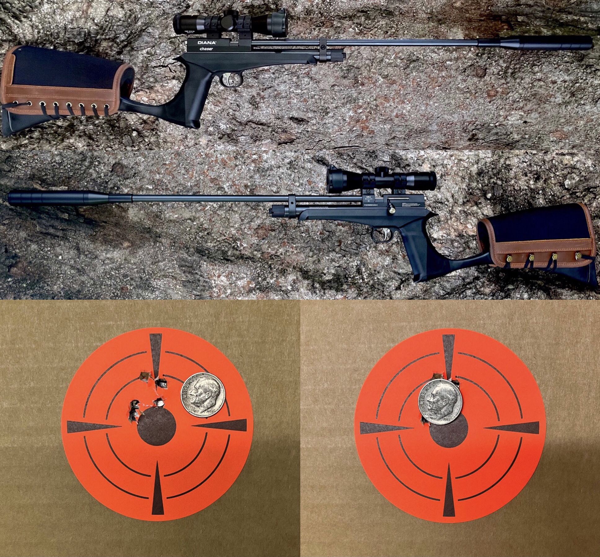

@Robin AThank you. Amazon. $32.50 It comes in all black also. Adjustable heights. Nicely made. I also use it on my lever actions. View attachment 479738
Upvote 0

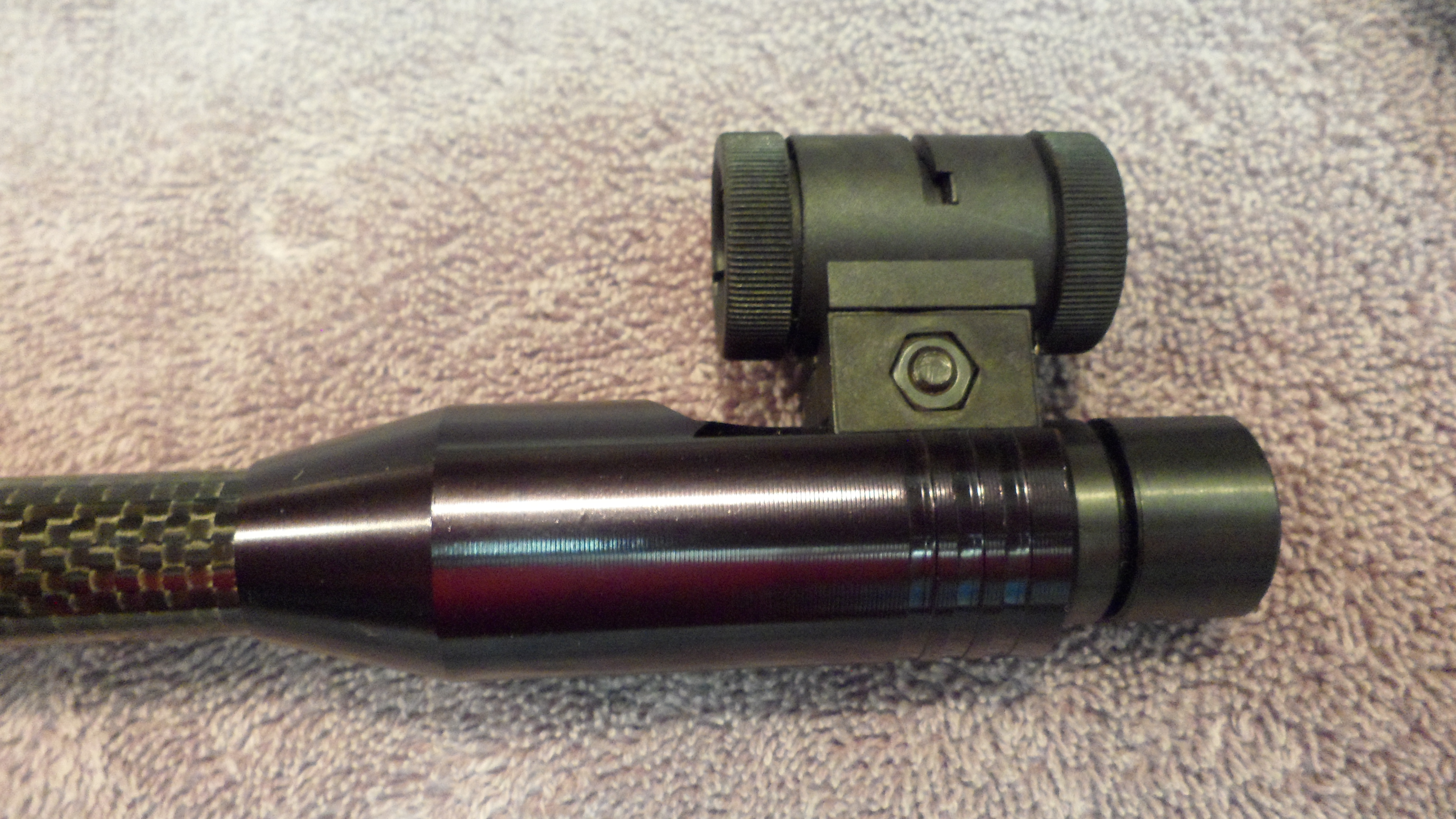

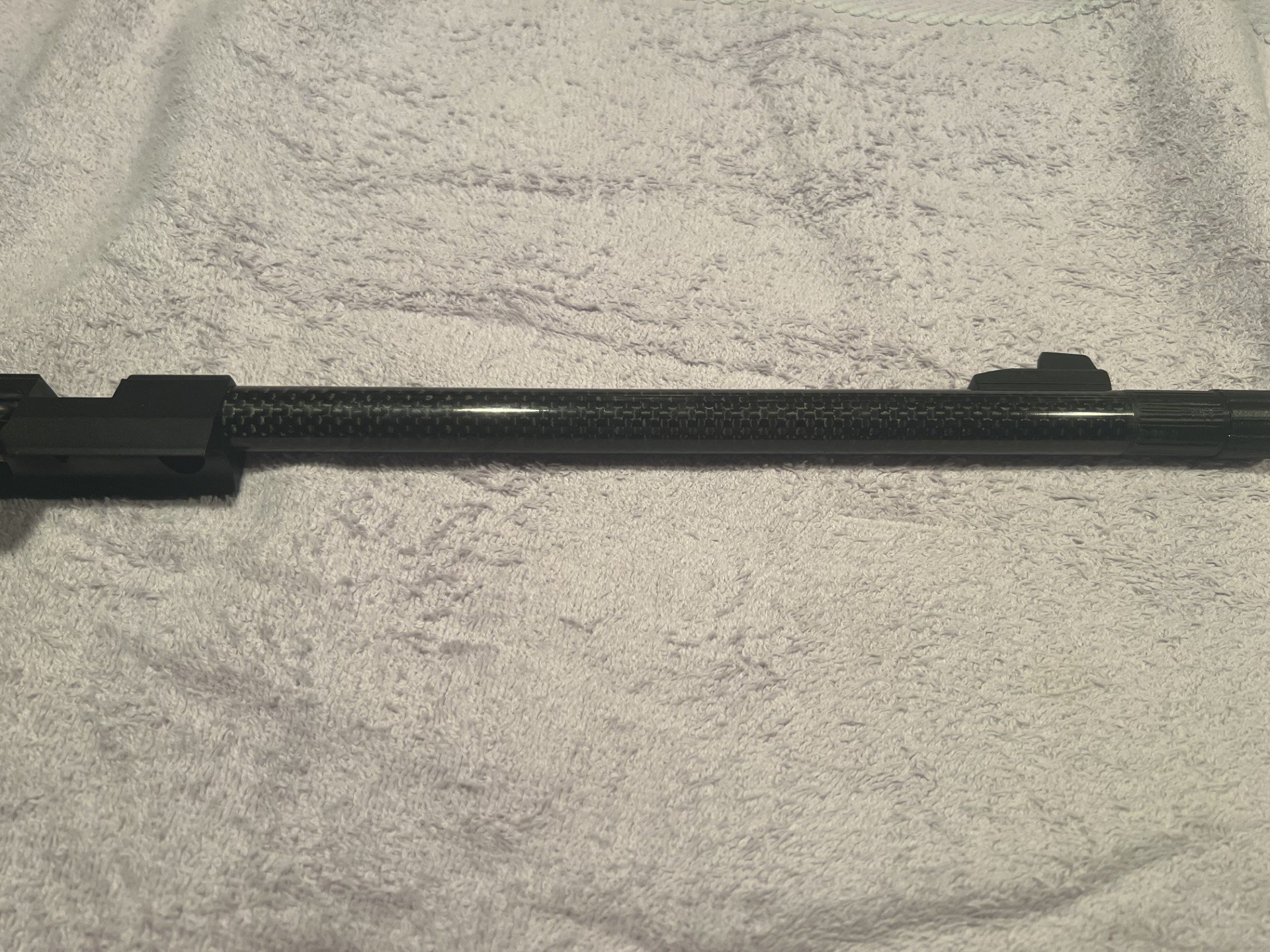

Love that carbon fiber barrel!sure, i built 2 custom Chaser pistol a few years back and Air Venturi has a muzzle weight that has a way to mount a globe sight but the ID is 15mm
so i got 12mm ID x 15mm OD for the barrel i cut the barrel bands i had so the were flat on both side so the tubing would but up flat
now in your case you would need a barrel end finisher
i have made up 2 x.25 caliber pistol barrels that are covered and the 10mm-1.0 to 1/2-20 adapter holds the tubing in place
these are ideas nothing more but with the German barrel band you would have one the is perpendicular
now the silencer you have could work as the tube holder by using it as a nut but you will have to remove it from the factory barrel that take lots of heat a vice and soft jaws and luck
i hope that helps and again just ideas
