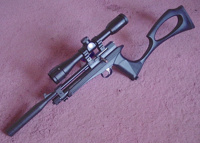

Diana Chaser Suppressor
Fellas, anyone that owns a Diana Chaser rifle kit. You can take off the suppressor from the rifle barrel 2 ways. 1st way, take a heat gun or hair dryer heat up where it mounts to the barrel as it has red locktite, why it does not need it and then with a rag unscrew it. 2nd way boil up a pot of hot water, dip in the suppressor for about a minute then unscrew it with a rag (hot), now you have a suppressor for both the rifle kit or for just the pistol and you can also use the barrel band on the pistol.

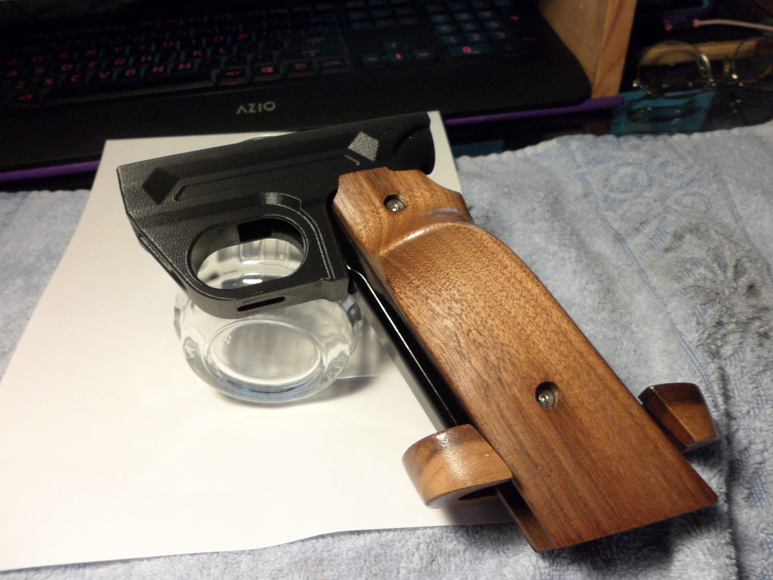

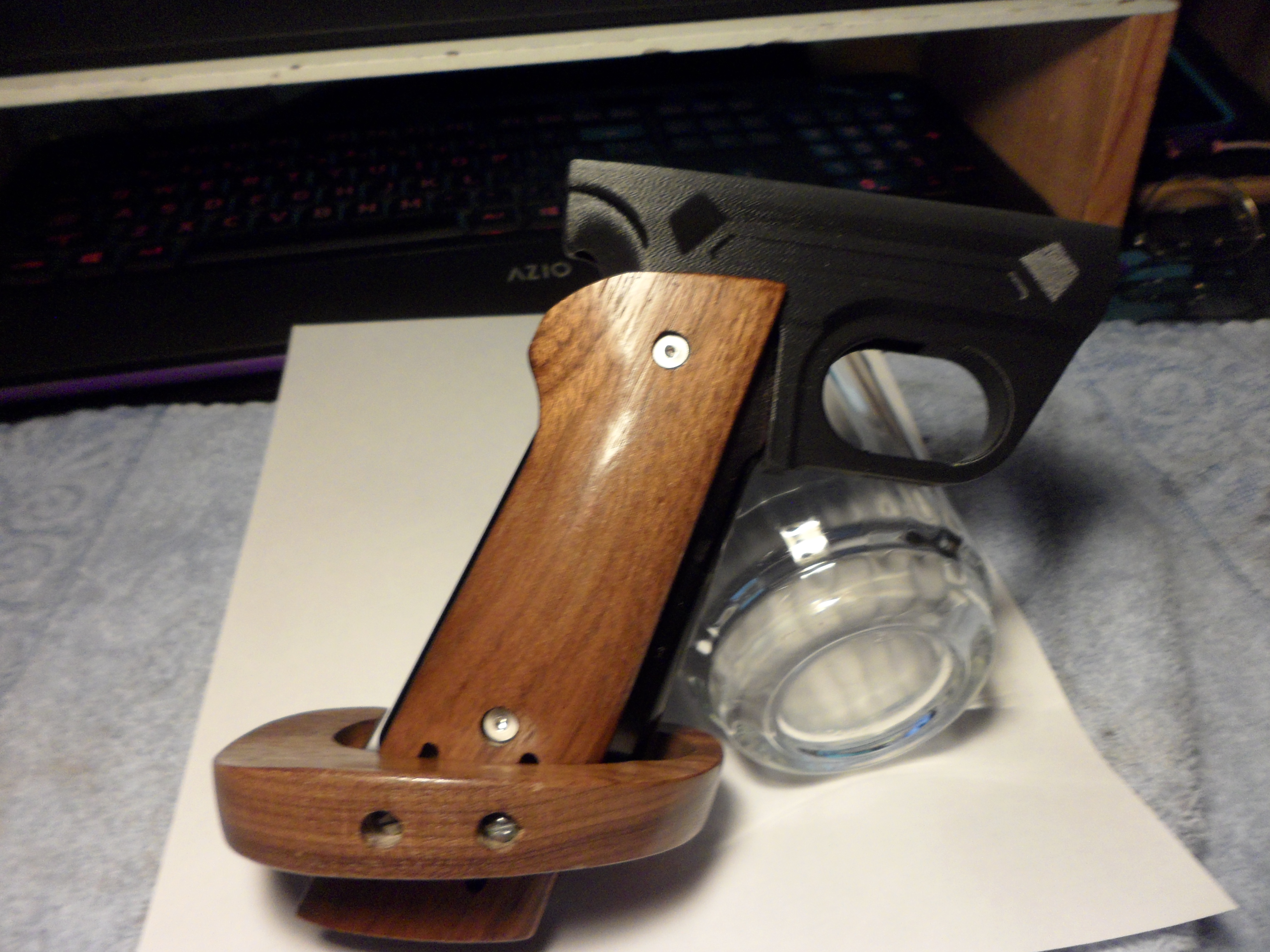

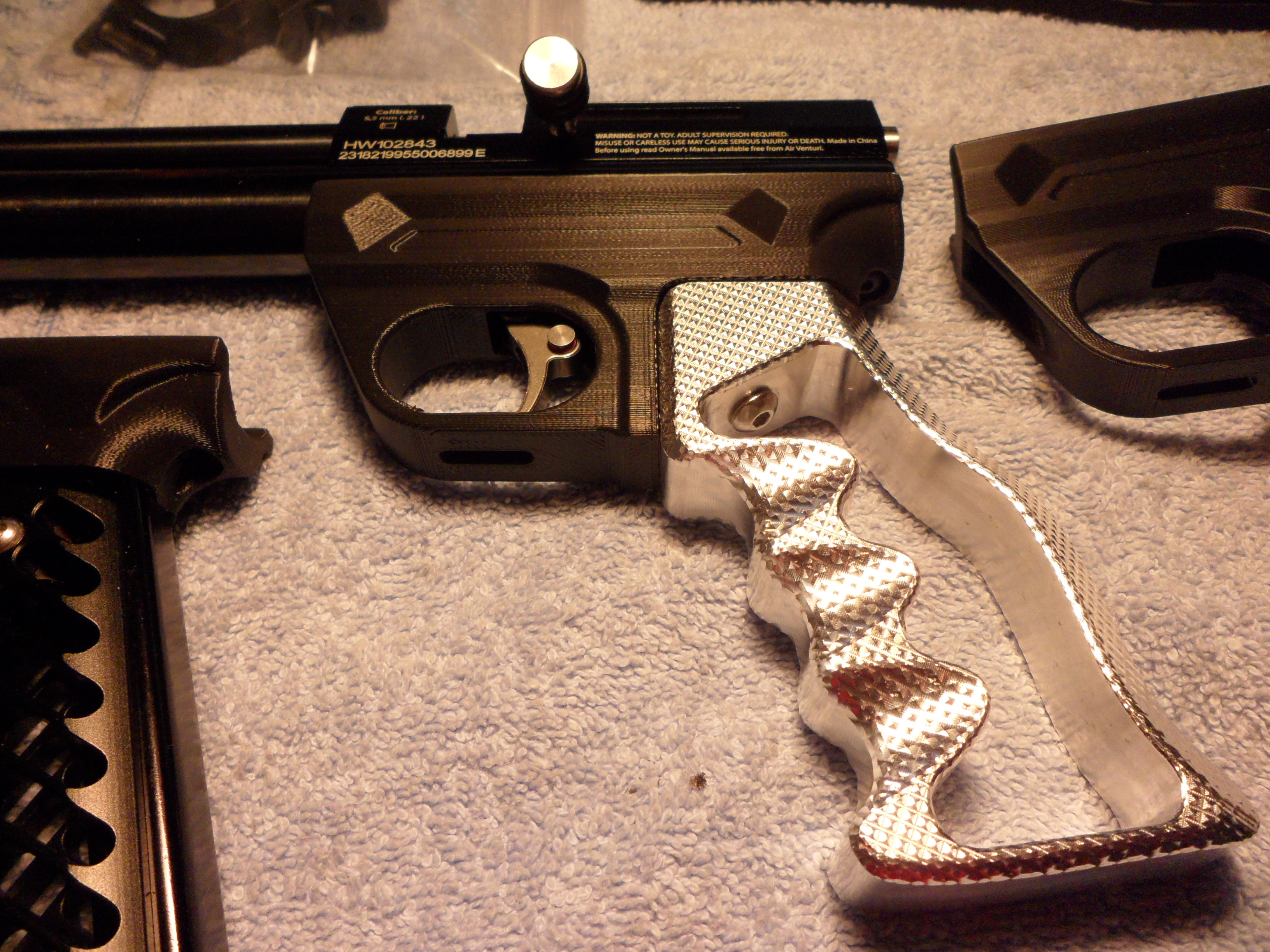

for those who haven't seen the 3-D printed frames at Buck Rail take a look
now here is something stupid you can do BR frame, 1911 adapter and a set of Herrett grips price tag stupid
just they just for fun
