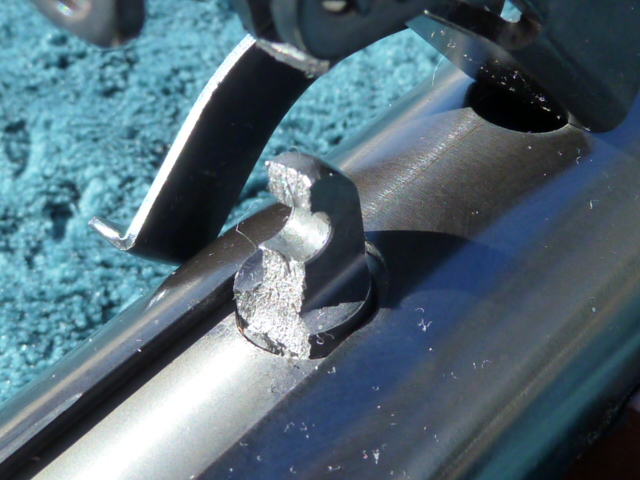

I bought one of those Numrich Arms sale K98s (0.177 caliber). Really like the looks of it (well, except for what appears to be a plastic trigger guard and fore-end band). Shot well too, until it suffered major failure at less than 100 rounds that is...
The "hinge pin" (connects cocking arm to the compression tube) fractured. Result: cannot cock gun and wood stock split for about 4" length at the under-lever slot. The part appears totally inadequate to handle all the force applied to it when cocking the gun, so I don't have a lot of confidence a (Warranty I hope) repair will last.
One other issue with my K98 is how insecure the cocking arm latch is. A fairly minimal 'bump' (like placing the gun's fore-end down a bit too hard onto a bag on the bench) will often release the lever to drop down. I also found the lever sometimes dropped down at the shot (just like the loading lever was prone to do on certain old black-powder/percussion revolvers).
Disappointed in these issues, as otherwise the gun seems real nice, though I think I'd prefer a 'de-tuned' version(maybe 700 fps in 0.177) as I don't see a need for "Magnum" power in a gun like this.
